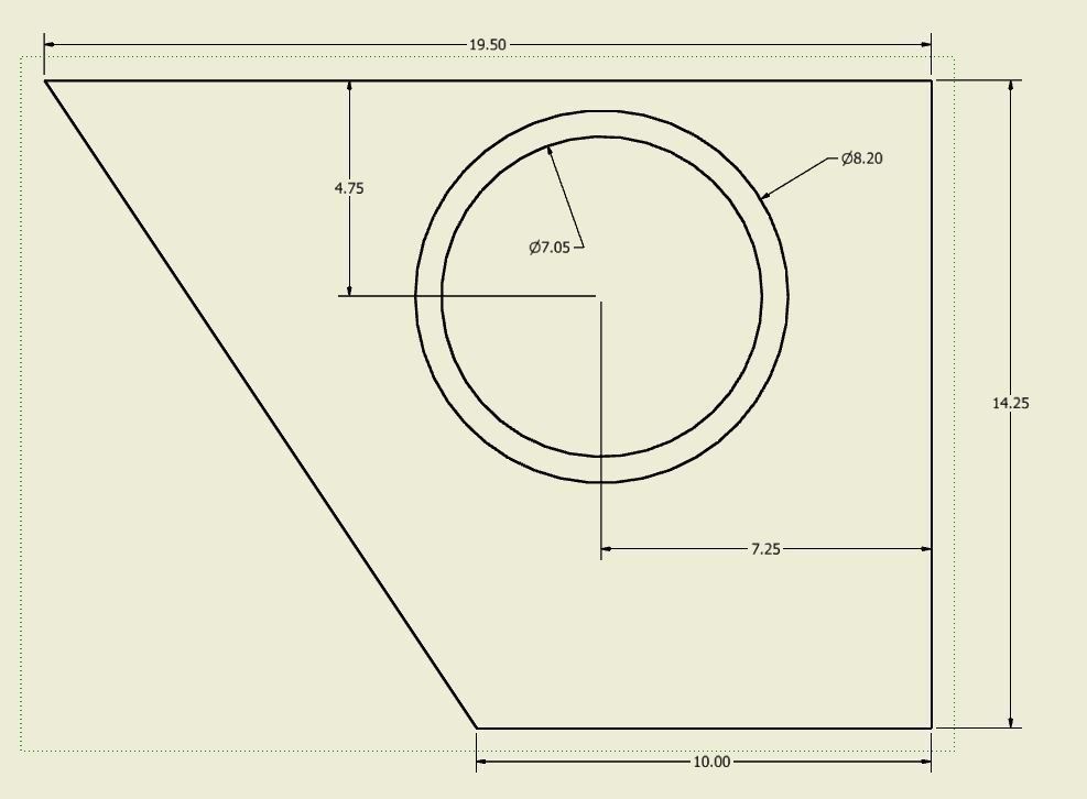

Hopped in Inventor and designed a box based on my core measurements...
Determined after some trial and error these are the numbers you want to hit...
This box design yields just under .33 cu feet. Used some of that foam board and started building it up...

So this was advertised as 2.5" deep, which would have been great, but you'll notice on the spec sheet it is 2.91, which was a problem for me, the sub stuck out about .0625 from the back plane of the box so the back had to be notched...
Also, knowing that the box had to be flush to the back of the panel, this had to be recessed in the box .1875. Don't have a pic, but here is a rendering...
So now that I took a good chuck out of the face, I backed it up with a ring for better attachment...
