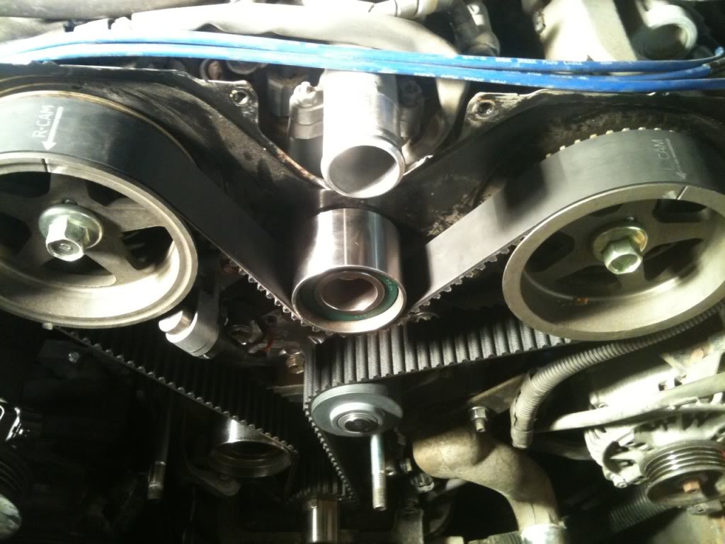

hross14--thanks for the advice. I did finally get everything lined up perfectly as seen here. I got everything back together and fired'er up. So far so good and I've probably driven 50 miles since then.
You were right...I tried to make it more complicated then it was...I had a hard time getting the top idler pulley lined up but finally did and torqued to 30 ft. lbs...had a hard time with the cams but I adjusted those and got the marks dead nuts.... etc. etc. There were a lot of things that were much harder than they looked or that I anticipated but i'm thankful I've got it all back in working order. She should be good to go for awhile...much cheaper than having the dealership do it!
