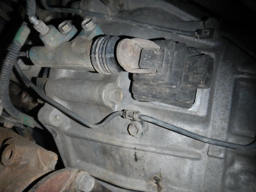

3. Couple months ago I was under and noticed the slave cylinder never quite releases pressure all the way. Is this normal on these? I would think that would keep the clutch from engaging entirely and eventually cause wear (though I haven't noticed it slipping.) Should I mess with that at all?

I don't know about your slave. I would have to see a picture

Here's the best picture of the slave cylinder that I was able to get. You can see its mounted by those two bolts on top of the bracket but there is no way to adjust it forward or back. Right now its light enough pressure that I can press the fork bracket back by hand, but regardless how little, there is constant pressure on that fork.

Toyota rebuilt the transmission in my 97 taco twice at 20k miles due to a noise I thought was throw out bearing. Got it back after 3 loaner cars and 42 days. Still had that same noise.
I would replace the clutch, t/o bearing and do a new slave cylinder. 125k is pretty good.. Have you bleed the slave cylinder? The thing looks the same as the one on my 81.

Yeah I'd guess its the same slave as original but I'm not positive of that. The previous owner basically took it to the dealer and said "fix whatever needs fixin" every couple of months so unless their voodoo magic book told 'em to change something out I doubt they did.
More to the point, no I haven't bled it out. They're only like forty bucks so maybe I'll just swap it out during this whole process. Why would bleeding it change the amount of pressure its applying though?
