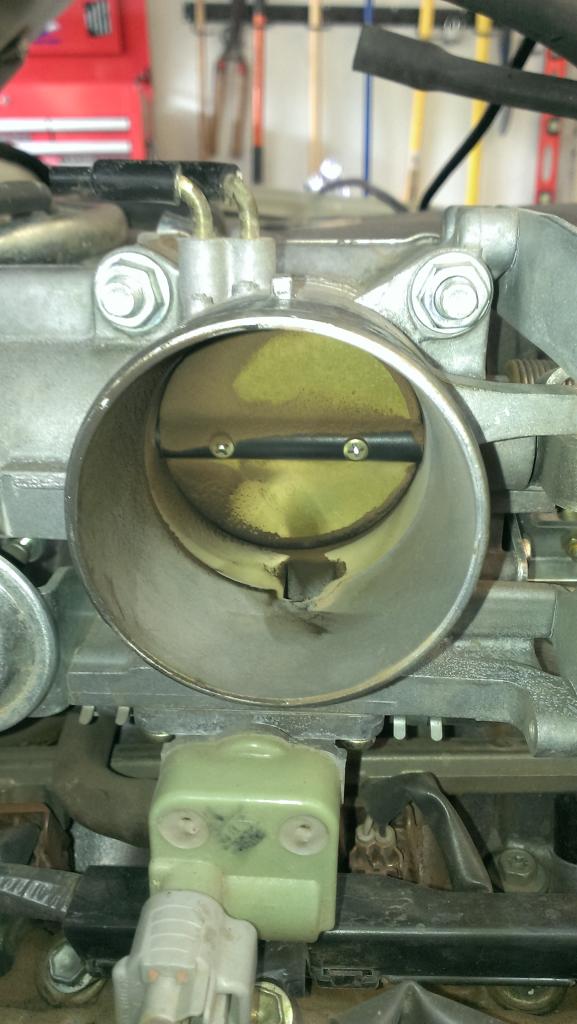

Start off with a basic tune up. Remove the throttle body and clean it, the back side will have buildup in it. And clean the IAC valve also.

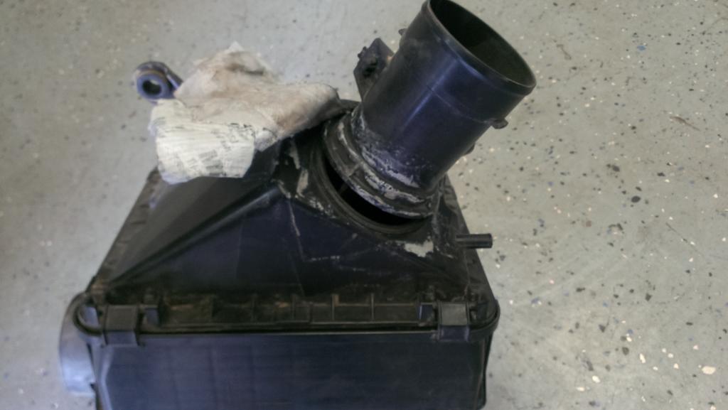

Another update:
After a long weekend in the garage building dueling trees for some customers and then cleaning it all up. I was able to poke around the engine. I'm adding to the list replace ALL vacuum lines (That I can). Many of them are cracked at the connection point so I can only assume that's not helping.
I found that the air intake box was completely separated at the box just in front of the MAF sensor and being held on by duct tape (not what you would call the best seal possible. So no air was was/is going into the air intake in front of the sensor, but not filtered. I can only assume that the sensor is massively dirty because of this. I was able to tape it back together for now and took it for a drive, there was a massive improvement in throttle response and power in the low end. However, it's still missing and gets bogged down.
The engine has a little back fire every now and then when I'm parked and in neutral still.
Instead of going with a factory cold air box (that's kind of what's in there now) I ordered up an S&B "Cold Air Intake" and I'm going to replace the filter with an AFE Pro S dry flow cone when I get it. The factory replacement would have been about $180 shipped this was $200...I know I'm not gaining much if anything with a CAI, but it will clean up the appearance of the engine bay a bit and I needed something anyways.

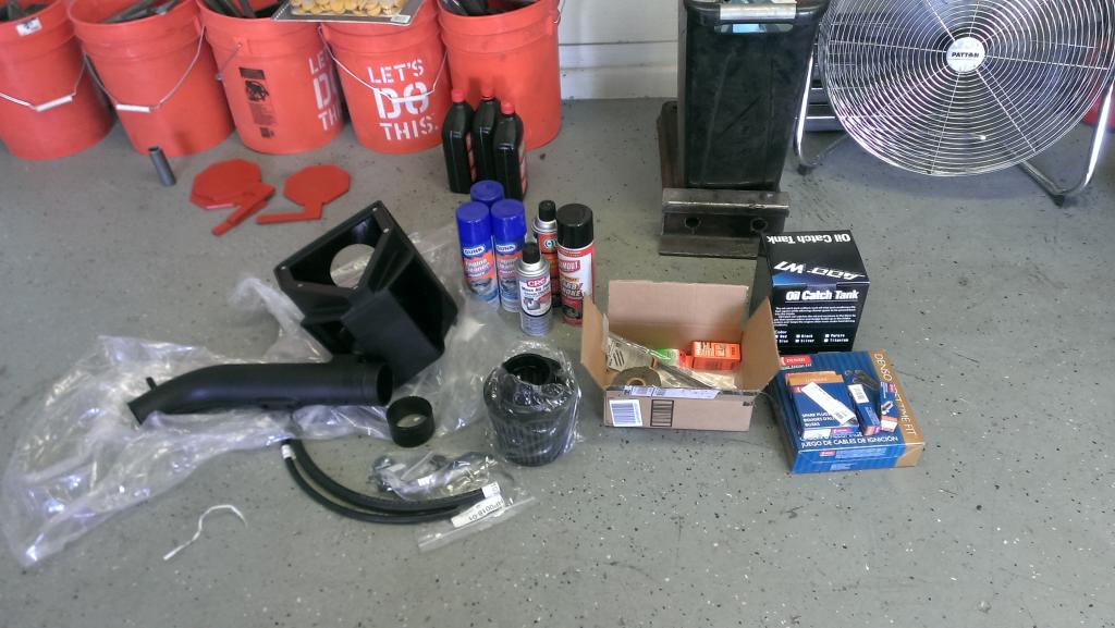

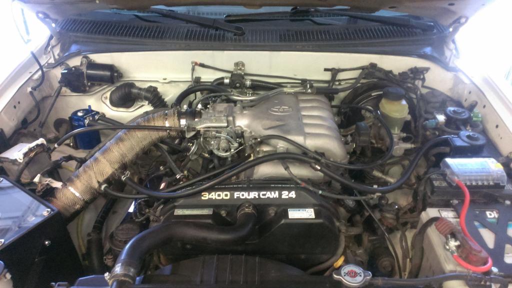

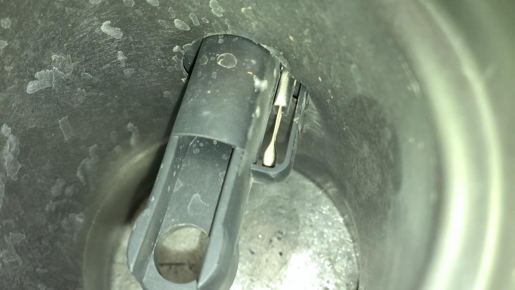

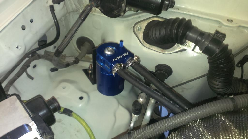

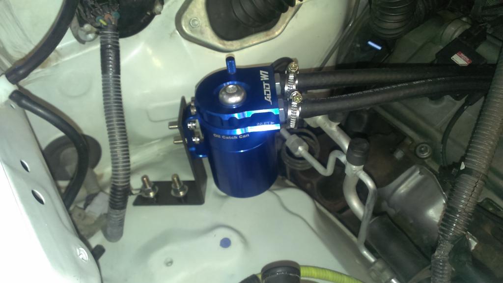

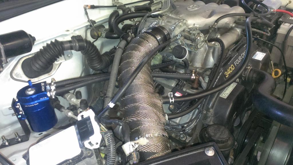

Did some seriously needed maintenance this weekend and threw in a couple new parts.
New S&B air intake (POS, never buy one, its crap). I'm going to look at replacing it in the near future, but I had to have something since you can see my factory air box was toast.
AEM dry flow filter on it.
ADD W1 oil catch can.
New plugs and wires (the original plugs were still in this thing at 188K :eek
Did a little exhaust wrap on the Air intake tube...not sure if that is going to help any, but it makes me feel all warm and fuzzy inside.

All cleaned up and put back together.
