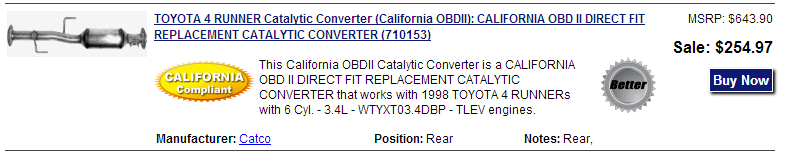

It's Federal 50-state EXHAUST emissions. The Cali. standards in '96 were only different for EVAPORATIVE emissions. Post a pic of your sticker and I'll prove it. I just checked again, there was no Cali. spec exhaust in 1996.
On the other hand, I'm finding conflicting info on the OP's 1998 engine family (WTYXT03.4DBP). It LOOKS like that is a two-cat Cali'Spec version that did NOT use an Air/Fuel sensor in front and was Cali legal to the TLEV standard used in 1998. Up to now, I thought all two-cat systems used the A/F and the A/F definitely started in '99. I was unaware of this '98 Cali. spec version.
But this appears to be what his engine family requires:

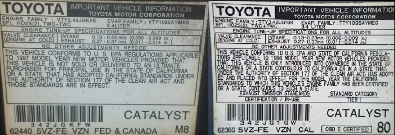

Oh, and here's a comparison from a 97 Fed truck and my 96, if that makes any difference:

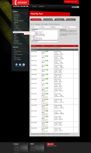

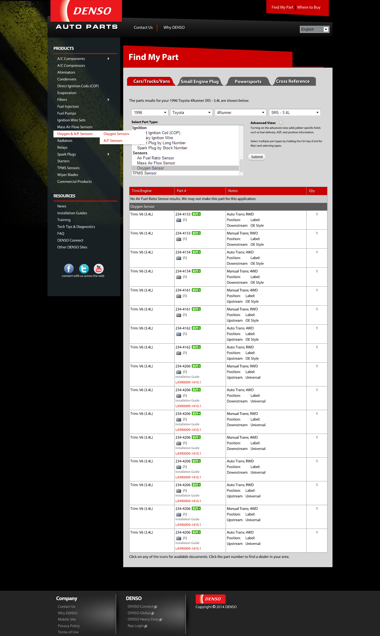

Well, as far as sensors go, there were no air/fuel sensors before the 1999 CA spec systems. There are only O2 sensors, front and back. In 1996, there are no sensors listed as CA-spec. Here is the 1996 listing from Denso, the people who make them--see for yourself--no Cali spec., no A/F's:
1998 4runner 3.4: emissions sticker drama-w1ty18g.png
Note that the 234-4206 Universal sensor works in all positions on all models.

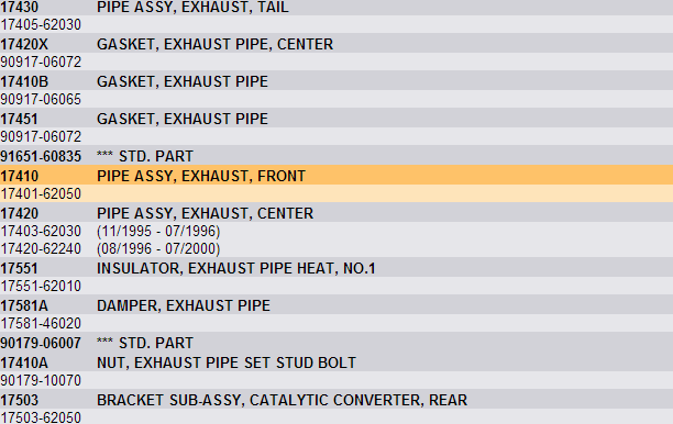

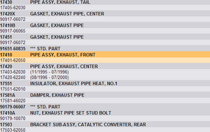

It's the same thing for Cats and the rest of the exhaust--the only part number for cats that comes up on toyodiy.com is 17401-62050. No separate listing for CA spec.
1998 4runner 3.4: emissions sticker drama-tiaptnq.png
