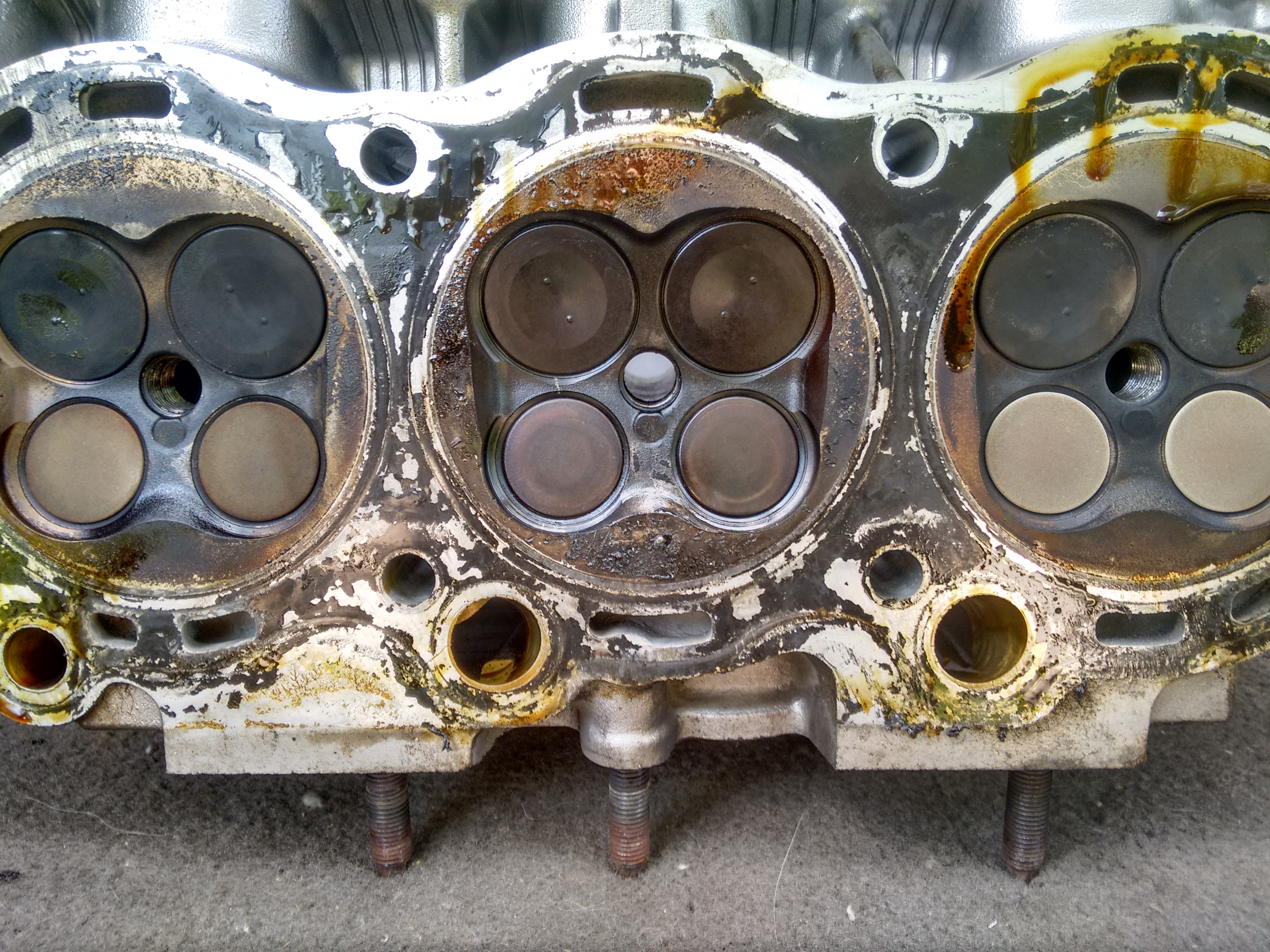

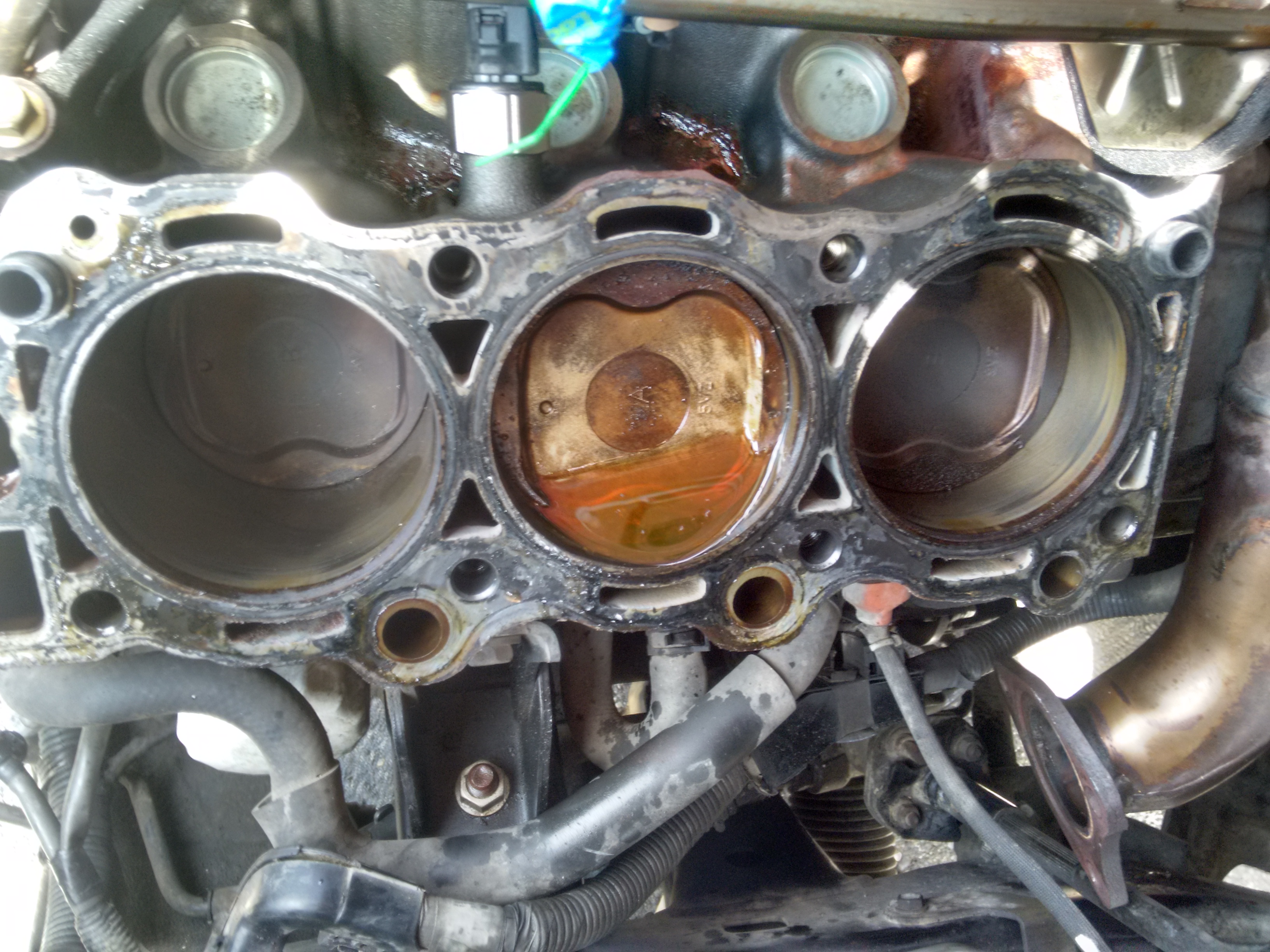

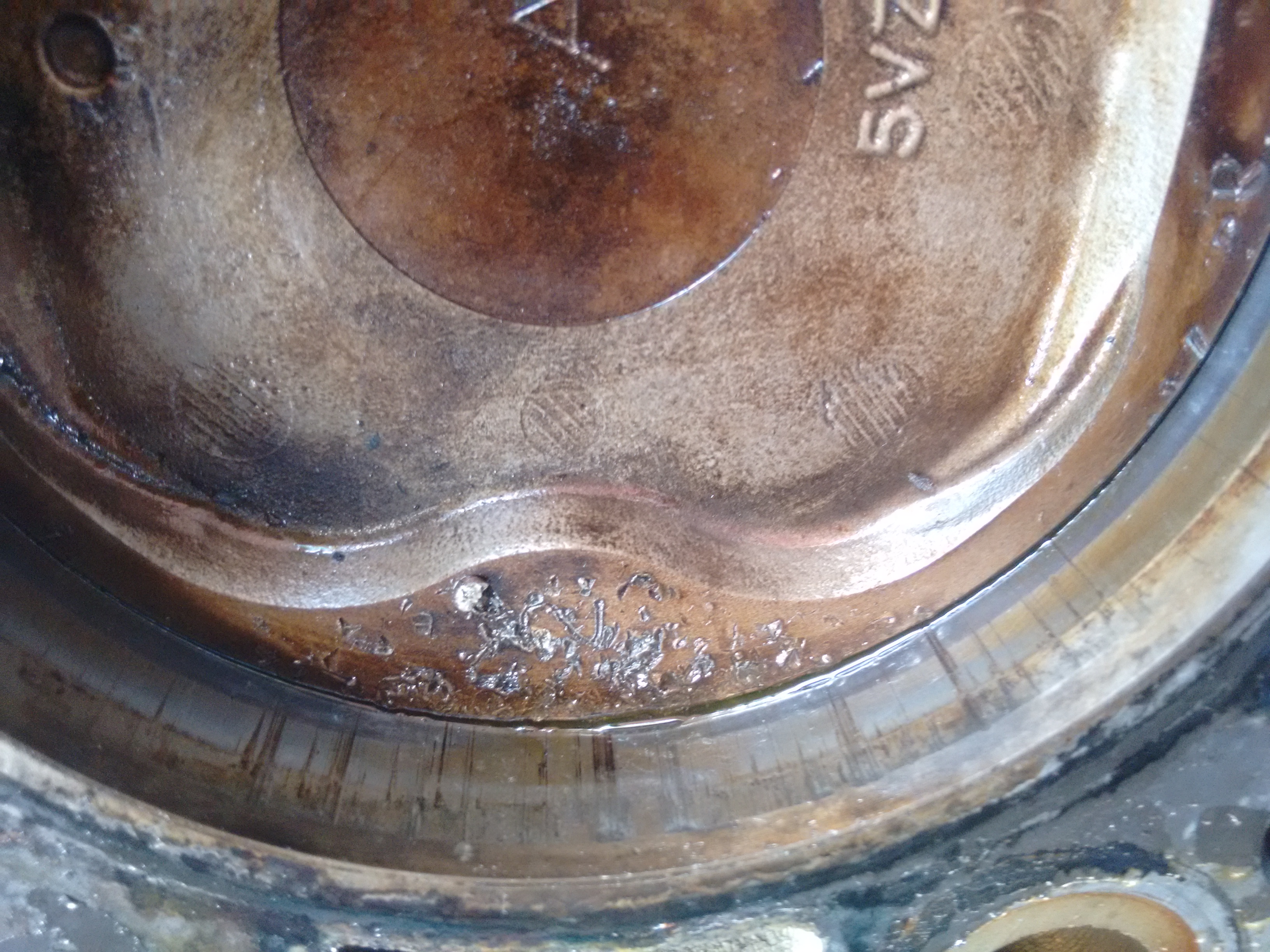

2002, 150k, bought in Feb. It's had a HC in coolant issue since I bought it, slight burning of coolant, no coolant in oil, very manageable until just recently. It has overheated twice when left running in park, but no noticeable changes after overheating, and that was months ago. After sitting for 2 weeks it started up and was billowing white smoke so i tore into it and found a cracked head, and what looks like loose foreign body damage to the top of piston #4 and some scratches along the cylinder.

can a machine shop fix a piston with scratches that deep? seems doubtful. the cylinders will need work too, maybe more than a honing, how much can they take off? i've never cracked an engine open before and was not prepared for this level of damage. I had a plan for a cracked head, but these scratches threw me for a loop.

The only way to tell about the other engine is to see how much it takes to clean the cylinders up.
In the scope of things pistons are not all that expensive .
If one needs to be machined to clean things up they all do
Do it right bore the cylinders new pistons
Then you will see what the bearings look like it there was antifreeze in the oil hope the crank is not scored as well beyond turning .
That is the thing with engines until every thing is apart and inspected you have no clue what you have.
