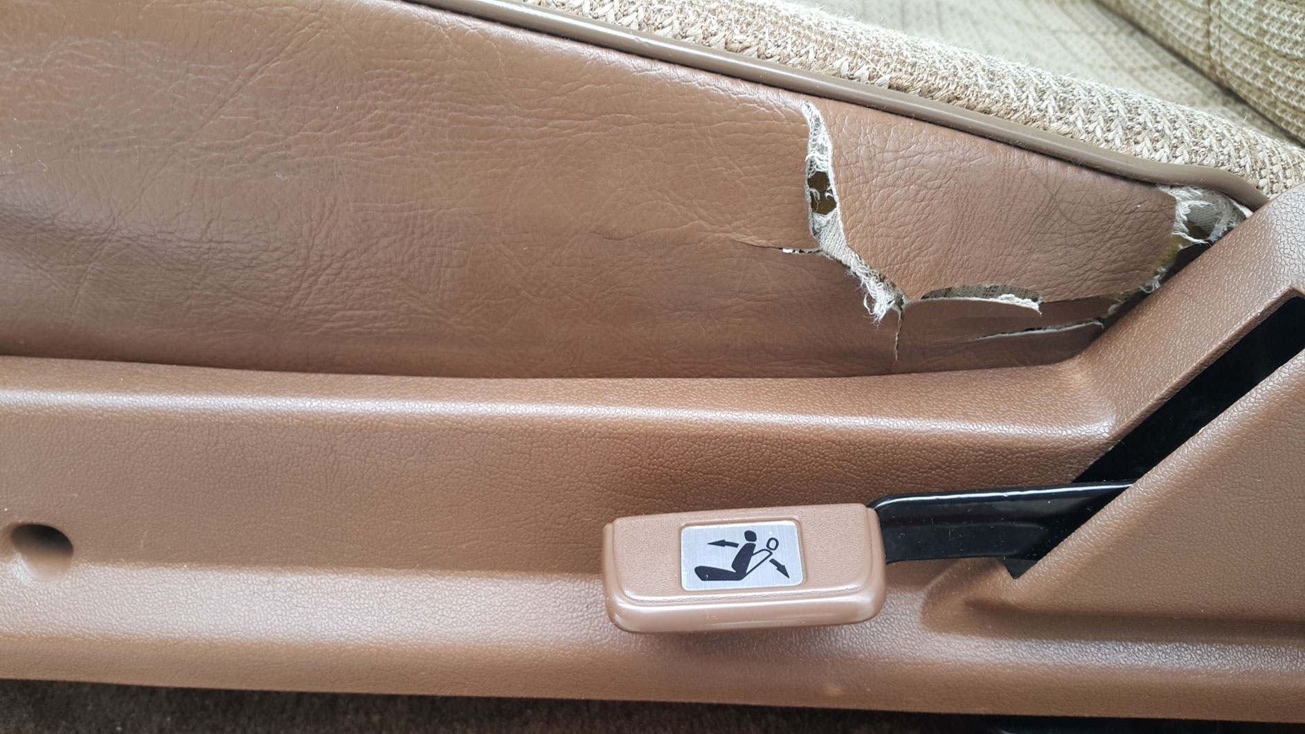

Fix interior seat rip/replace mats

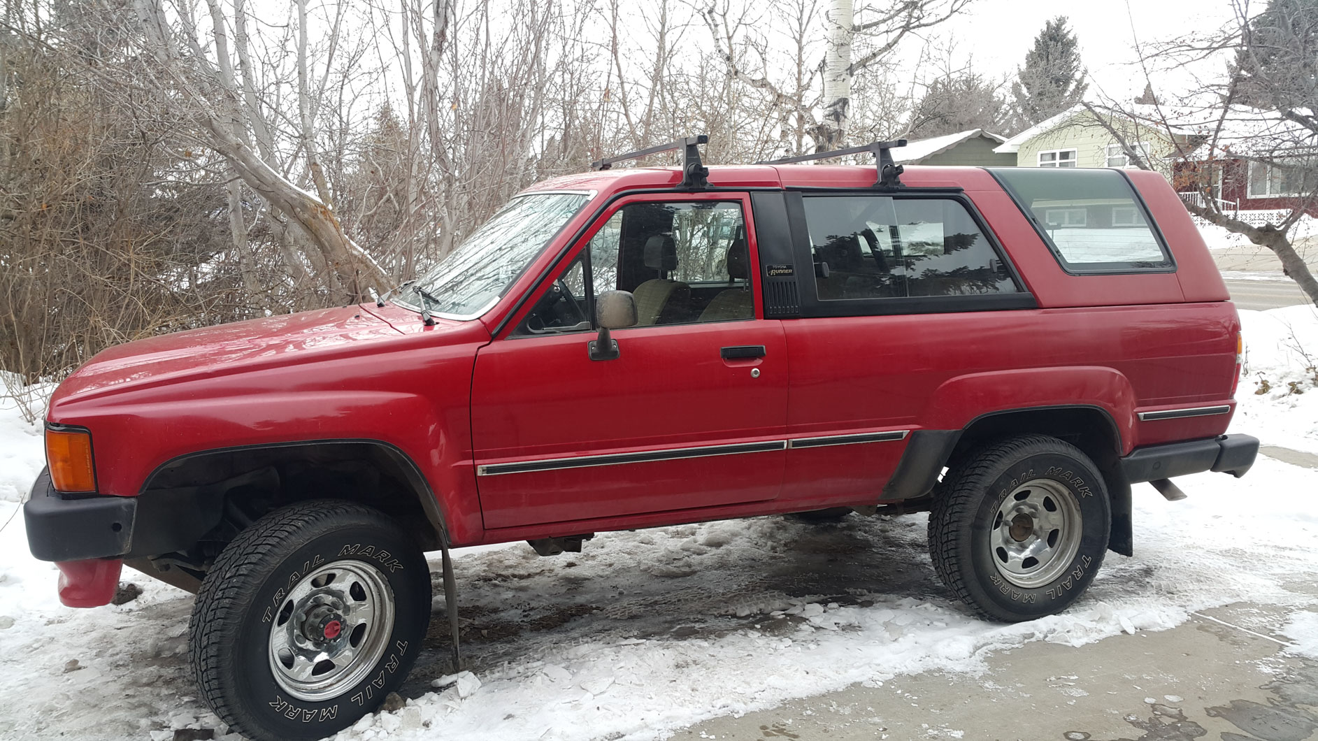

I would restore it if it was me. Finding an original truck is the rarest out there. I have seen a couple things on websites saying these trucks could possibly be worth something someday. Most I have seen are just ragged out and ran into the ground. Plenty of other trucks out there that are not original.
I would have the tailgate fixed but would try to leave the rest of the paint alone. From the little bit I see of your grill and your rims, I am thinking you have an 85 model which is rarer yet. I would not even do some of the SR5 upgrades like the cluster gauge or anything like that. I would want it as close as it came from the factory that it came with. Of the hundreds of builds on here, how many are original?
My 85 is a rare truck and sure some would scream when I stick 87 stripes on it but there really isn't much on it that is original to it so I don't feel bad about doing the color change and stripes and some of the other things I have done to it as it was headed for the scrap heap when I got it. If I had come in the condition this way and it was from the factory, no way would I have changed anything on it.
Great looking find you have. If it has a solid axle, I am betting you have an 85. Your grill looks like it has the two vertical bars in it instead of the single one down the middle. The two bar grill is for 85 and 86, the newer ones have the single bar. Your rims are on the solid axle trucks. The SR5 rims on the IFS are an aluminum rim and they will not fit on a solid axle truck. I am sure the chrome rim you have would interchange with an IFS truck.

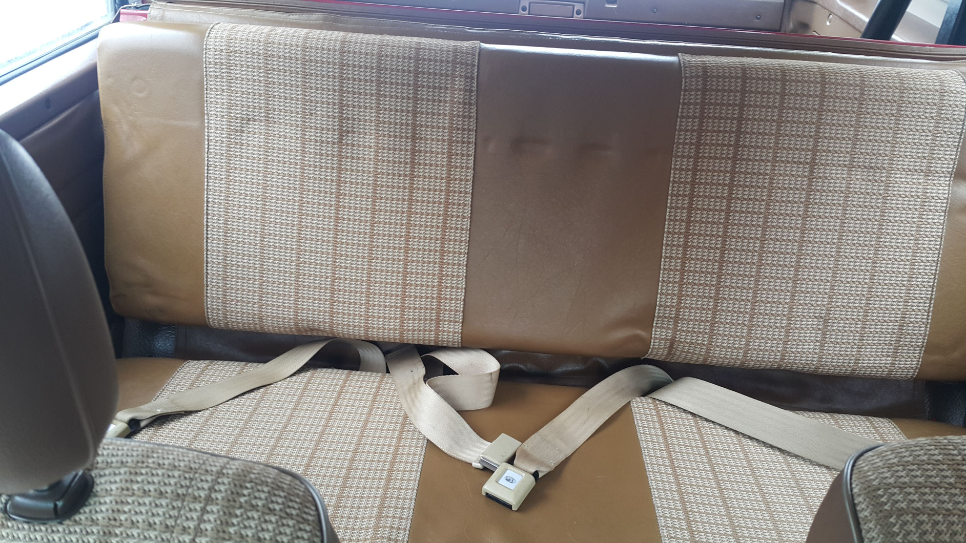

Thanks for the input. It's a 1986. It is a base model. Nothing extra. I think the rear seat might have been installed at dealer, as I've not seen this style in any other 4runners online. I would like to know exactly this part?

Factory rear seats are split. Your rear seats are not factory. Could be dealer installed or installed any other time, really.

Rear back part of seat is connected with velcro. easy removal. fabric is same as front (although a slightly darker tan- possibly due to sun in front? or mismatch of fabric)

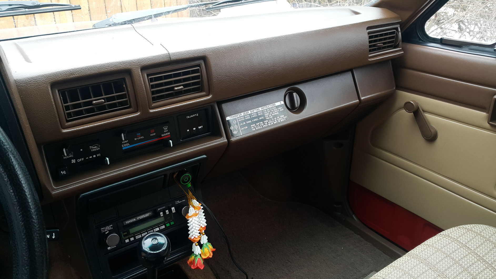

Sweet 4runner indeed! Interior looks super clean...besides that one dash crack haha

Got to see to that dash crack!! The little things stand out like a new car Started my clutch repair today finally, I got the parts in last week via Amazon. I went with stock parts, and no upgraded flywheel for this time. Will save the money for an OME system/tires first.
