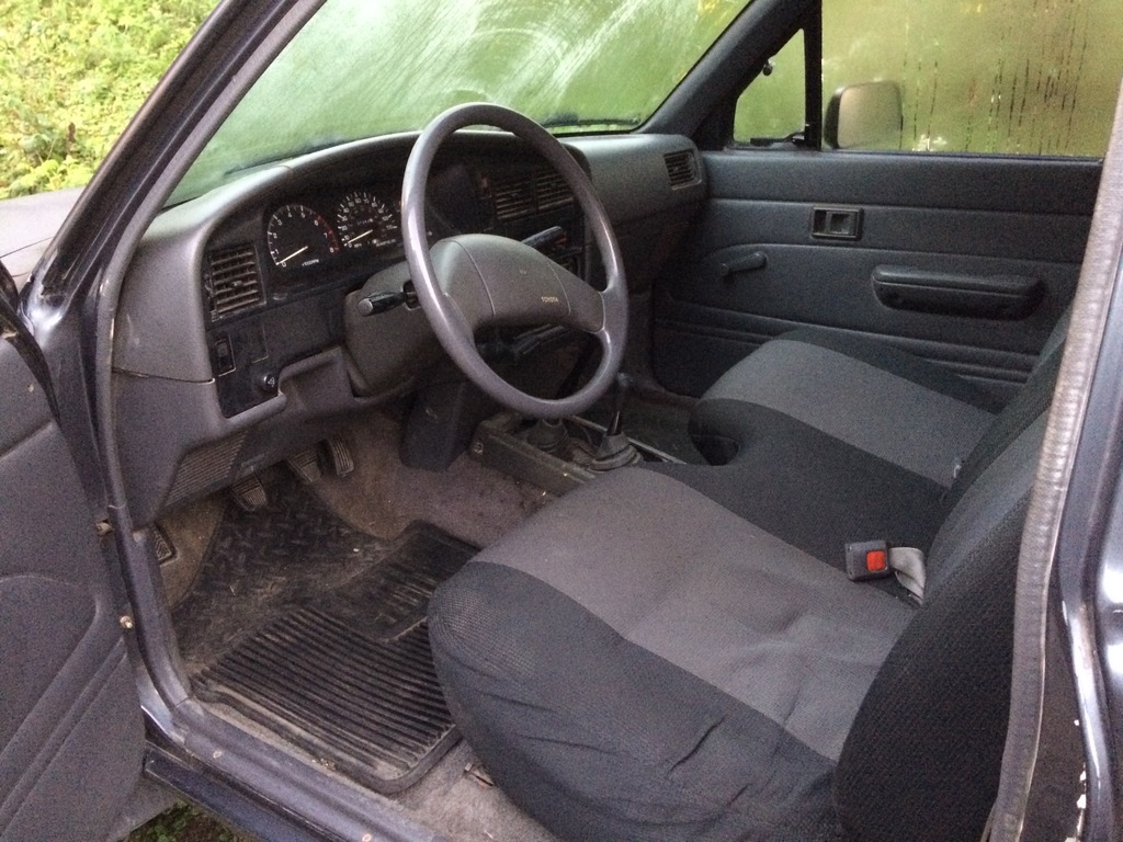

Some of you might remember one of my former students that had the 91 Toyota pickup that we found in Missouri and did some work to it a the school. Well.....He always wanted my 4runner and knew that 3rg gens were my favorite bodystyle, PLUS.........He he also had an 04 YZ250!!
Long story short.........In exchange for my Runner, I got a 1991 Regular Cab 4x4 22re , BL spacer lift, Truck cap, and a Stock 04 YZ250. Its kind of funny, but the Truck sweetened the deal. I had all intentions of parting with toyotas for awhile and just focusing on a dirtbike.
But the Stars must have aligned and realized that the Toyota runs deep in my blood and I couldn't possibly be without one!
So here are the goods.

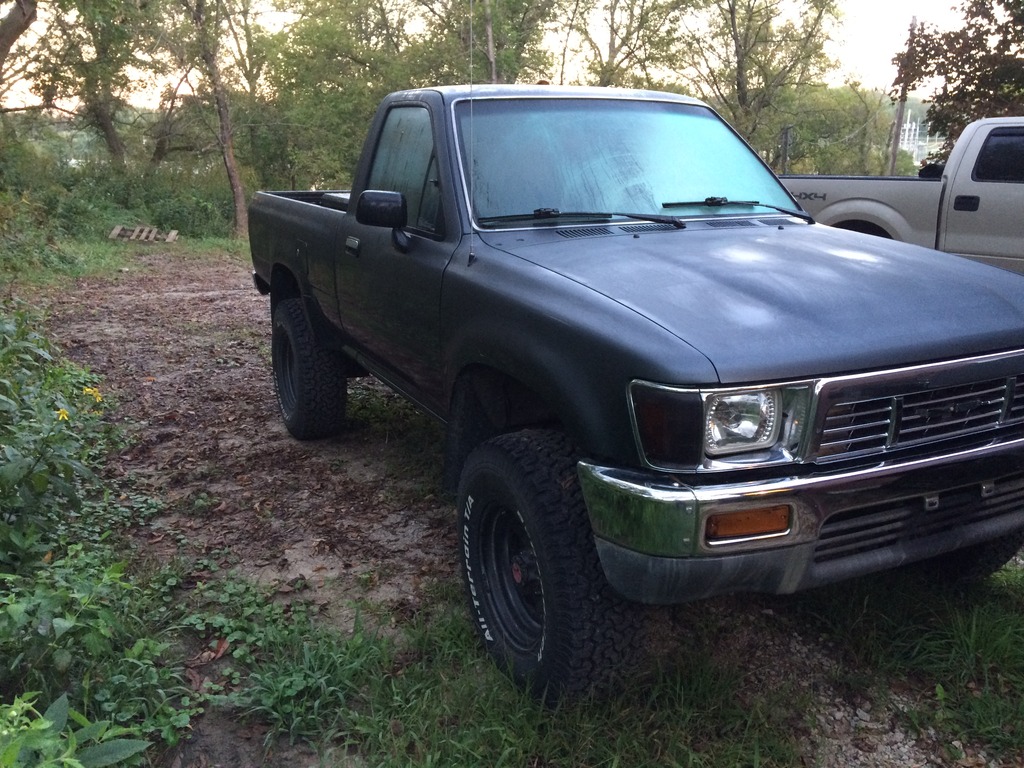

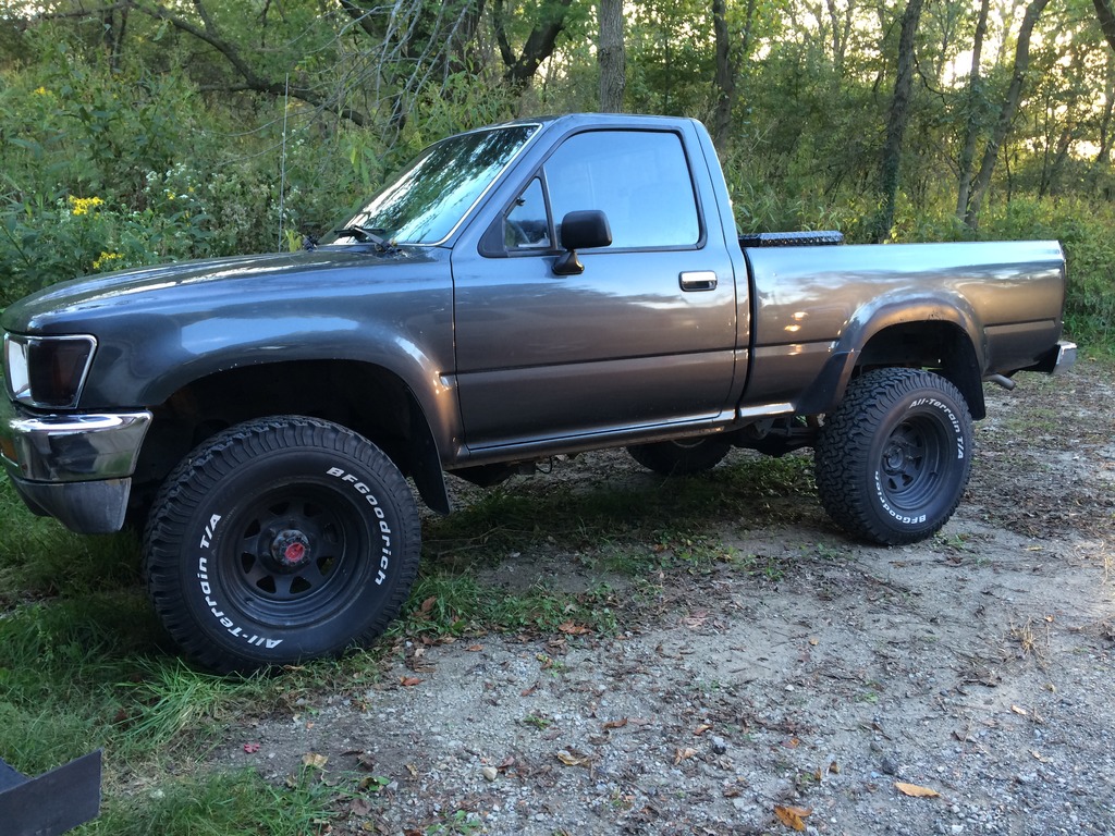

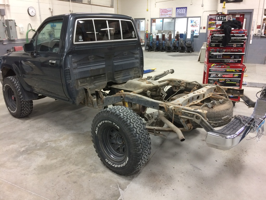

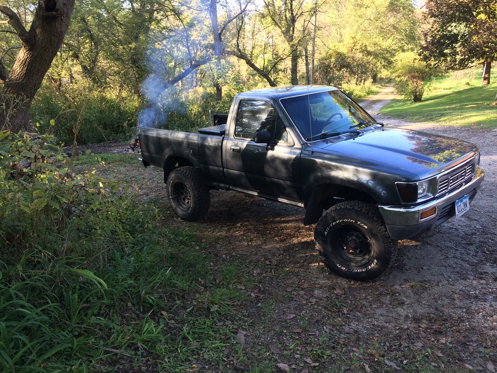

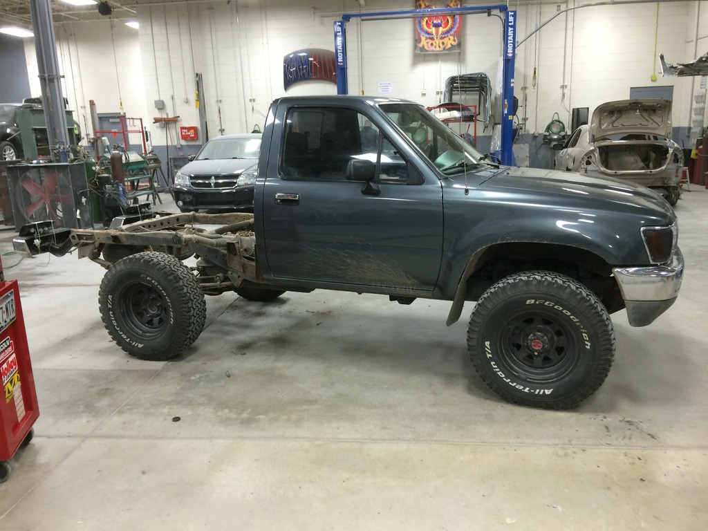

So the Truck........
We pulled the Engine and put a Timing kit in, Water Pump, Oil Pump, HG and Head Bolts. She burns some oil, and I am suspect that it has a similar issue that my old engine did with bad valve guides and seals. Just dumping oil into the cylinders.
My Plans for now are to:
Install the BL spacer lift this week
Get some 15x8 or 15x9 rims
33x12.50x15's
E-Locker for the rear
Some kind of lunchbox locker or spool for the front
Maybe 4.88 gears
I essentially want it to look like this one I found a picture of online

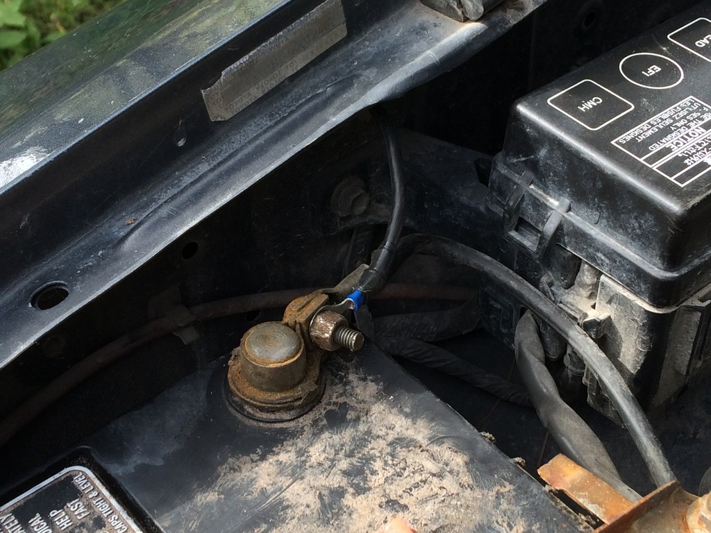

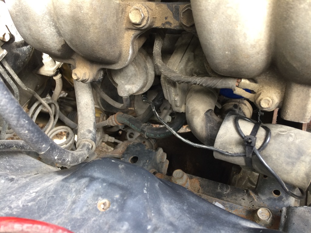

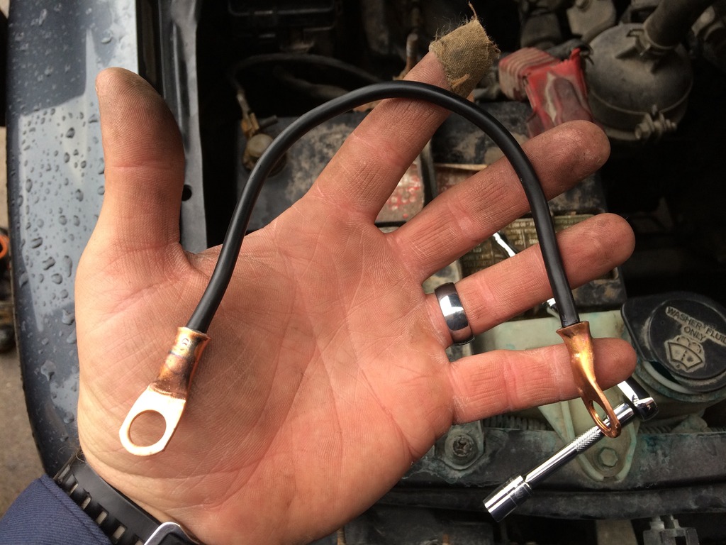

Made some weekend temporary repairs. The oil pressure sender harness was broken and the guage was dead and the body ground at the battery was broken.
So I made some temporary band aids until I can make an actual repair at work this week.

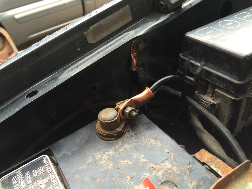

Made a new Ground cable today to replace the temporary fix I did over the weekend.

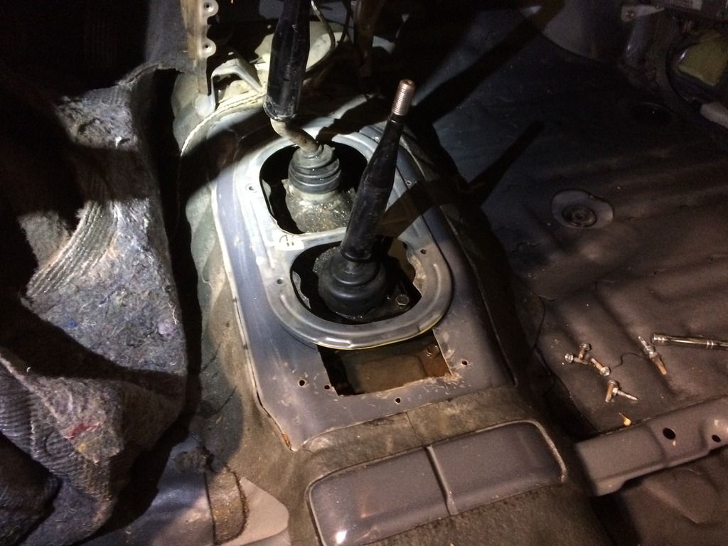

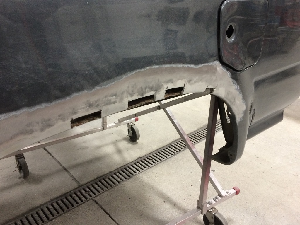

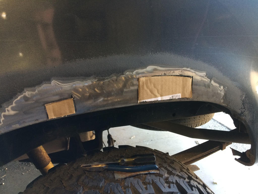

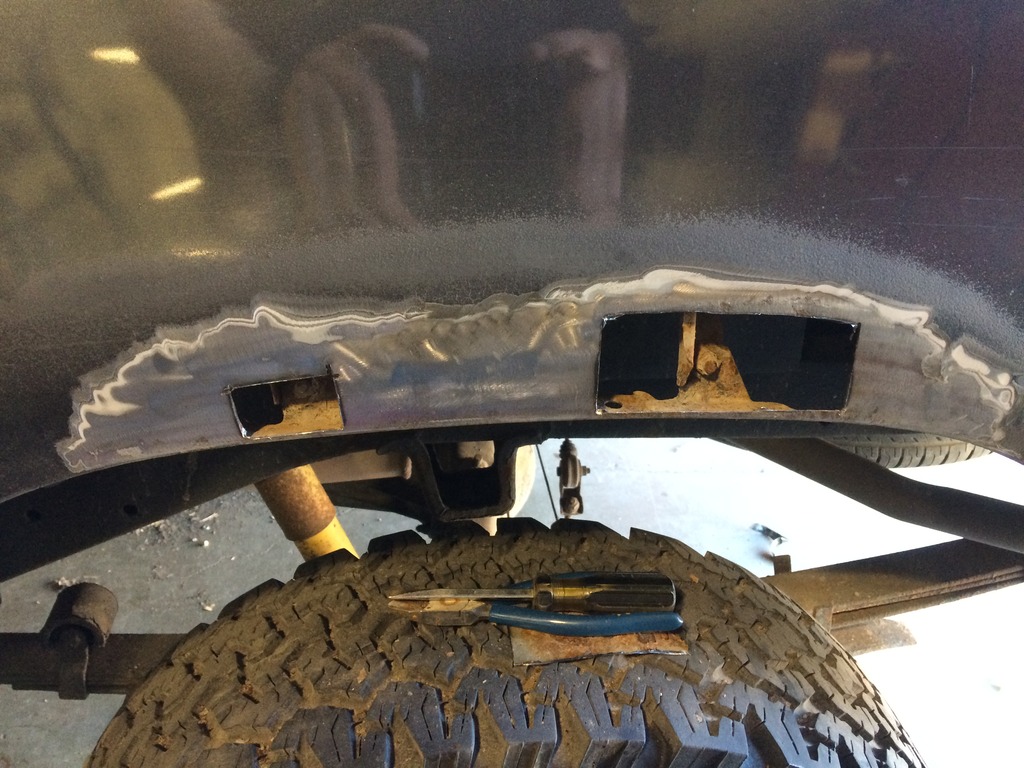

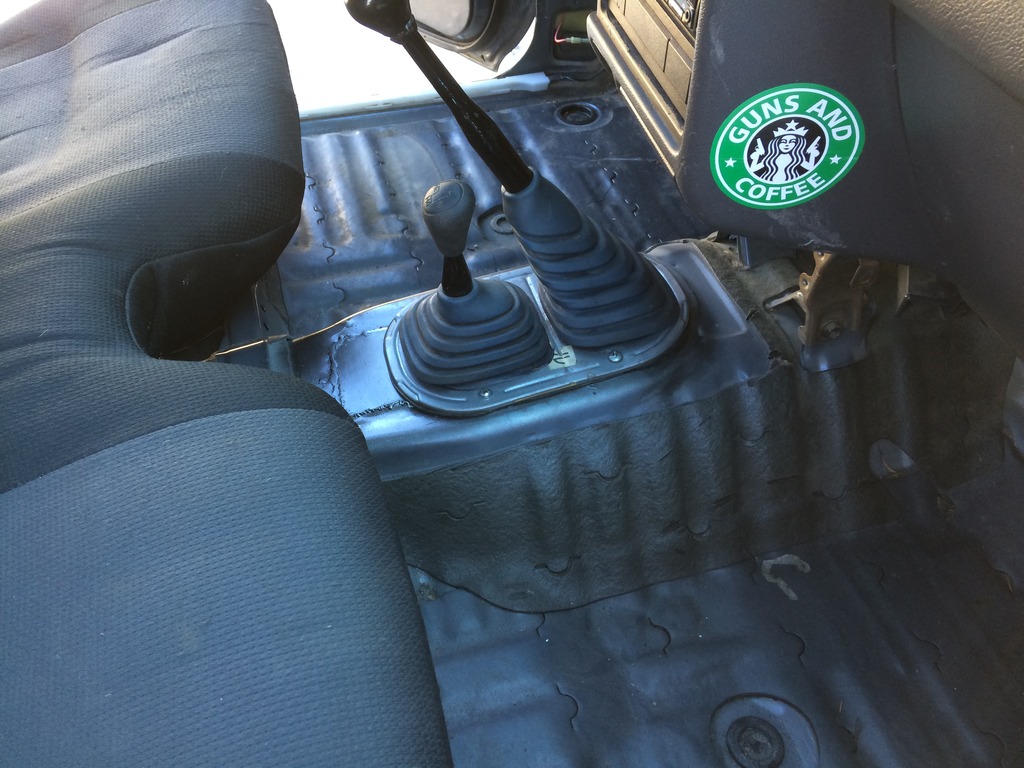

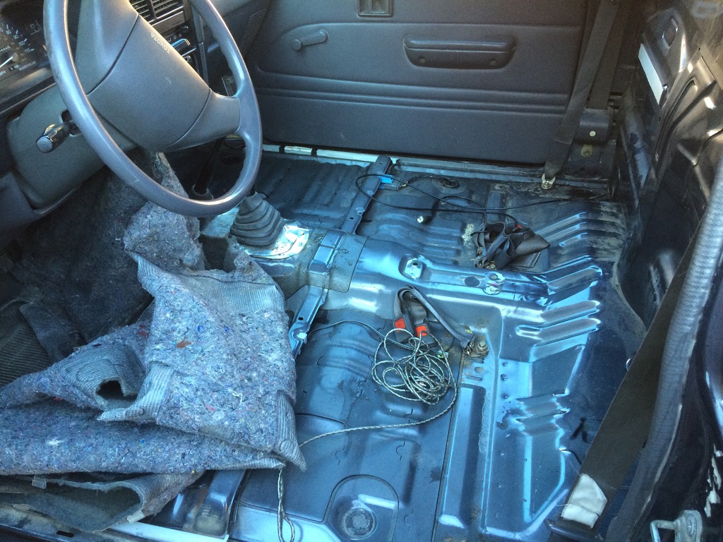

back in 2014, when my student owned the truck, the synchro's went out in his w56, so I found an older tip shift for a steal and we put it in.
Well we we had to hack up the floor a little. I never noticed until the other day, that the floor was leaking water as a result.
Off came the carpet.
Here you can see the hole

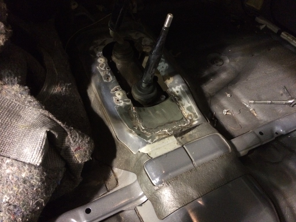

made a patch panel for the floor

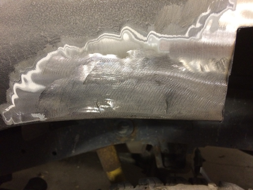

Got it tacked in but my darn grinder quit. Had no way to clean up the patch.

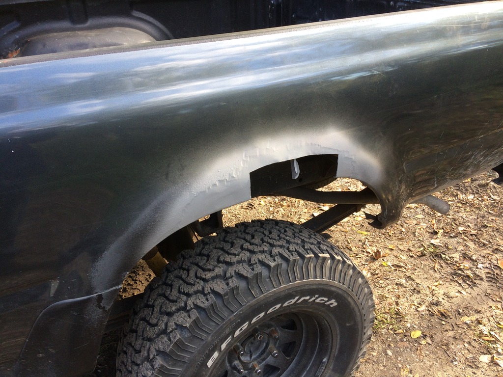

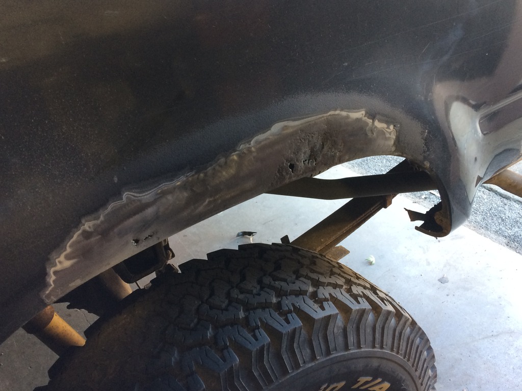

Since I was short on time, I decided to slap some paint on it so it wouldn't rust and finish it in a few days.
Heres the semi-finished product.

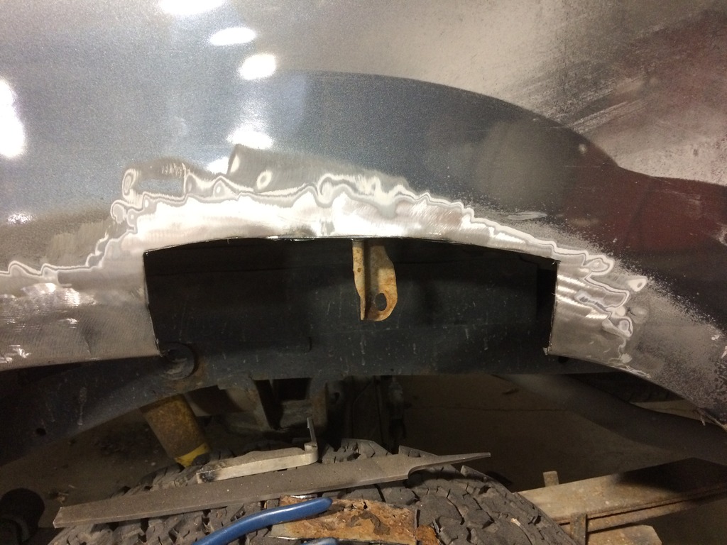

My upper ball joints finally came in yesterday, so I'm hoping to put those on this next week.

Your patch panel turned out great. It would of been nice if Toyota would of kept all the shifters in the same area.

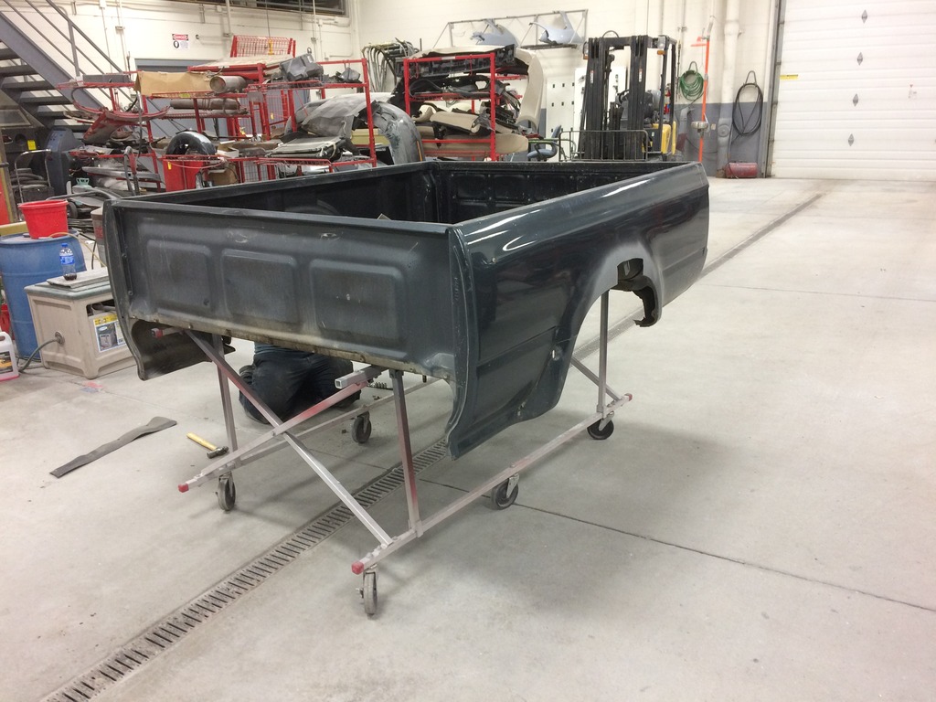

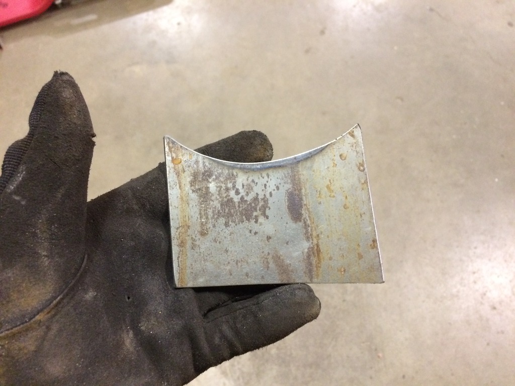

Started cutting out the rust on the drivers bedside. I want to get this thing as rust free as I can.
Heres where I started.
I decided to put a small patch in on the left smaller Hole.
After looking at how bad the lip was underneath, I decided to cut the entire section out.
After a long talk with My Coworker at my other job (autobody Program at the local community college), he talked me into bringing it in and letting the students tackle the entire bed. So they removed it last night, started to make a patch panel for the section I cut out. They also started stripping the areas down where there was more rust, and some dents.
