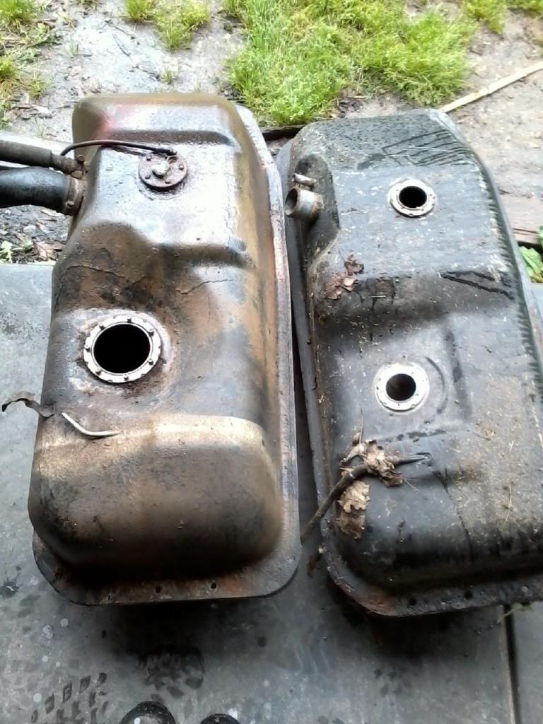

These are truck tanks. Here I am showing the difference between the fuel injected and carbed truck tanks. A 4Runner had the fill and vent lines completely oppisite of each other. They are not interchangeable as far as a bolt in fit. I have a picture some where showing the difference between 4Runner and truck tanks but cannot find it at this time. I will see if I have a truck and 4Runner tank and can show the difference.
