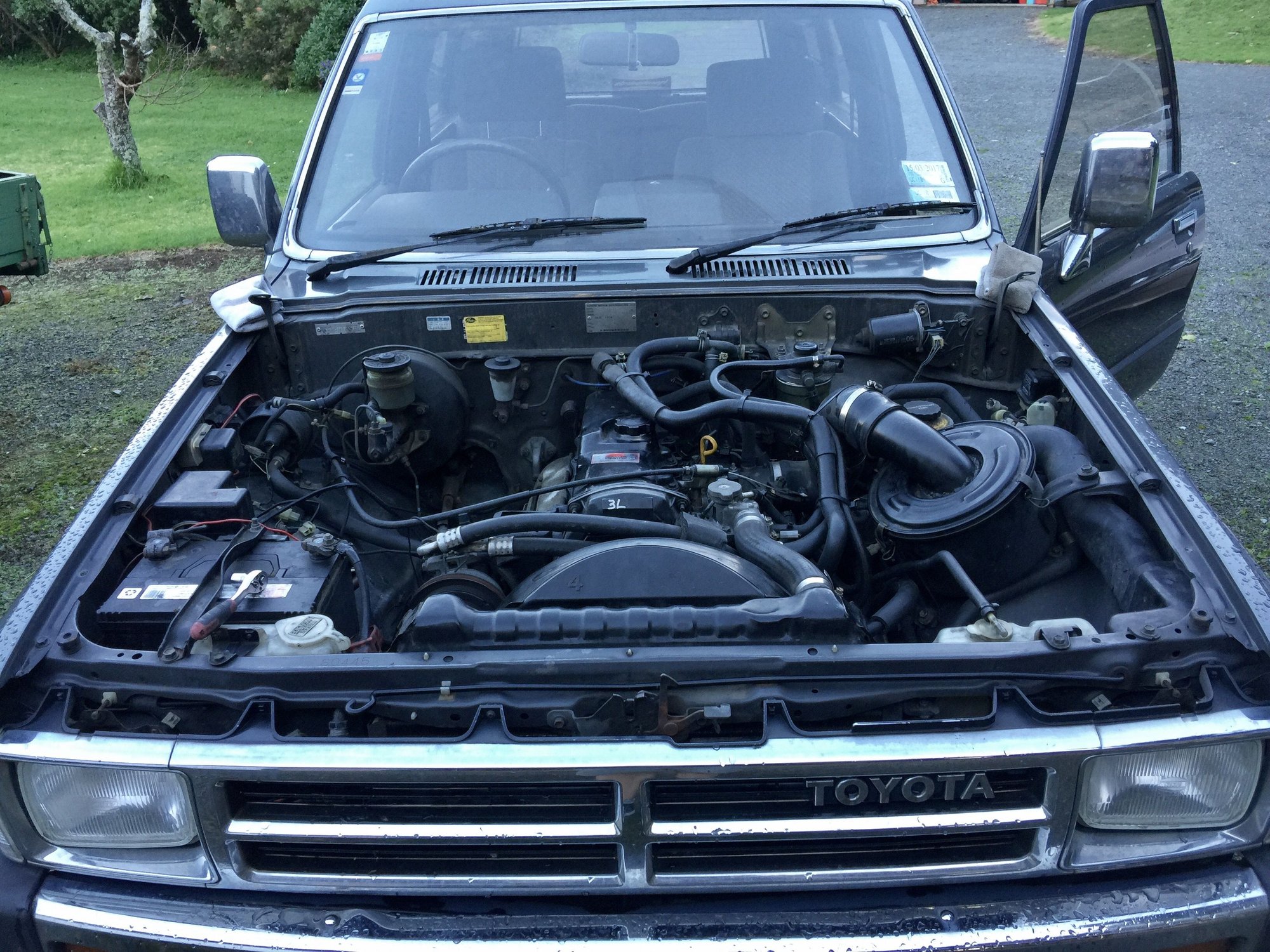

Last week I finally managed to get my hands on a very tidy 1st Generation Toyota Surf. The chassis code is LN61 meaning it came factory with 2.4 turbo diesel 2L-T engine and IFS. According to the records from the PO the 2.4 had quite a major rebuild a couple of years ago then ran a bearing not long after. It was then replaced with a 2.8 non turbo 3L engine. Unfortunately the PO was not very mechanically minded and so when he attempted to change the oil himself he overfilled the engine resulting in a diesel runaway. So I bought the truck as a non runner and trailered it home.
Once I had it home I drained the oil to the correct level and tried to start it but it wouldn't fire, so I sprayed some brake cleaner into the air intake and it started right up. It poured out smoke for a few minutes but as it warmed up it cleared and actually started to run quite smoothly. I took it for a run around the block and it all seemed ok so I booked it in with a mechanic for a general checkup. Sadly on the way to the mechanic the engine started to get a bit noisey which they diagnosed as a big end bearing noise and advised me to take it home and stop driving it. On the 10 minute trip home the engine got worse and as I pulled into my road it lost oil pressure so I crawled it back in the drive and parked it up.

On Friday night my brother and his mate helped me get the engine removed and onto an engine stand. We pulled the sump off and 3 of the four big end bearings were damaged. So this week it's off to the engine reconditioners...

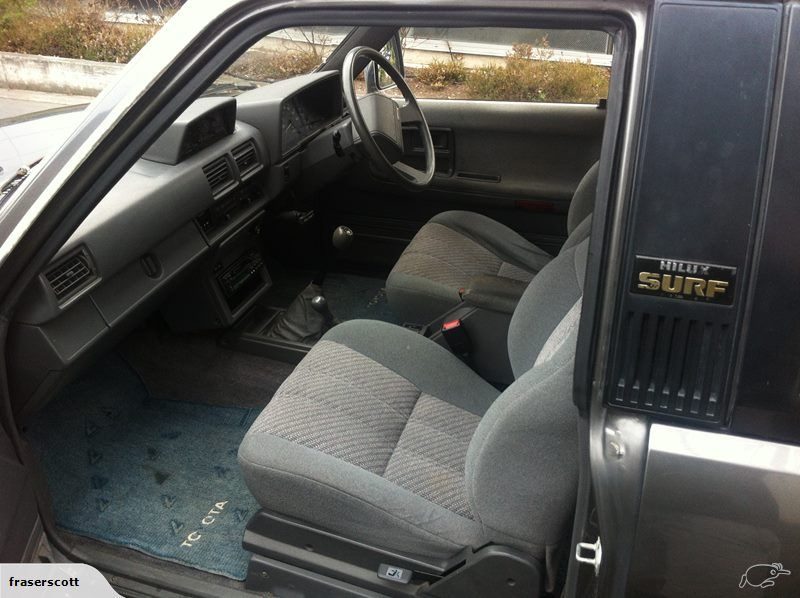

In the mean time I'm getting stuck into the interior. During the couple of short drives before it finally died I noticed the truck had a lot of rattles and road noise. The carpets needed a shampoo so I started stripping the interior so I could line all the sheet metal with a sound deadening material and get the carpets cleaned. I've just finished the cargo area and it has made a huge difference already, it's noticeable just working on. Previously when you tapped on the rear quarters they would ring like a steel drum, now there is just a solid thud. I can't wait to drive it again!

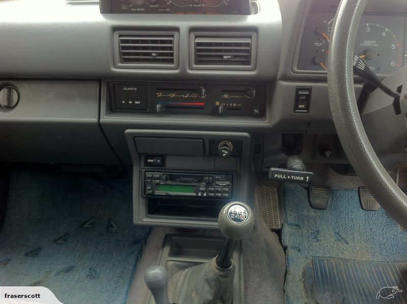

The truck looks clean. I;m surprised that it does not have a roll-bar; That could just have been a U.S. requirement to have one? Good job on the sound-deadening; Many of us have done that, too.
I suggest you check the previous owner's wiring job. Looks bad. I also wonder what the yellow wire int he cargo deck is for.

RAD4runner - I believe the rollbar was just a North American requirement, but I could be wrong. Never seen one in a Japanese Surf. The yellow wire is part of the towbar (trailer hitch?) wiring, I plan to tidy that up too as it looks dodgy.
