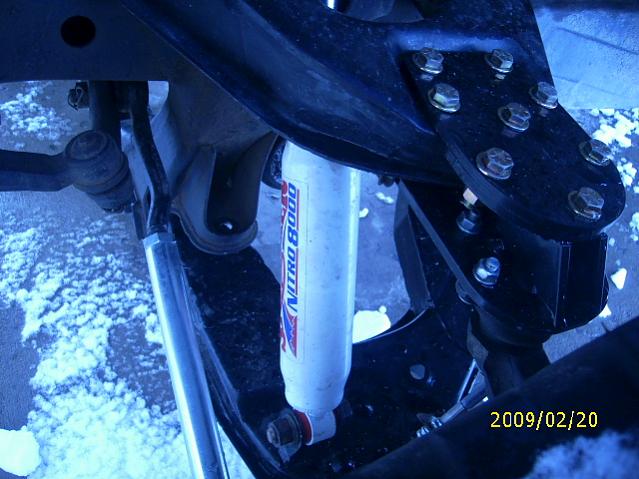

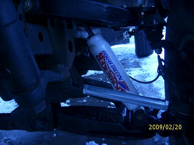

Well I guess I start off with the blazeland kit I just put on the truck. Sorry no install but I feel that aalba's thread covered everything pretty well. The kit is absolutly burly, I was very satisfied with the quality of the kit. I will be posting some pictures tomorrow. Also I went with some Skyjacker 4" lift shocks for 86-95 4runners and pickups, they are only a temporary shock until I can get some shock hoops. I am still running the stock torsion bars for a week or so till I can order some swayaways. So far the front of the truck is super smooth, now the back feels like crap. Anyways like I said photos tomorrow, and dont laugh too much as I dont have any fender flares yet.

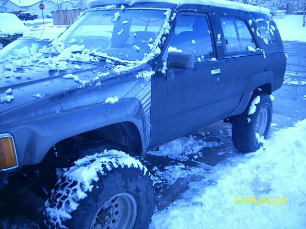

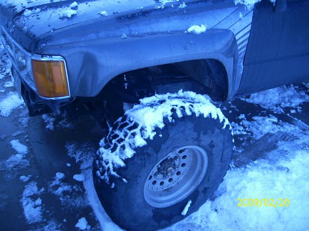

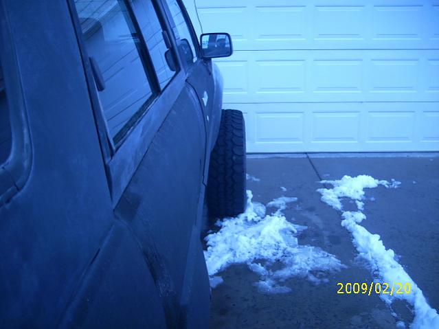

We had a crazy snow storm last night, as the pics show. Anyways heres my 4runner. the sides doors and roof are all painted rustoleum bedliner, I was gonna do the front fenders but now I need some fiberglass ones. Also its only 2wd right now. Ill take some more later today when it warms up.

Awsome you got it on your truck so fast! Too bad you don't have your T-100 CV axels so you could thrash around in the snow on the streets in your neigborhood...... in 4WD! How much snow did you get?
If you can get the stock T-Bars dialed in to hold the ride height over the next week and feel confident with the ultra cranked pre-load it might be worth a second look? But with the SAW T-Bars you won't have to overload the pre-load and it will ride much better and reduce hard bottomming onto the compression bump stops...... which I don't see? You are bottoming out onto the shocks in this configutration. The shock isn't designed for this and one hard hit may cause damage to the shock. A seal will probably start to leak.

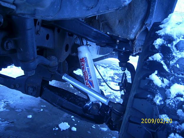

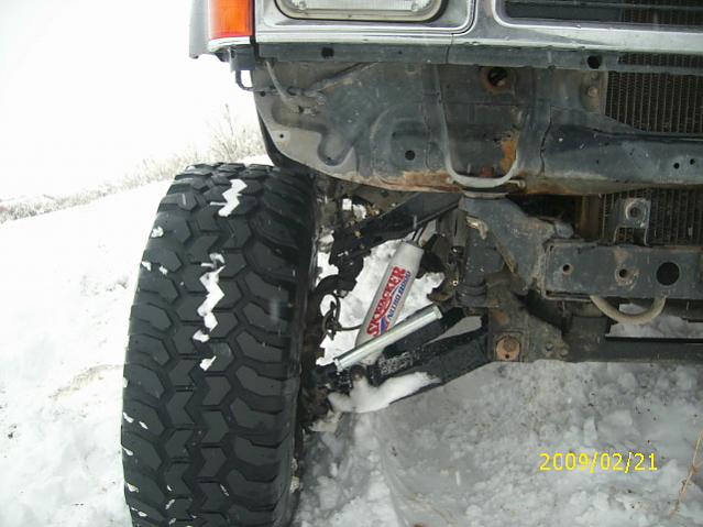

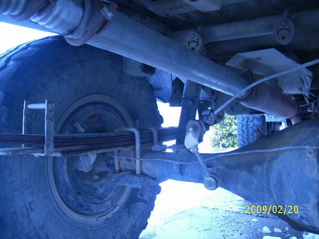

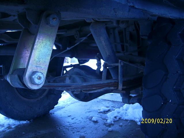

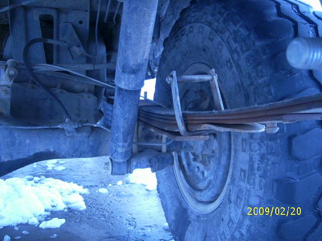

Heres what the back suspension looks like for now. It flexes pretty good, but it rides rough and bounces the truck forward on harder bumps.

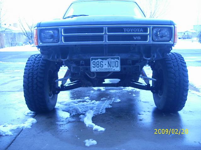

Heres a pic of the front width
Attached Thumbnails Crazytoyota4x4's 1988 4Runner Build-Up Thread-dsci1790.jpg

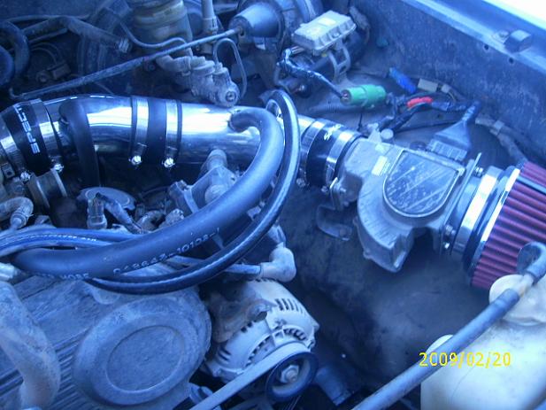

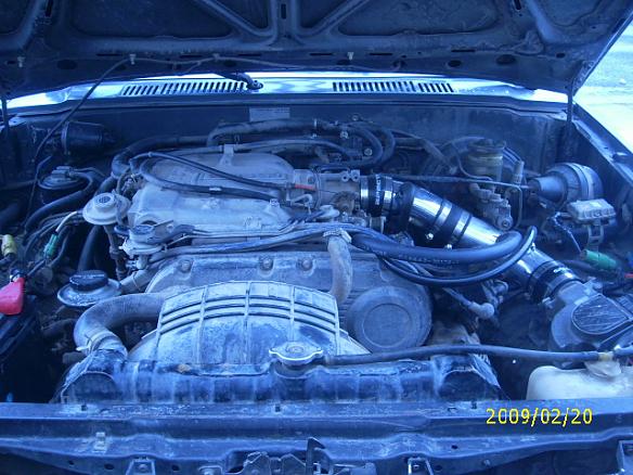

heres one of the front stance, and a couple of the motor (which I really need to clean) with the cold air intake I made.
Attached Thumbnails Crazytoyota4x4's 1988 4Runner Build-Up Thread-dsci1791.jpg   Crazytoyota4x4's 1988 4Runner Build-Up Thread-dsci1793.jpg   Crazytoyota4x4's 1988 4Runner Build-Up Thread-dsci1794.jpg

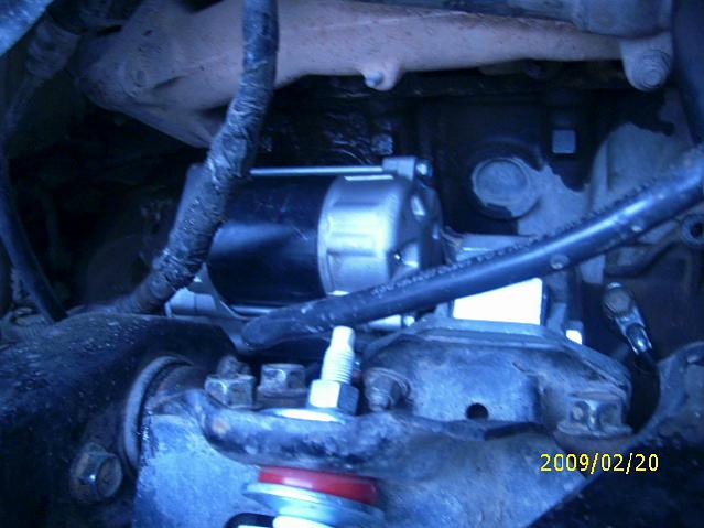

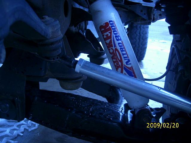

Also I just replaced the idler arm and starter....again. I know it probably just needed brushes, but with the economy like it is I had beat on the starter for a while so I just replaced new. Ive gotten pretty good at changing out a starter in 15-20 mins. And in the pic of the starter you can see my super shiny motor mounts from Trail-Gear.
Attached Thumbnails Crazytoyota4x4's 1988 4Runner Build-Up Thread-dsci1796.jpg   Crazytoyota4x4's 1988 4Runner Build-Up Thread-dsci1797.jpg

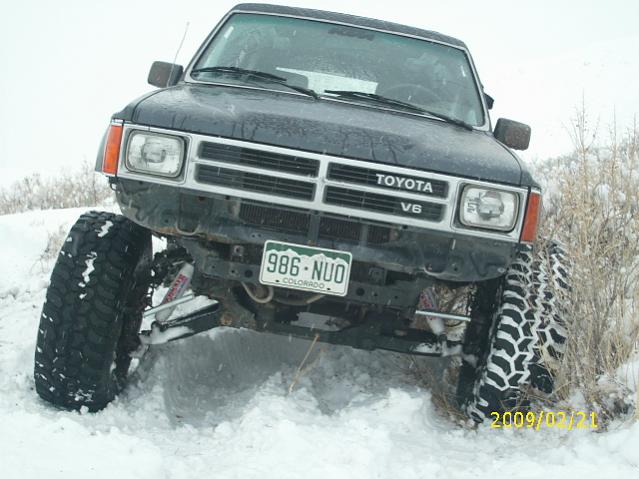

Dang this snow just wont let up! I woke up to another 4-5" of snow again, third day in a row. Come on weather so I can go and have fun.

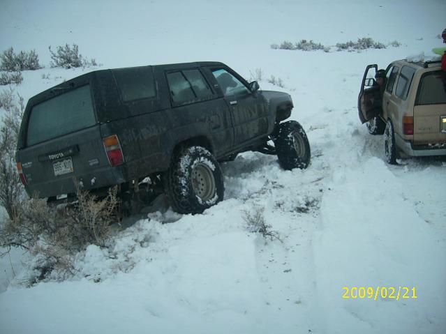

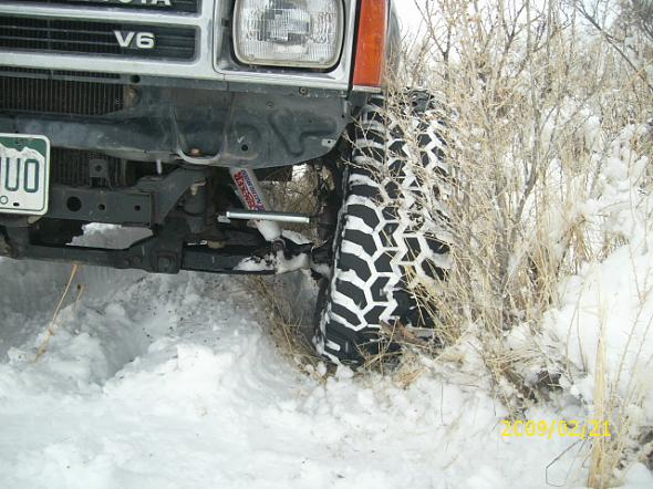

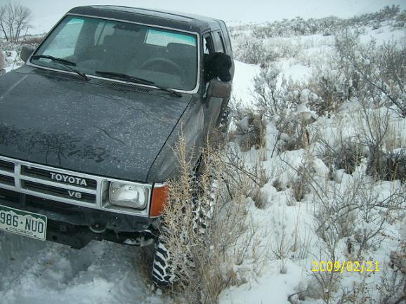

I went out and had some fun then got stuck, my buddy tried to pull me out but I ended more stuck in this ditch. Heres some pics: Oh and my runner got out under its own 1 wheel peel
Attached Thumbnails Crazytoyota4x4's 1988 4Runner Build-Up Thread-dsci1802.jpg   Crazytoyota4x4's 1988 4Runner Build-Up Thread-dsci1803.jpg   Crazytoyota4x4's 1988 4Runner Build-Up Thread-dsci1806.jpg

heres some flex and my buddys 4runner pics:
