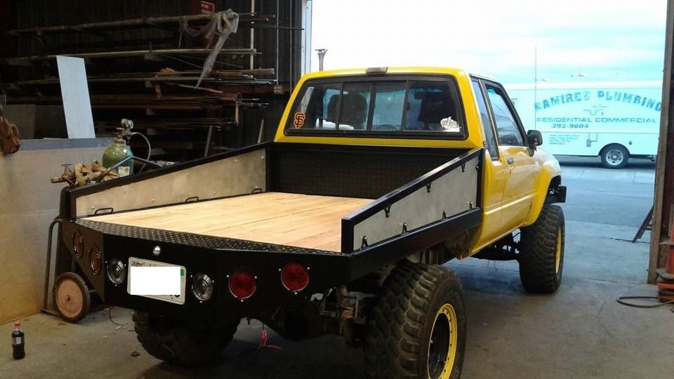

picture heavy I've done quite a few mods to my truck. about 8 months ago my bf and I made a "flat" bed for my truck
cleaning the frame up after removing the old bed. there is only 6 bolts that hold the bed down, fuel filler neck (3 screws) and the tail lights - very easy to remove
setting up the main frame of the bed
bobbed the end of the bed
setting up the sides
making sure the lights fit
the tabs my bf designed and cut with a water jet
the finished product

i dig it! realy clean little bed youve got!

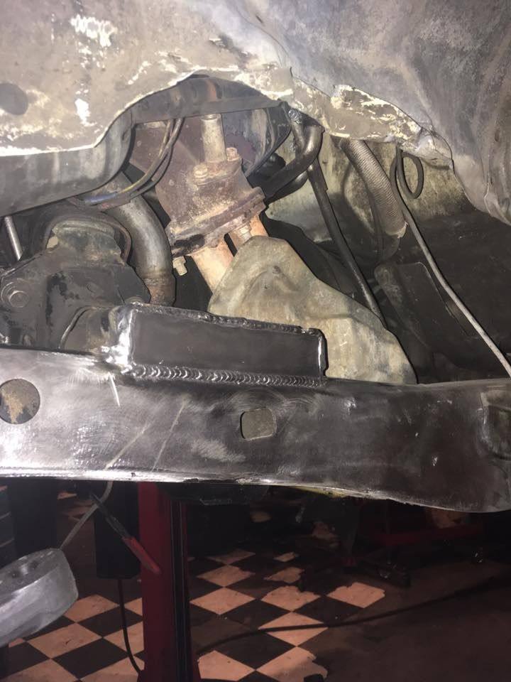

did a solid axle swap a year ago sorry for late pictures just totally neglected my yotatech account Unbolt IFS
Torch off brackets
grind smooth
plate for engine mount provided
Sorry no photos of rebuilding front axle, just followed Lowrangeoffroad's youtube tutorials
loosly bolt everything in
set up steering
check ride height and shackle angle
