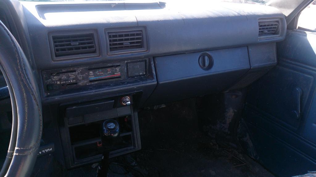

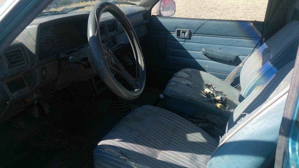

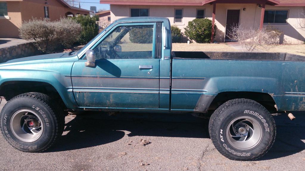

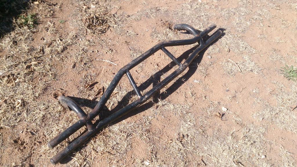

Here are some pictures for y'all.

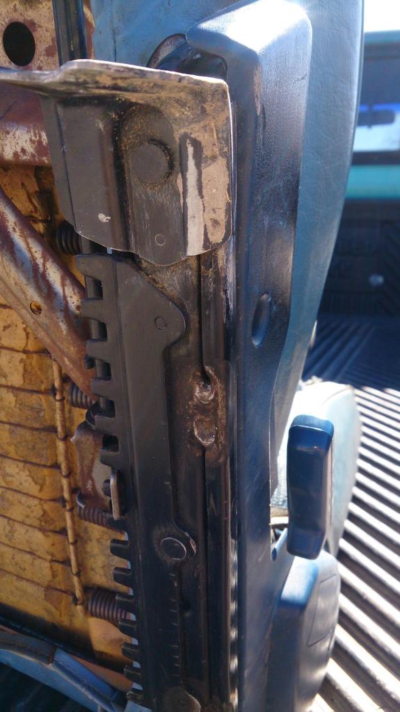

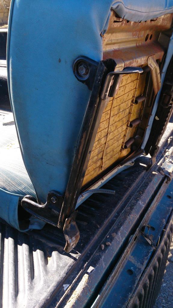

put the new seats on the original yota brackets.

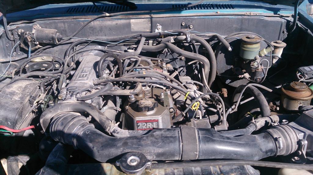

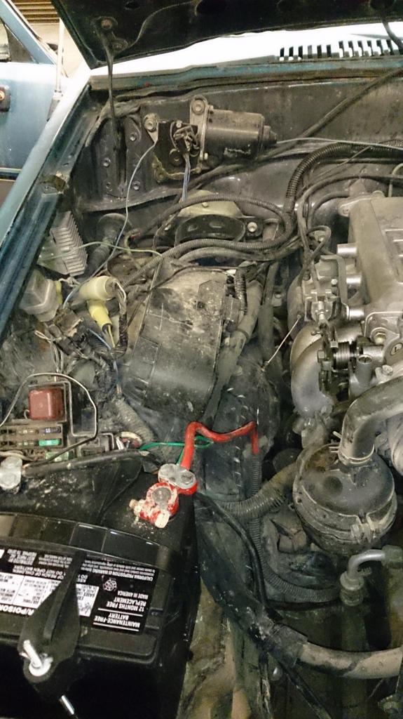

Okay so regarding the engine, I think it's a 92 after some alldata research and picture comparing. A quick search showed that there is, in fact, no way it can be a 96 haha. The wiring harness seems to be really jumbled. This weekend I'm gonna drop the transmission and clean the block to get a look at the numbers. Once I get all that information I'l have a place to start my part shopping.

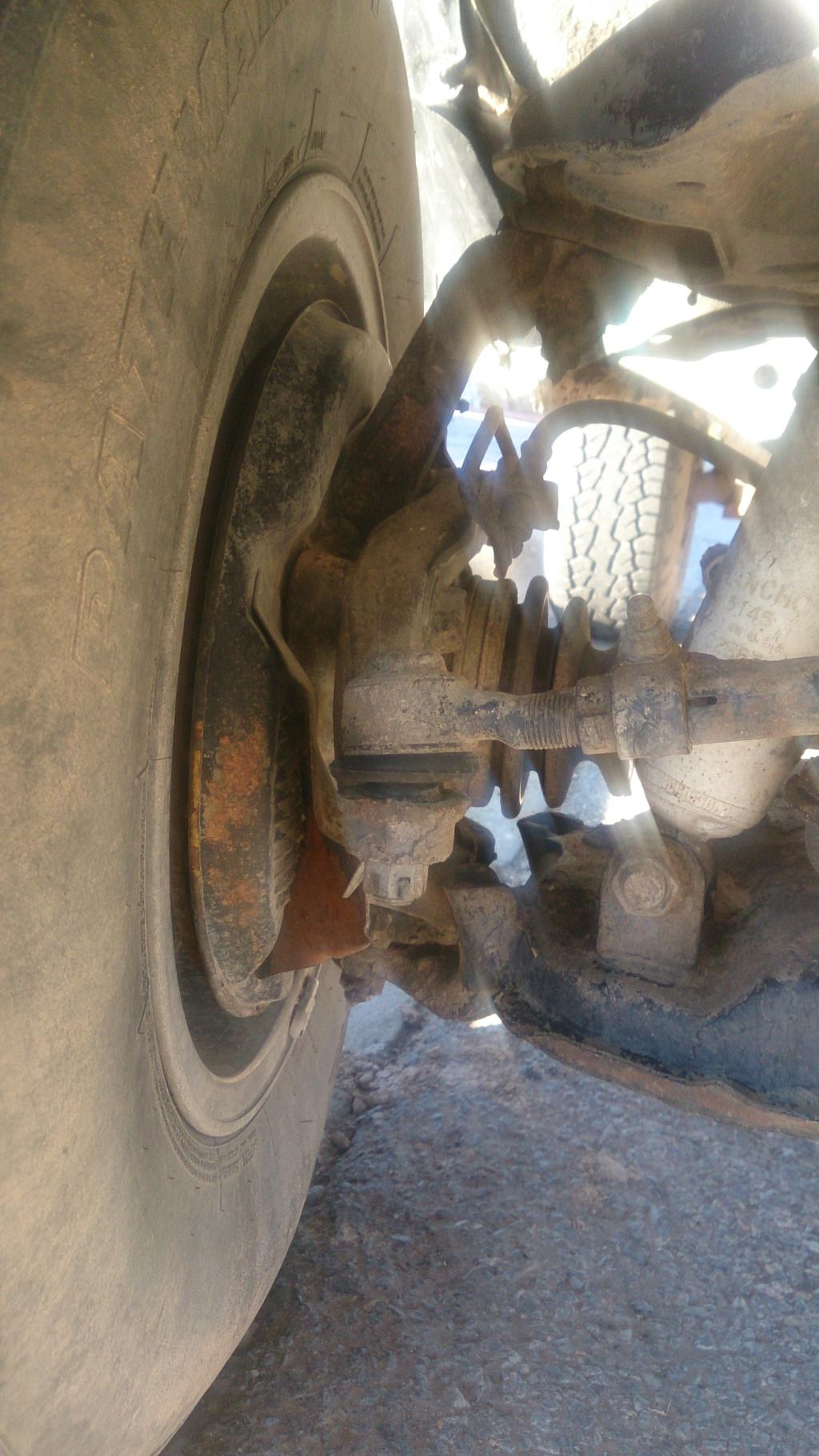

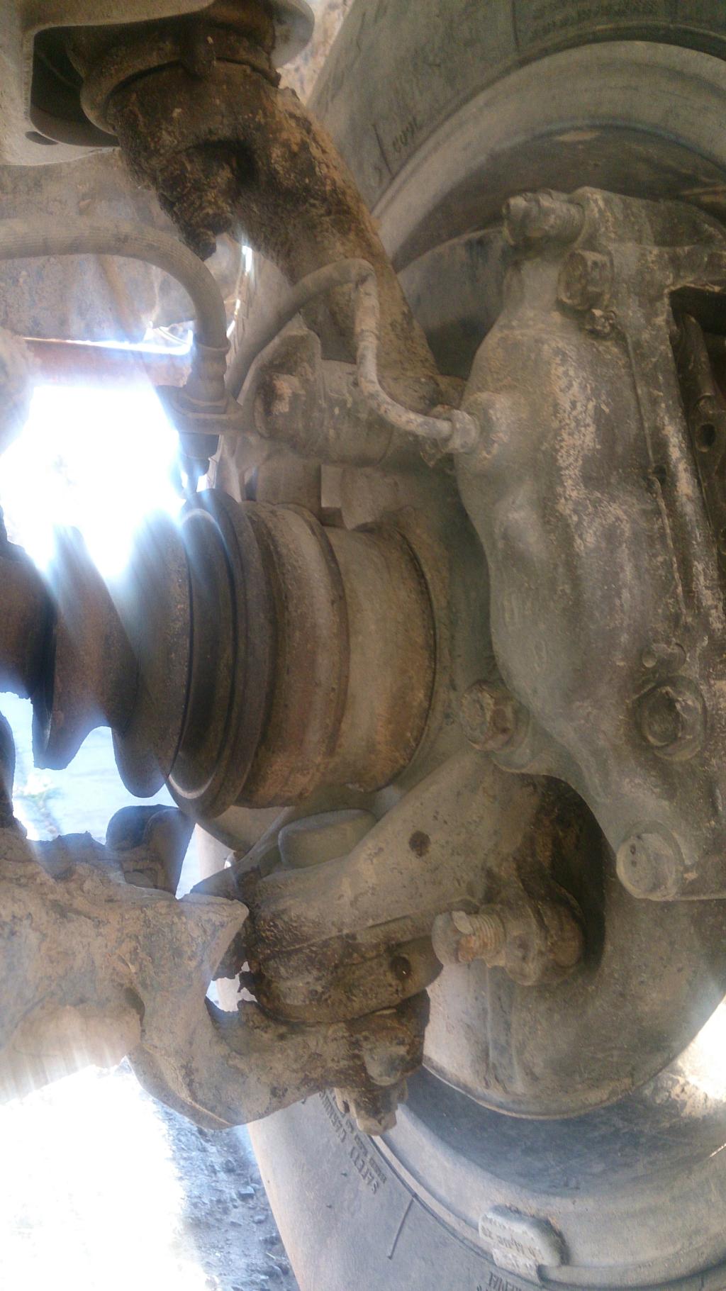

The front right shock seems to be shot so I'm gonna get a new pair for the front. Would that make the noise? CV problems maybe? The noise is pretty unbearable but it's only in reverse. I've made full circle turns in both directions going forward and it's fine. It seems to be just in one direction in reverse.

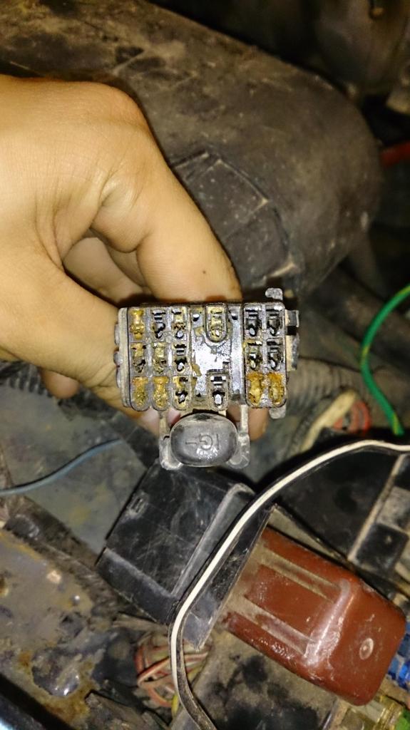

The wiring is my primary concern at the moment. I'll post some pictures in a bit. The diagnosis connector threw me off for a bit. I've read that the harness is a pain to get settled with a swap like this.

Not a whole lot of people can hot wire an ecu into an older car. There are things that cross the chassis harness to the ecu that if not present, you go nowhere. So if someone did put a 92 engine it, with an ecu. At worst its a fragile wiring job.
Reverse is probably a CV joint full of mud.

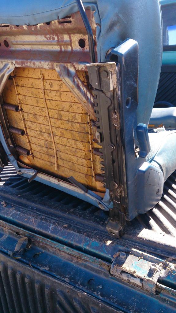

Okay so here you can see the welds and the seat bracket. I can cut the welds to free the slide. Then you can see another angle of the engine bay and the connector. I'm getting a little nervous about the wiring situation haha. Is it a big deal if the wiring isn't perfect? What kind of problems should I expect? Anything I can do to improve the situation?
I also thing that the truck was originally an automatic. SO the gauge cluster doesn't have a tach. Can I swap in a newer cluster with a tach? Say a 92?

Nope; it was always a stick, resistor is right there on the firewall. Actually it doesn't look that bad. His claim of an engine swap looks to be BS. Even has the OBD1 diag port. Stupid simple setup. ECU is in passenger side kick panel. Vacuum canister from the gas tank is missing. Probably created a vacuum leak to go with it. Truck had A/C from the dealer when new. It also had a bench seat originally. Is the A/C compressor still there?

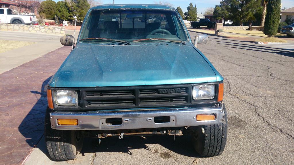

@skyI figured it was BS. 92 is still possible no? Since OBD1 lasted until 96. The ECU (as I found yesterday) is in the kick panel. I was wondering what that bracket was for. I'll be doing compression test, vacuum leak tests, etc soon. It seem to have a misfire so I'll look into that. I knew about the bench seat thing as well. I think I'll just drill the one hole that's not lined up for the driver and get seat covers for now. Yes the compressor is there it's just sans belt. Being winter I'm okay with that. About the cluster, what can I swap it with?
@boots I like it too! Enough to where I'm not dying to paint it anytime soon. But I will. Matte black is always an option but blue is my thing so I wanna find a nice shade. Grabber? Hmmmmm....

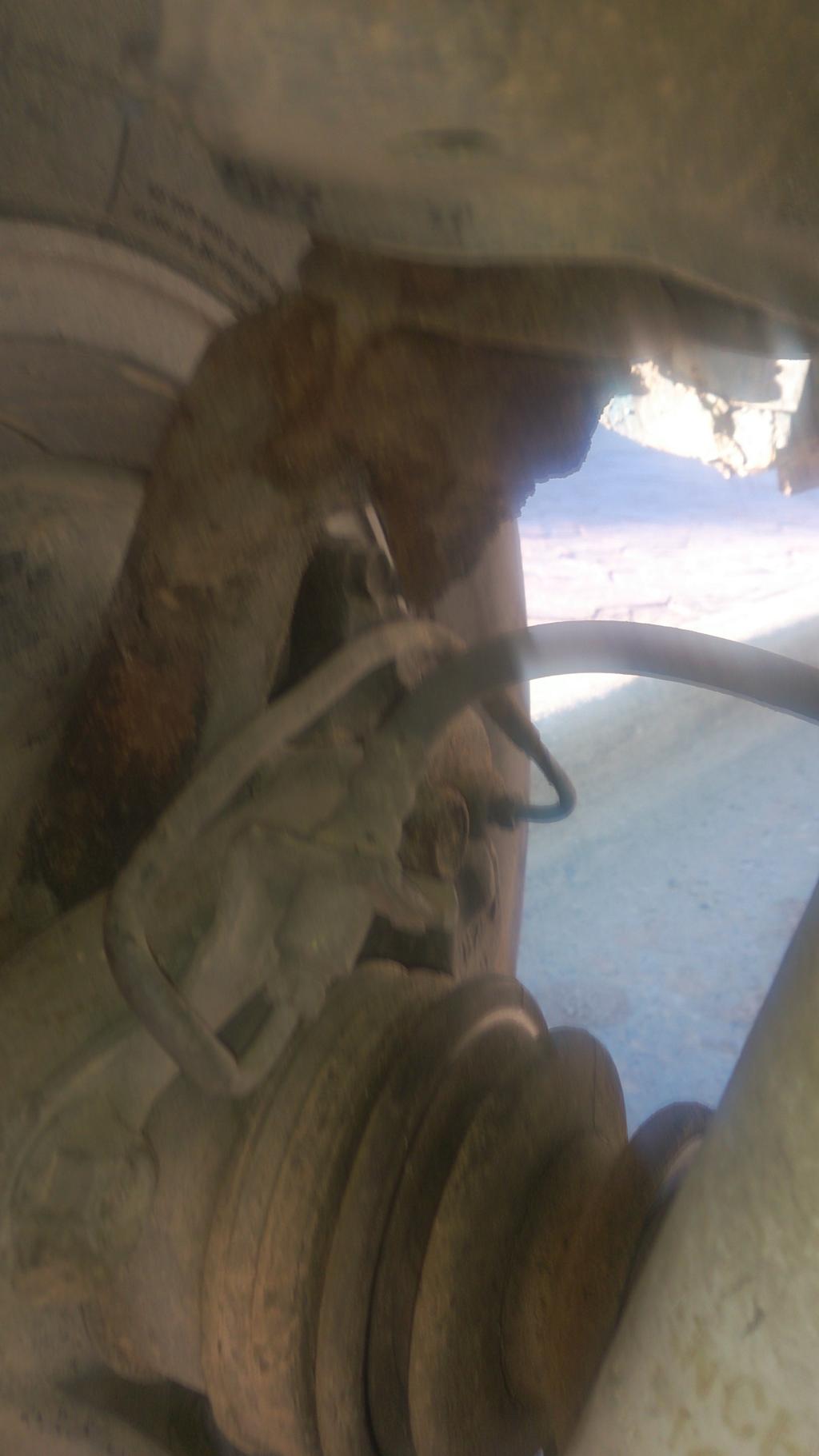

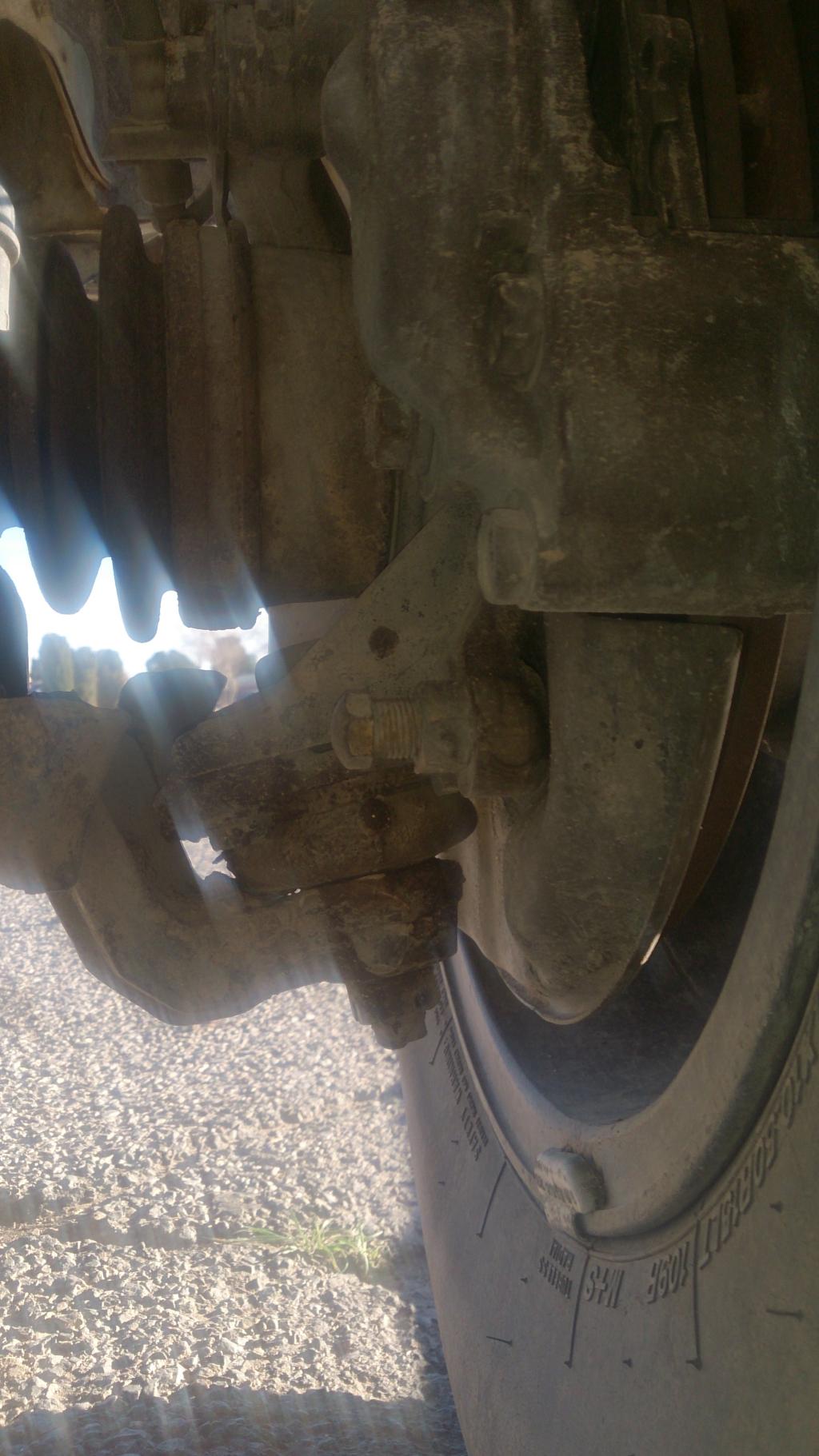

As for the grinding noise here are some pics of the wheel. I'll be doing some serious cleaning this weekend. Filthy.

Looks like you got a solid truck to start with. You will need to stay with 89 runner/88 pickup cluster gauge. Also do not hook up the oil pressure gauge unless you have the correct sender. SR5 has one style and non SR5 has another style. There is a thread on adding the cluster gauge on here.
As hacked up as your fuse box wiring is, I would just replace that section of the harness. It is easy, just find the correct year. It just unplugs. I think rebuilt CV shafts are only about $60 if I recall right if you are suspecting your shafts. Welcome to Yotatech.

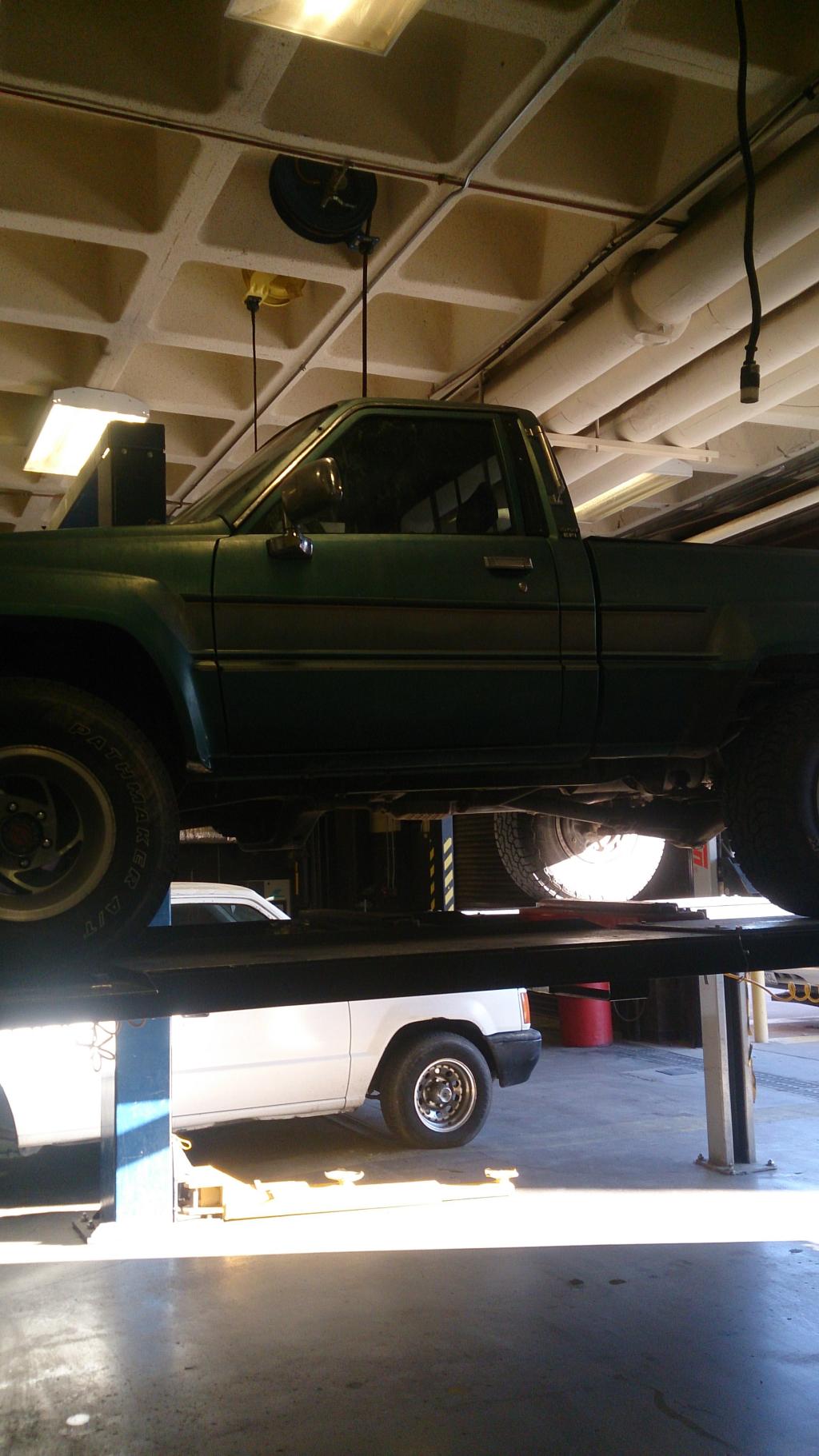

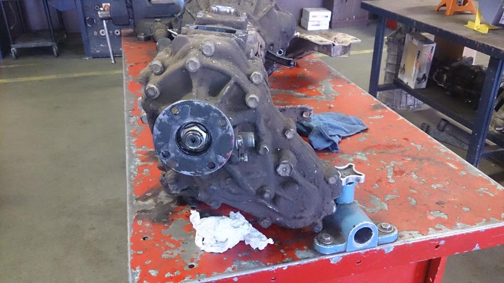

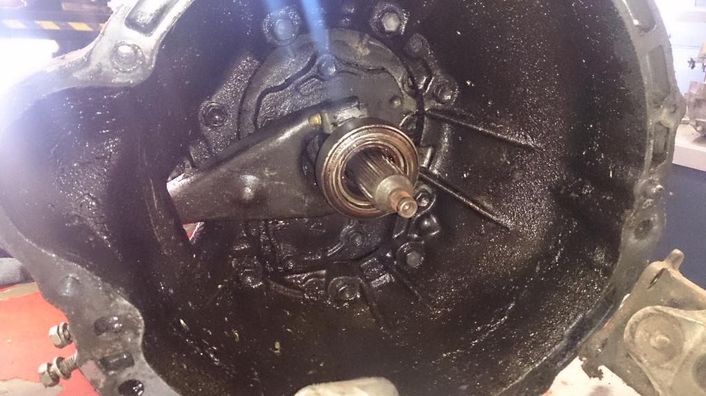

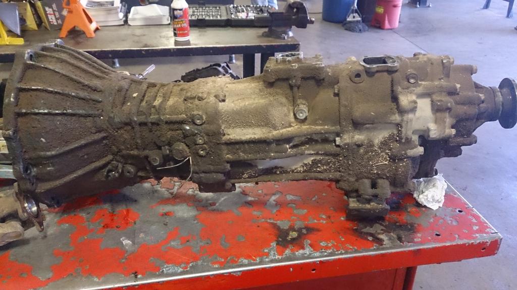

Okay. Just a quick update/picture post for y'all. I dropped the transmission today at school and drained and filled the front diff. The tranny is absolutely CAKED with an oil/mud mixture. It's such a thick layer that it messed with us because it added an extra size to a lot of the bolts. So what we thought was an 18mm was really a 17mm with 1mm of crap. I went to town with a wire brush on some of the surfaces and ended up with a pile of crap the width of a basketball and about 2-3 inches high. The good news is that I didn't even get 10% of it off :/ So I'm gonna take the tranny apart and go at it with some serious cleaning tools as well as stick it in the parts washer. I expect it to be in good condition despite it's appearance. But upgrades never hurt anybody.
The right CV axel is bad (torn boot) so I'm about to buy a new pair. I decided to nickname my truck Ghost Bolt. Since almost every part I've encountered is missing a bolt haha. Shifter plate, the 4wd shifter, tranny mount, rear driveshaft, tranny cradle, driver seat, passenger seat...all missing one bolt. So I'm buying/finding/making new bolts for those too.
Quick question for my own satisfaction. That's the W56 right? Looks like it to me but I'd like some reassurance.
