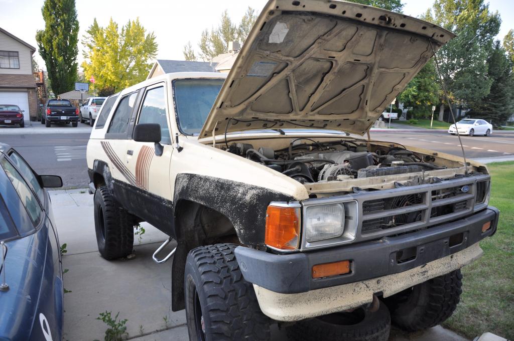

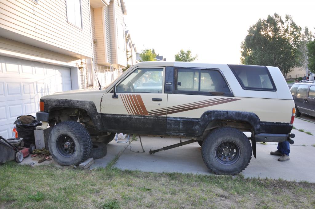

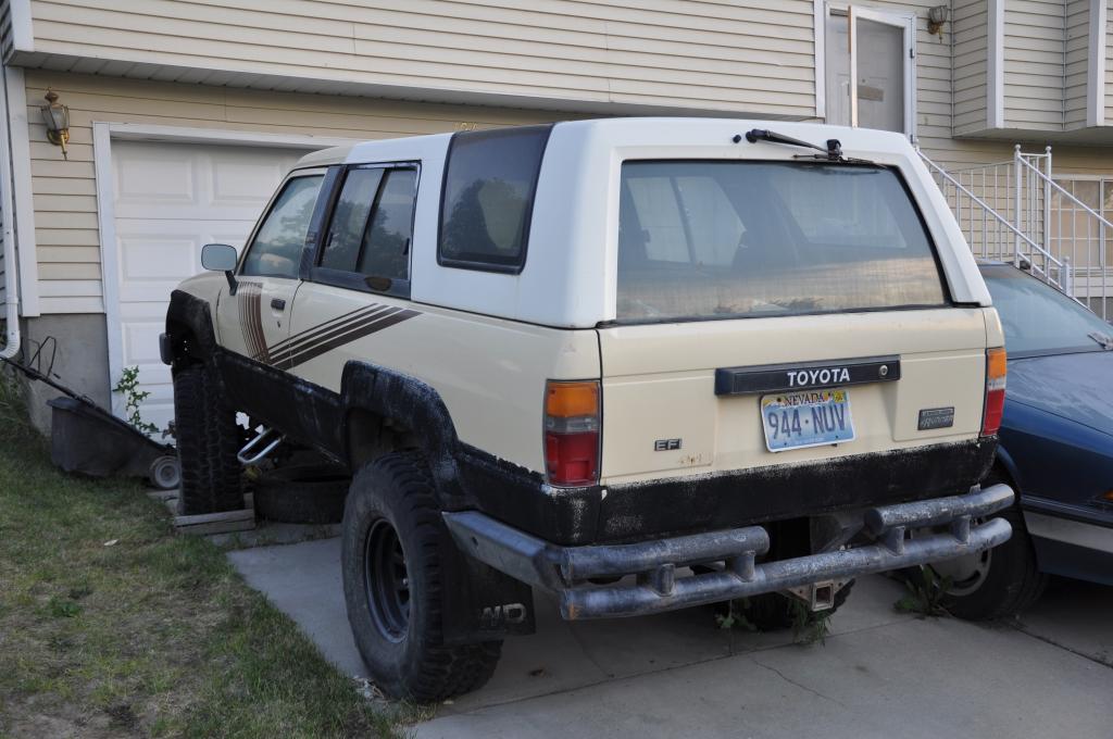

Heres the story behind this build. My first truck was an 87 SR5 extended cab that my dad had swapped a 302 HO (high output) from a 95 mustang into. Two months after getting my license I was hit by a drunk driver and my truck was totaled, we got it back from insurance and sold it to a guy in Elko with a 4Runner. Fast forward 13 years and the opportunity has presented itself to pick that 4Runner up for a pretty reasonable price, its an 85 and the swap looks just as flawless as when my ol man did it. It has been sitting for about 7 years, and needs the tranny put back together, other than that it'll require some minor maintenance but all in all I'm pretty stoked about the project. After its back on the road it'll definitely be working on some bumpers, sliders, suspension, and steering upgrades. Here are some pictures.
Attachment 130915
Attachment 130916
Attachment 130917
Attachment 130918

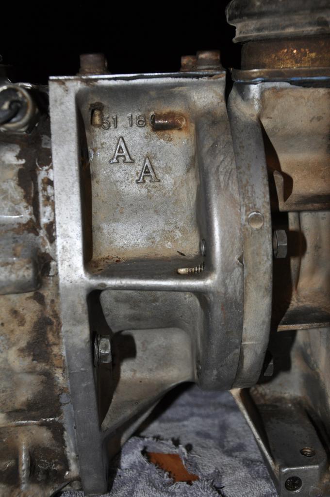

3 Attachment(s)

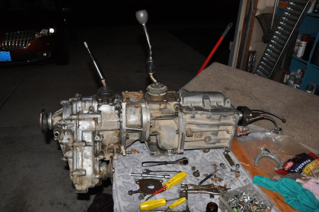

Tonight I got the new shift fork installed, cleaned the transmission, adapter and transfer case up in the solvent tank, not perfect but definitely cleaner. Mocked it all back together to make sure I had the transmission top plate assembled correctly. All seems to be working correctly. Now I'm waiting on a throw out bearing rebuild, the new motor mounts and a new radiator since the previous owner put a nice sized hole in the one in it now.
Broken shift fork, $20 fix.
Attachment 130912
All mocked back up.
Attachment 130913
For anyone wondering this is what the adapter from the T5 to Toyota transfer case looks like.
Attachment 130914

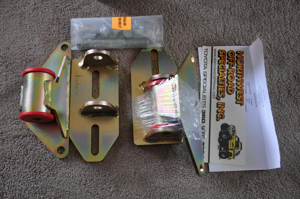

Got these in the mail today.
Attachment 130623
Also ordered a new radiator, 3 1/2 weeks is going to go by way to slow but at least it will be the right one and I won't be worried about it getting to hot. Since I have time before its up and running I'm going to start working on a set of half doors.

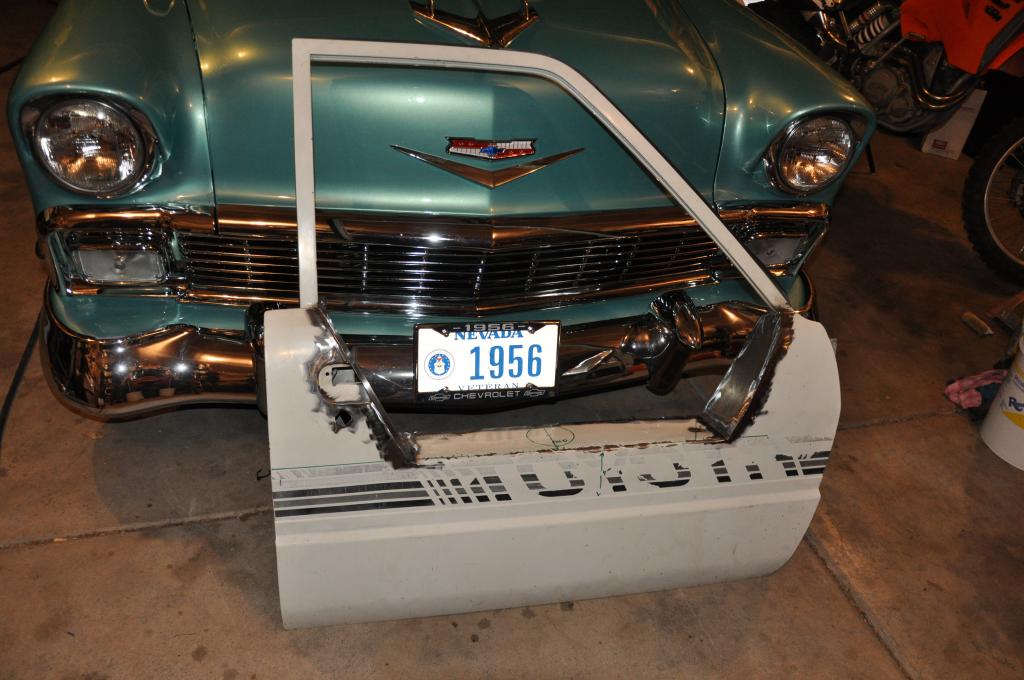

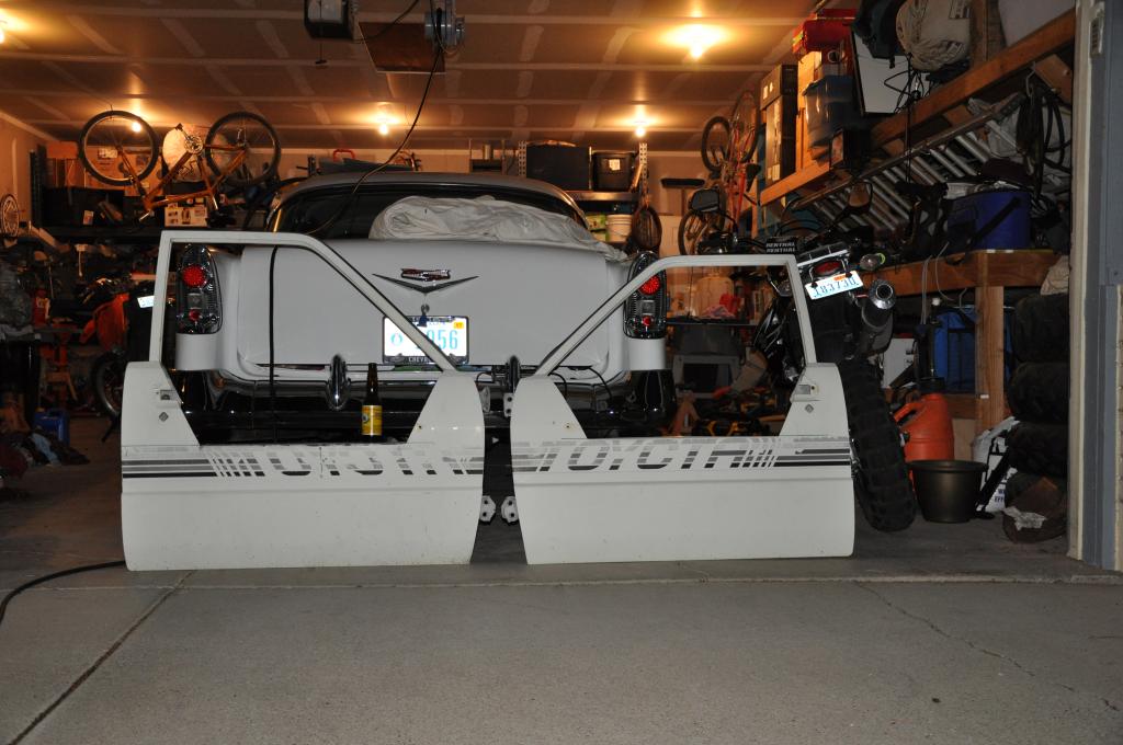

3 Attachment(s)

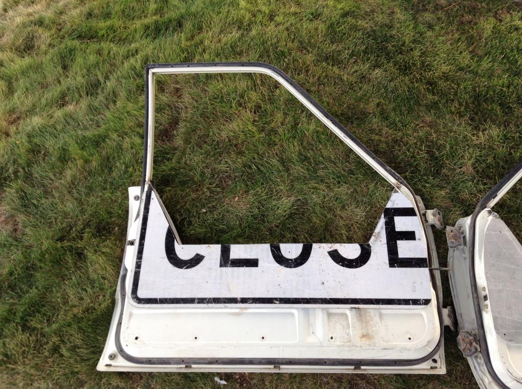

Made some decent progress today. Assembled my trans/transfer case completely, just need to fill it with gear oil. Found that my throw out bearing is too old and can't be serviced so McLeod is going to retrofit it with their newer style housing/hydraulic lines. Then I started on my half doors they are pretty fun to build, just need some thin sheet metal to finch them off then i'm making aluminum door panels and some upholstered pads for the armrest area of the half doors. Heres a couple progress pics:
Attachment 130502Attachment 130503Attachment 130504

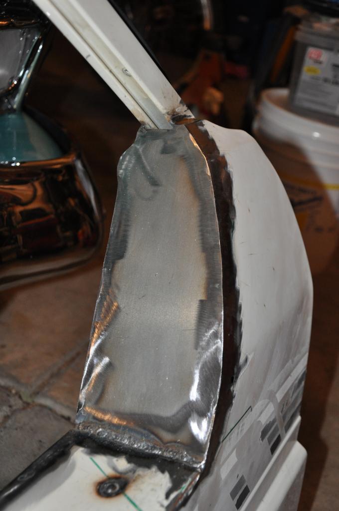

5 Attachment(s)

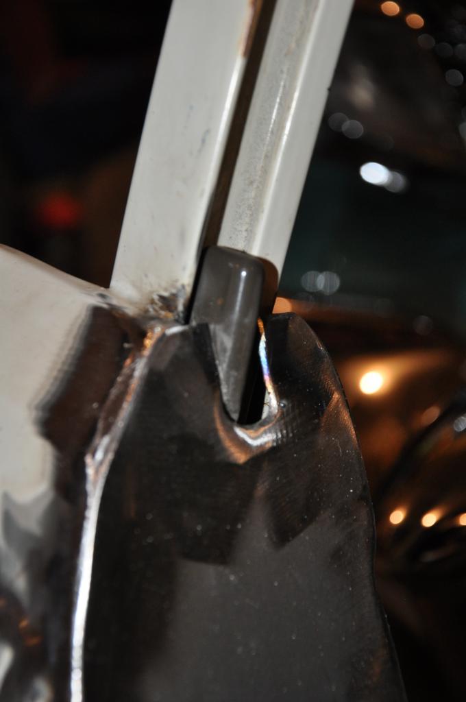

Welp here are some pictures of the small amount of fab work I got done on the doors tonight, need to still make filler pieces for where the old door handle and lock was, and cut in some holes for the cup holder. I'm pretty happy with them so far. Made the old door lock knob the new push down door opener which runs pretty much in the window channel.
Attachment 130345
Attachment 130346
Attachment 130347
Attachment 130348
Attachment 130349
Door isn't actually touching the 56 haha.

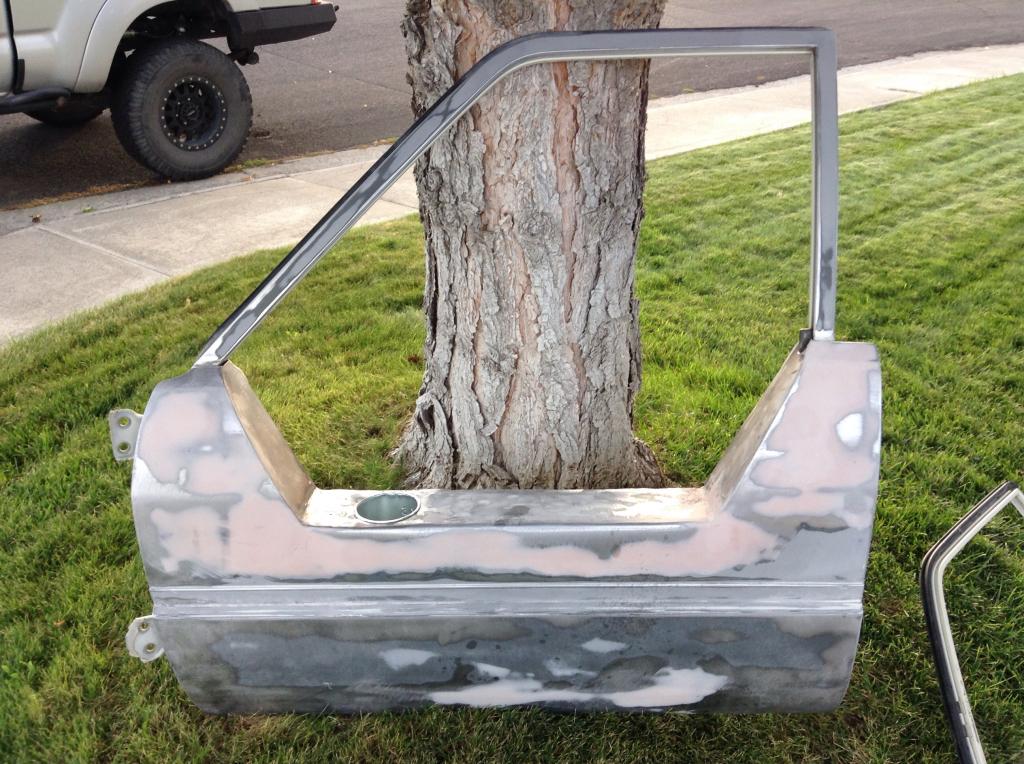

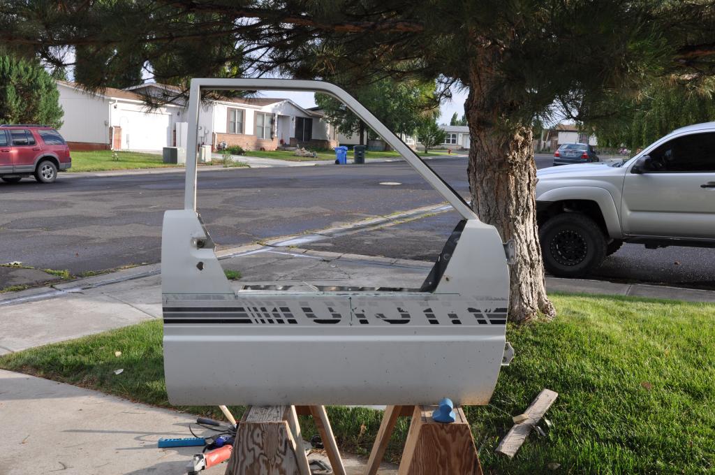

3 Attachment(s)
Did a little more work on the doors yesterday, sanding, evening them with some bondo, cut out my door panels and made some cup holders.
Attachment 129784
Attachment 129785
Attachment 129786
rustED Aug 27, 2014 08:02 AM
Turned out really nice, what did you use for the cup holder?
