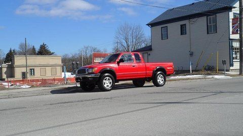

Then it was time to buy my first vehicle so I could be a functioning member of society. So I bought a 2004 TRD Tacoma. I loved it, and it really got me started as a Toyota enthusiast.

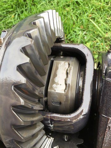

Fast forward to 3 years ago, I bought my dream, an SR5 85' 4runner, 4 inch superlift (LOL) 33 all terrains, it had 4.88s and a rear lock right locker. That is what this thread is all about. I nicknamed it Orange Saphhire after I started dating my wife, because I always joked that I would have to sell it to buy her some fancy sapphire engagement ring... I didn't have to, but we did get married.

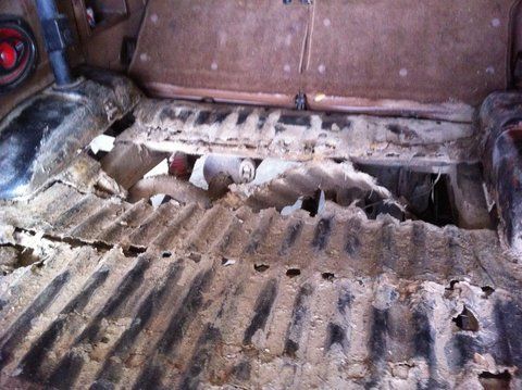

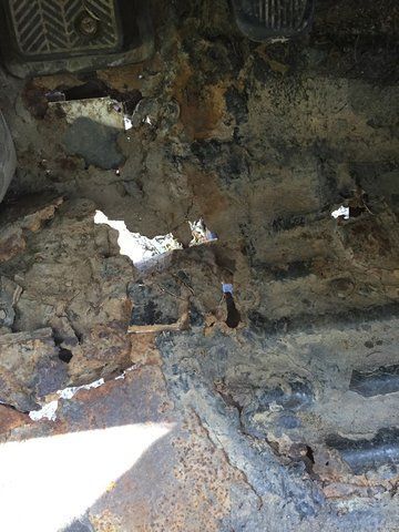

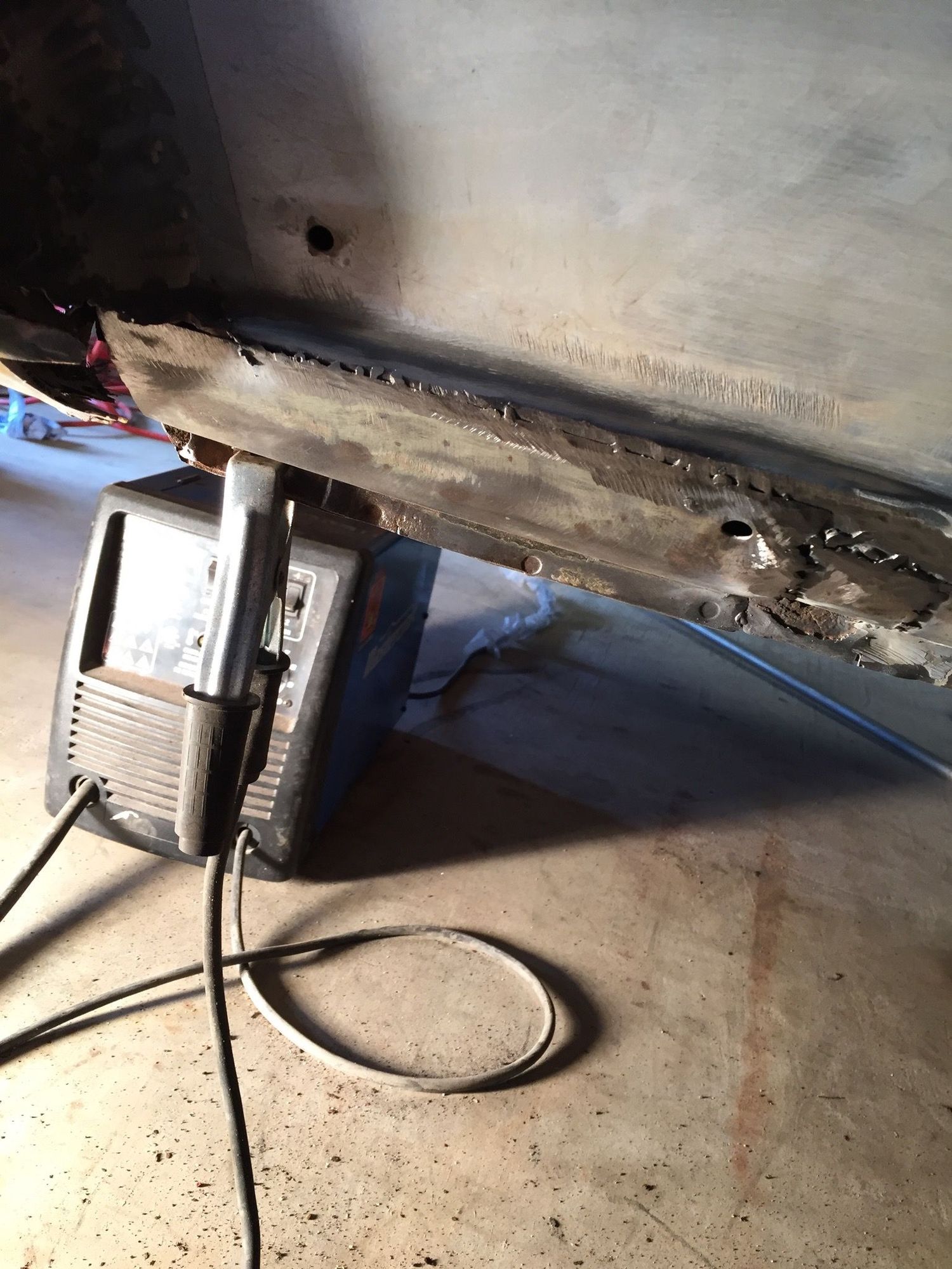

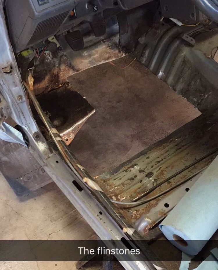

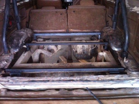

https://cimg7.ibsrv.net/gimg/www.yot...ce196d8505.jpgThis truck had 560k km's on it, being in Ontario, it was crazy rusty, more so than I thought when I bought it.
https://cimg8.ibsrv.net/gimg/www.yot...695a884141.jpg
https://cimg9.ibsrv.net/gimg/www.yot...687029185a.jpg

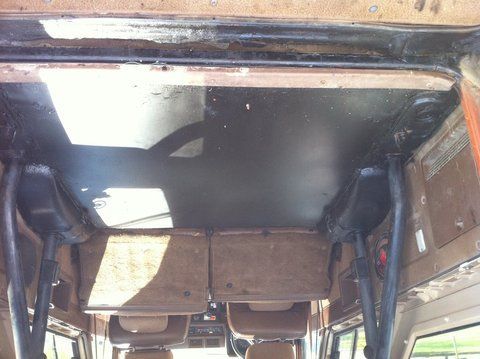

https://cimg0.ibsrv.net/gimg/www.yot...2717f0f9fc.jpgAll better, sorry upside down. I bedlined the new floor
https://cimg1.ibsrv.net/gimg/www.yot...238dcd5f5b.jpgNow the floor can support my gear, thumbs up

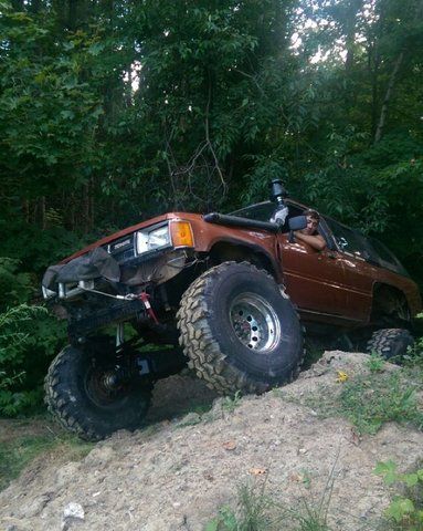

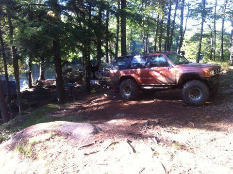

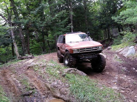

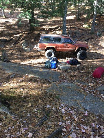

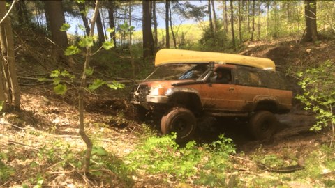

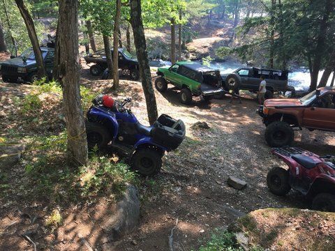

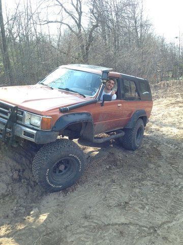

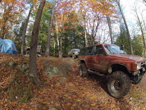

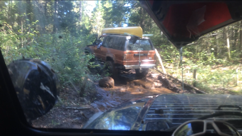

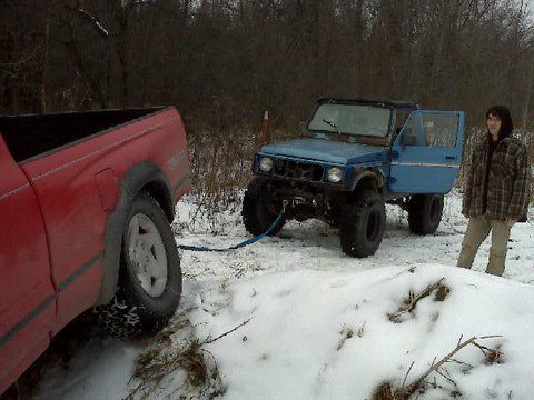

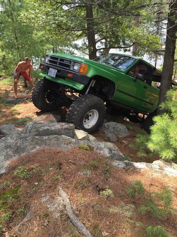

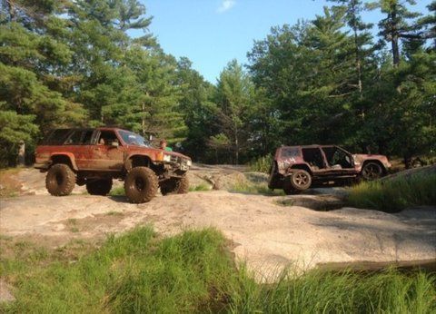

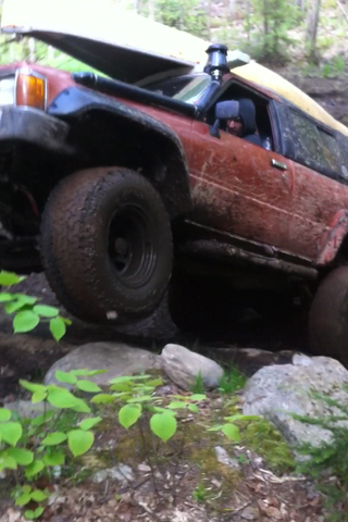

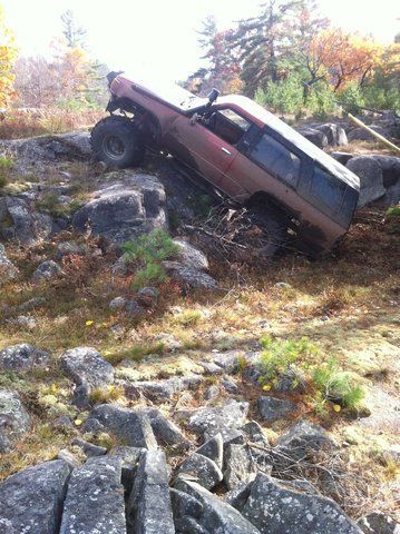

https://cimg4.ibsrv.net/gimg/www.yot...af76d9b6a6.jpgWheeled it a lot, went camping. Had a great time with my buddies

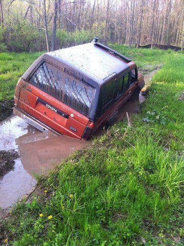

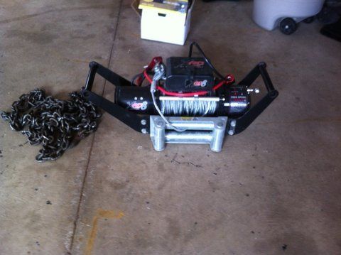

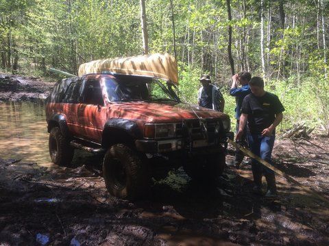

https://cimg5.ibsrv.net/gimg/www.yot...28457c85d6.jpgNeed a winched after wedging myself against some trees on a slippery trail

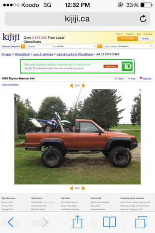

https://cimg6.ibsrv.net/gimg/www.yot...32d004d5ef.pngFound the original ad

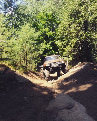

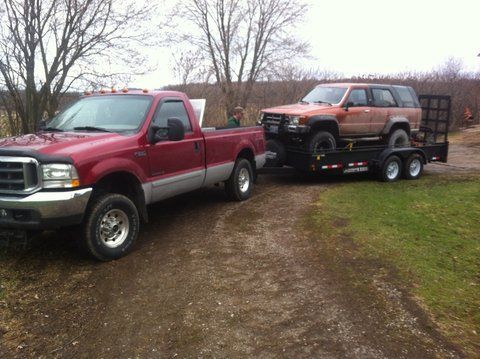

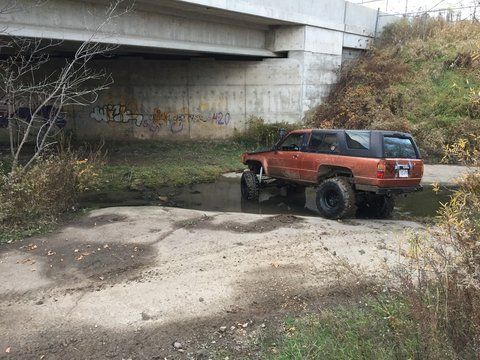

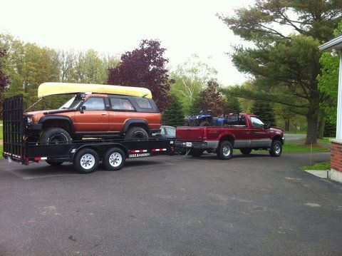

https://cimg7.ibsrv.net/gimg/www.yot...0a8a178a75.pngWheeled it all over Ontario, still trailering it everywhere

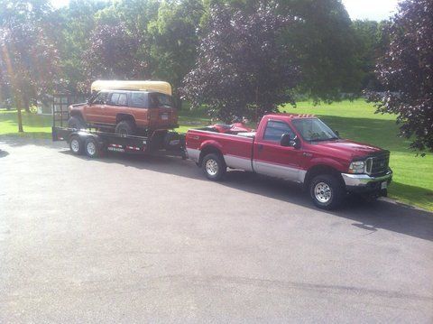

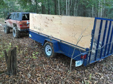

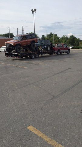

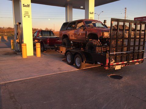

By this time I was still trailering it to go wheeling, it didn't really make sense to keep it on 33s if I was going to trailer it. I didn't like the push pull steering, I was starting to crawl more, and I wanted some more flex
Toy(Yota) Dec 23, 2017 06:20 AM

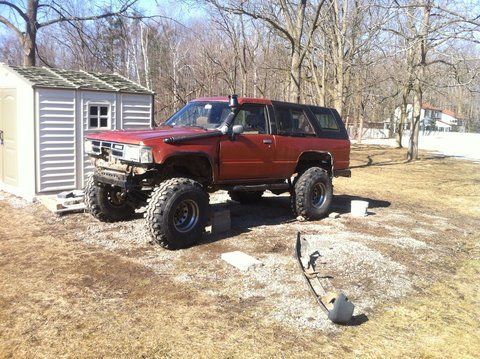

https://cimg8.ibsrv.net/gimg/www.yot...d19faf5529.jpgGot some 36 Super swampers, sold the 33s to a friend and picked up some military tires for a friends truggy project

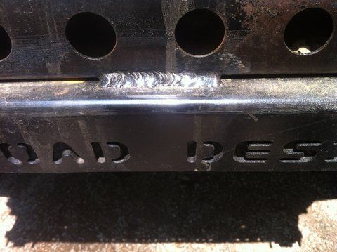

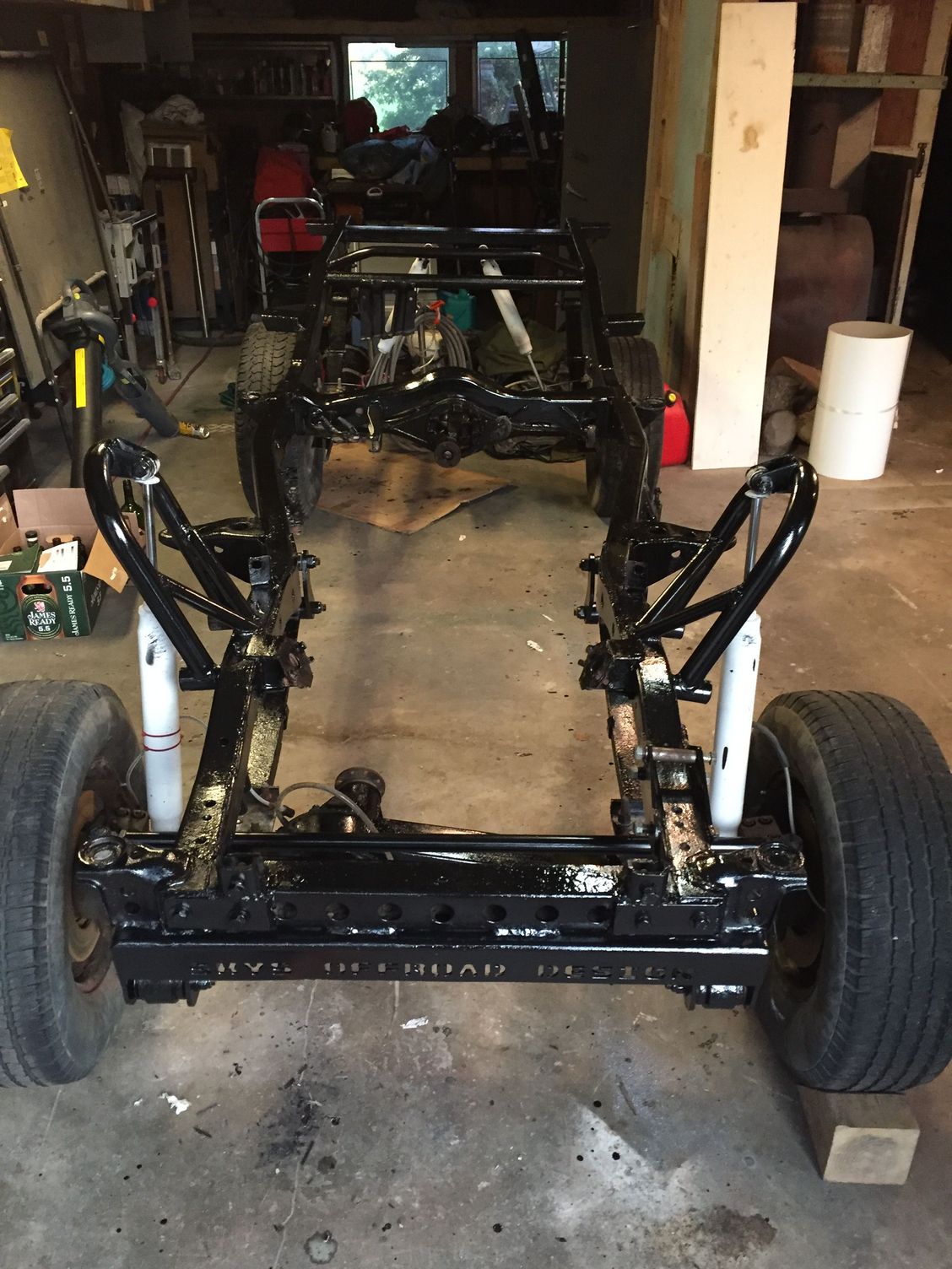

https://cimg2.ibsrv.net/gimg/www.yot...2df773d838.jpgTrussed with TG stuff
https://cimg3.ibsrv.net/gimg/www.yot...a8374341b2.jpgPainted and assembled with FJ60 rotors and v6 calipers
https://cimg0.ibsrv.net/gimg/www.yot...a74073795b.jpgWelded sky's drop hanger on the front and did RUF springs

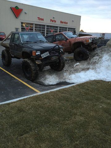

https://cimg8.ibsrv.net/gimg/www.yot...f5b80d6680.jpgI got impatient and wheeled without lifting the rear.
https://cimg9.ibsrv.net/gimg/www.yot...a2de15ec16.jpgI did end up taking one leaf out of the front

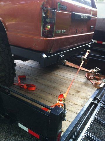

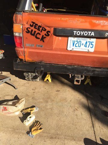

​​​​​​​Then I built a rear bumper and cut the rear spring setup off and did F150s and sky's kit and I wheeled some more

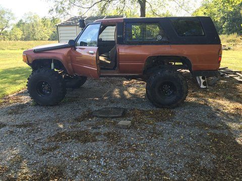

https://cimg8.ibsrv.net/gimg/www.yot...c7909cc3e9.jpgI took these pictures for a kijiji ad (like Canadian version of Craigslist) It was super rusty all over and I decided that I wanted to sell or part out and build something cleaner that I could daily drive every now again. I'm a Landscaper so my red Ford is what i drive everyday, but I figured I could drive my wheeler around on the weekends or get groceries and stuff

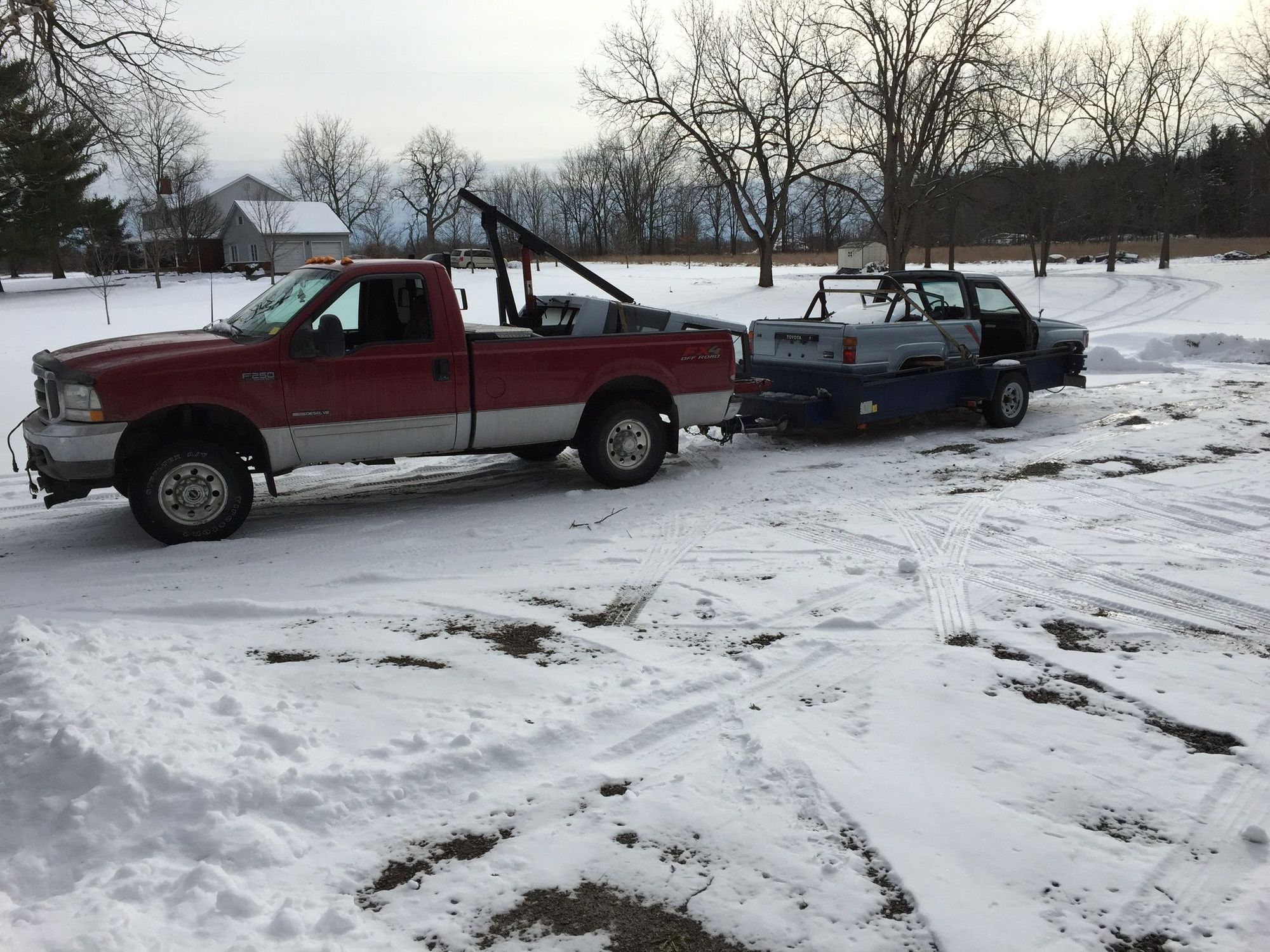

Then I realized that every time somebody inquired about my truck I would turn them away, or make excuses because I really didn't want to sell it and I knew because the body was so bad that I would never get the money I wanted.

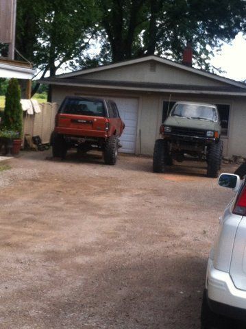

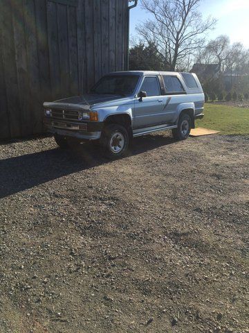

https://cimg5.ibsrv.net/gimg/www.yot...874f7bc1a4.jpgSo I bought this instead. 88' base model. Decent body, blown 22re, good top, OK interior.
https://cimg6.ibsrv.net/gimg/www.yot...a35071f412.jpg
https://cimg7.ibsrv.net/gimg/www.yot...3c7057cab6.jpg

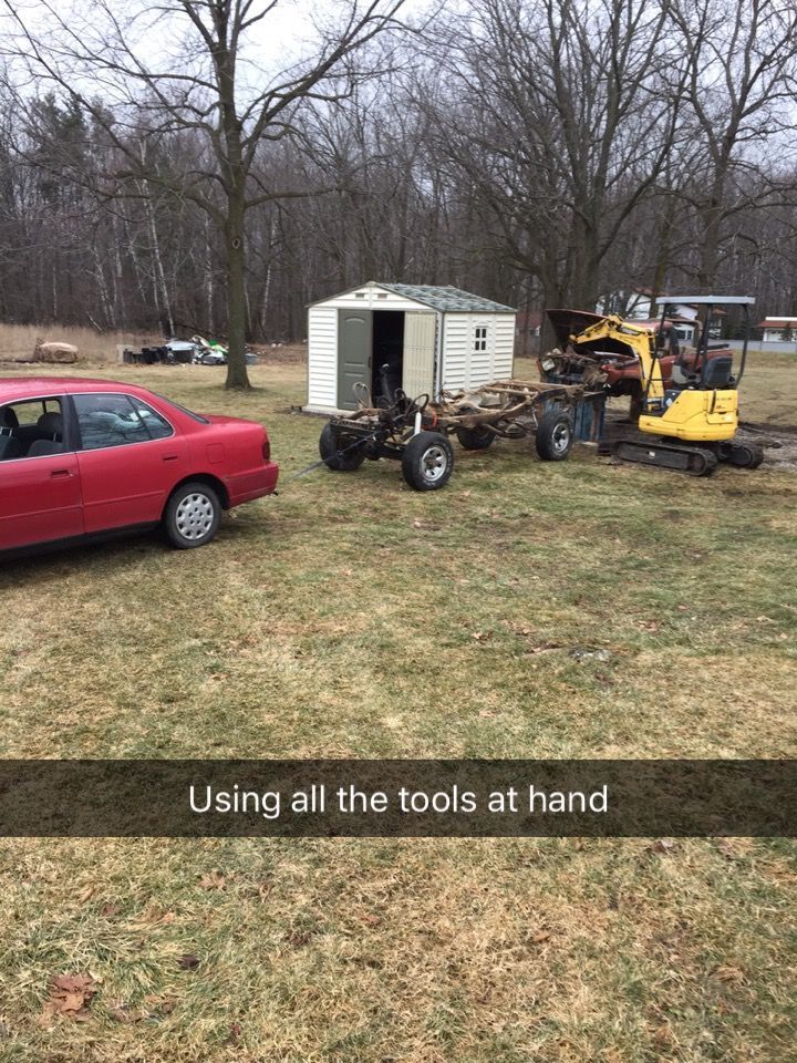

Sorry I forgot to post the rest of progress. Plan is body swap, new 22re, TG skid plate and TG bumper, and custom rear tire carrier. Here's some pics.
Toy(Yota) Jan 4, 2018 07:38 PM

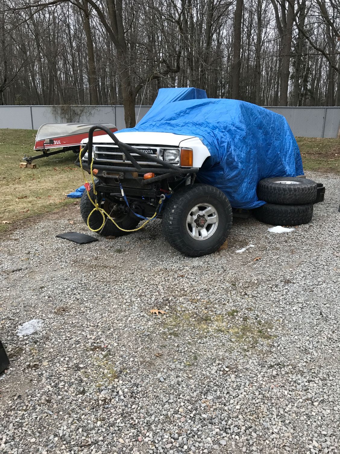

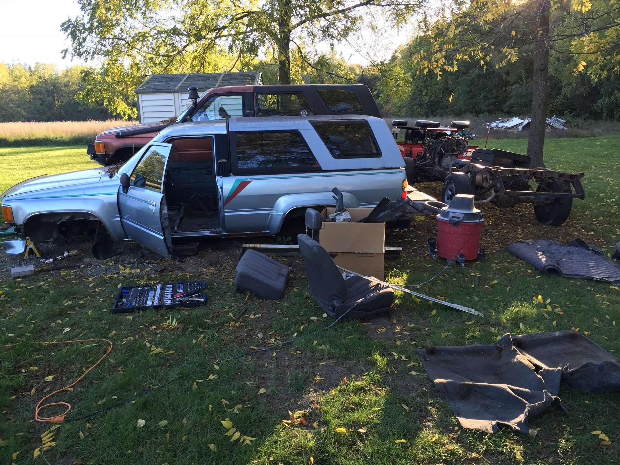

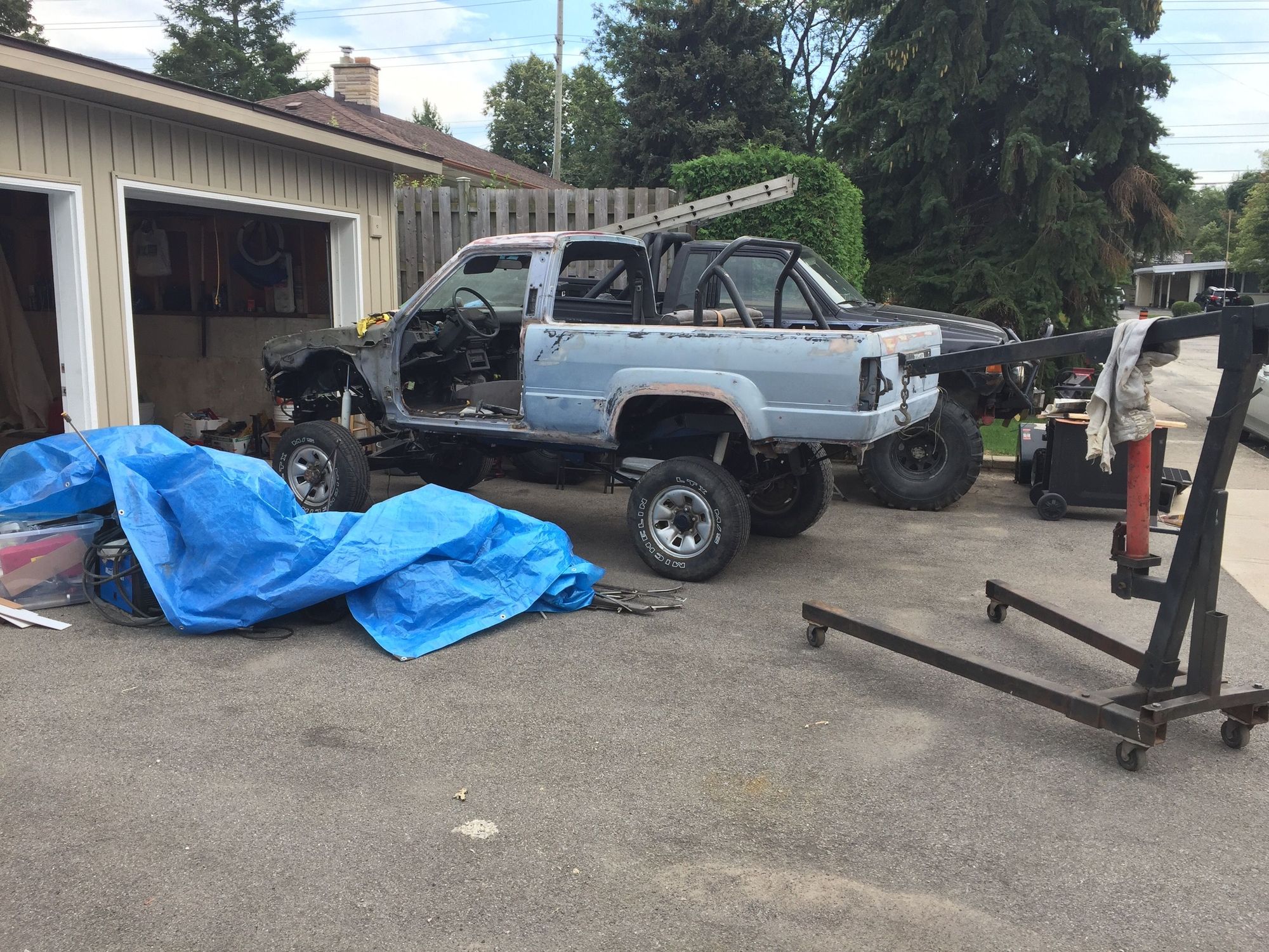

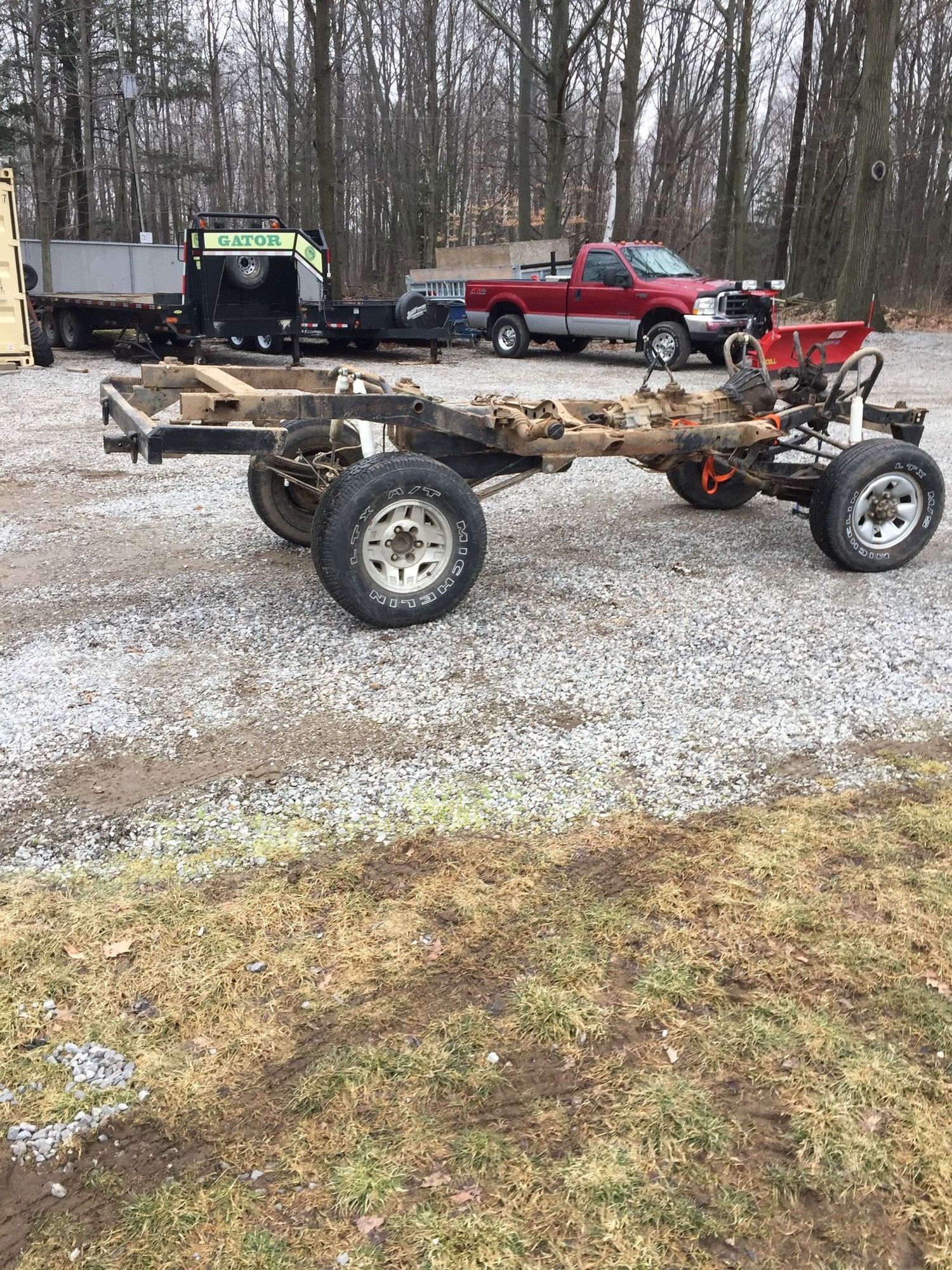

https://cimg3.ibsrv.net/gimg/www.yot...08e38f377b.jpgBody pulled off with mini ex and engine hoist
https://cimg4.ibsrv.net/gimg/www.yot...bb96fbc964.jpg
https://cimg5.ibsrv.net/gimg/www.yot...be0ac3f601.jpgSanding
https://cimg6.ibsrv.net/gimg/www.yot...68c71af0f0.jpg

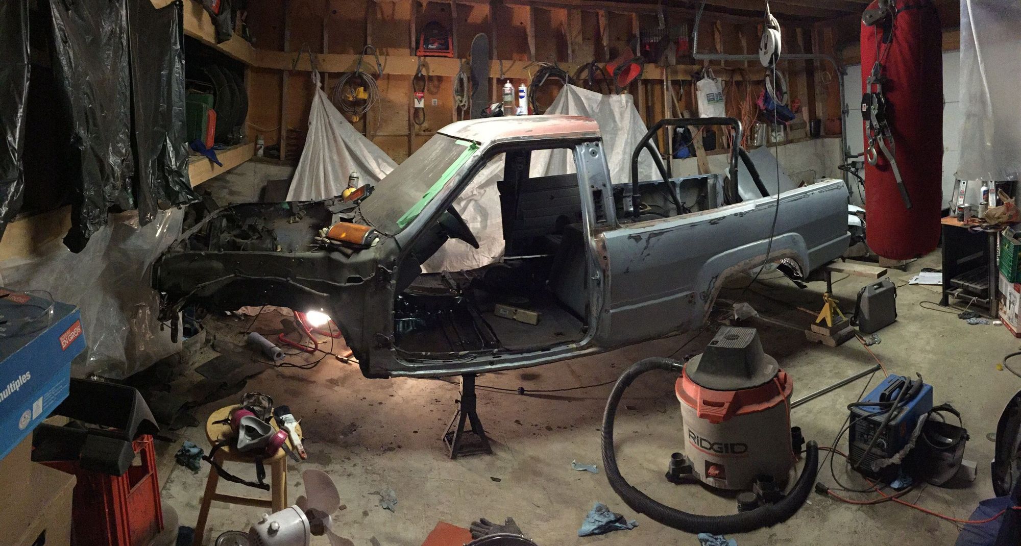

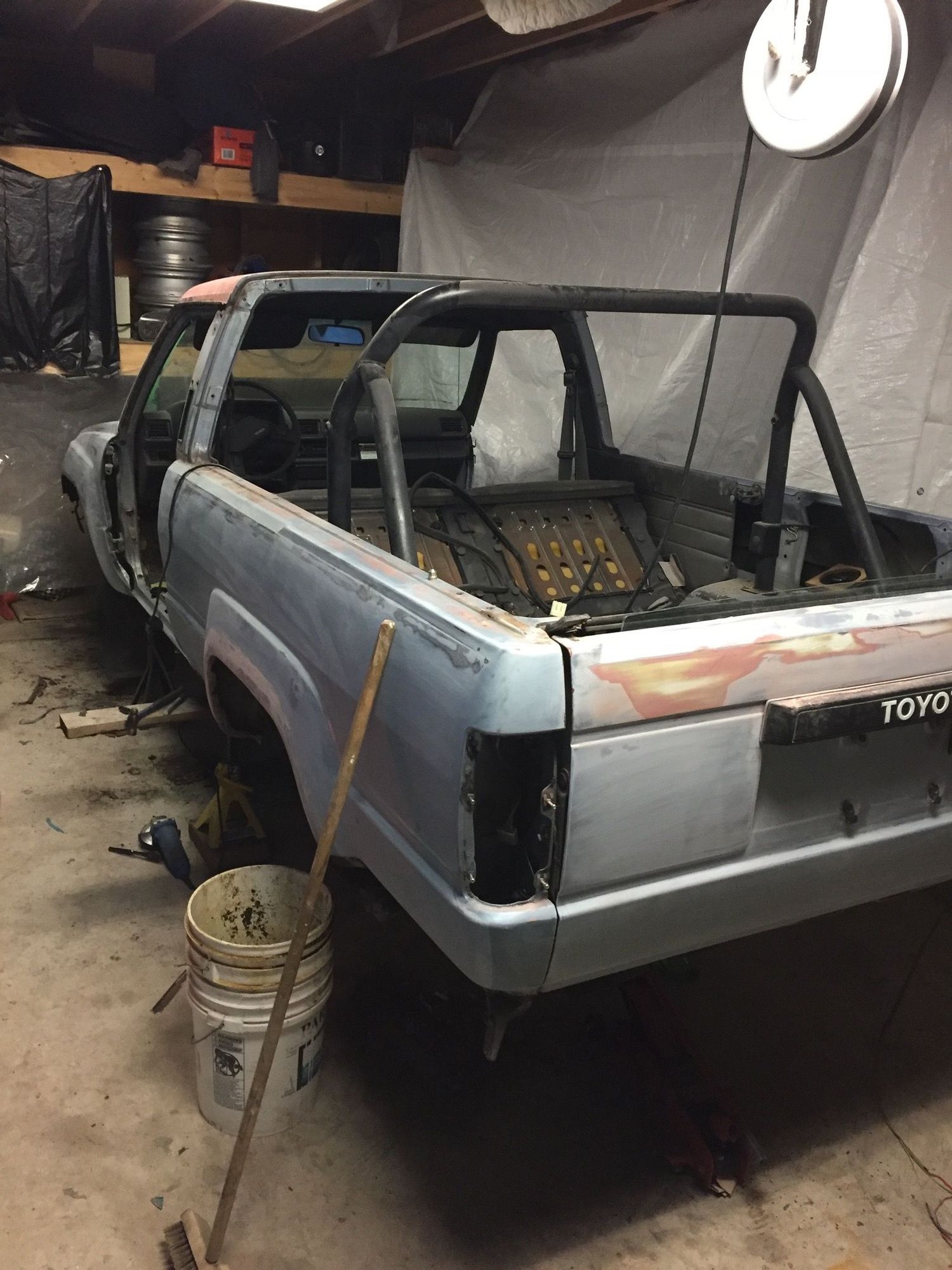

https://cimg7.ibsrv.net/gimg/www.yot...3ffcb1657d.jpgFloor was rotten which sucked
https://cimg8.ibsrv.net/gimg/www.yot...57cba74fb2.jpg
https://cimg9.ibsrv.net/gimg/www.yot...d96d41b92a.jpg

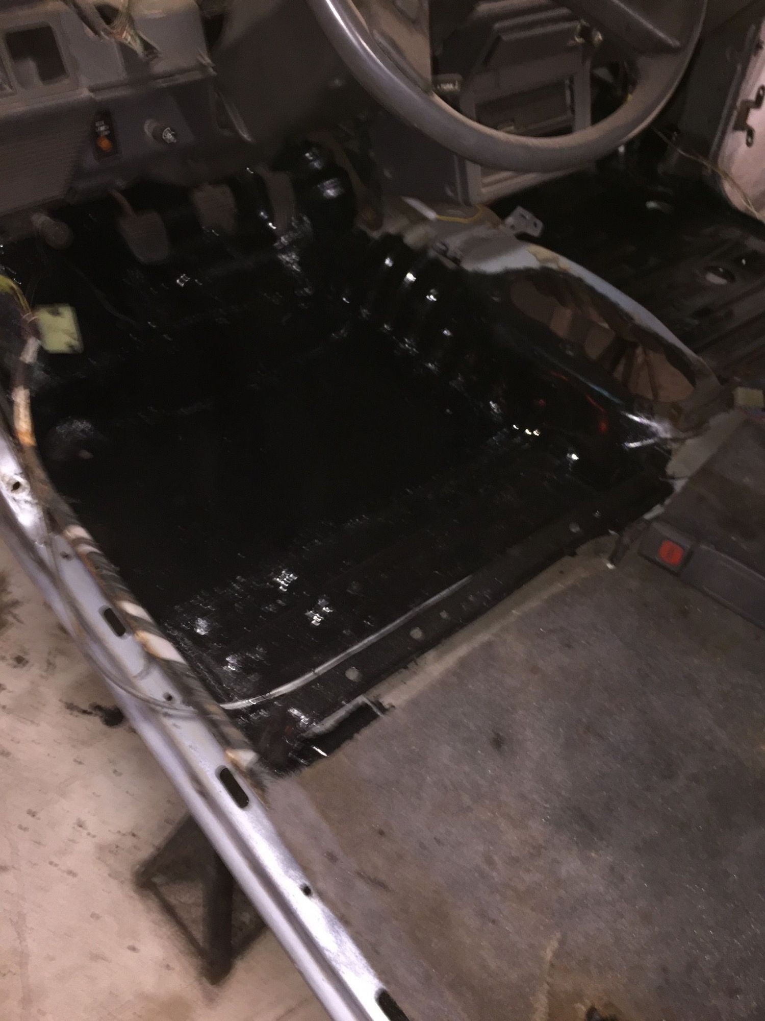

https://cimg0.ibsrv.net/gimg/www.yot...15b1bf6028.jpgAll fixed with por15
https://cimg1.ibsrv.net/gimg/www.yot...b6d4761d58.jpgStripped

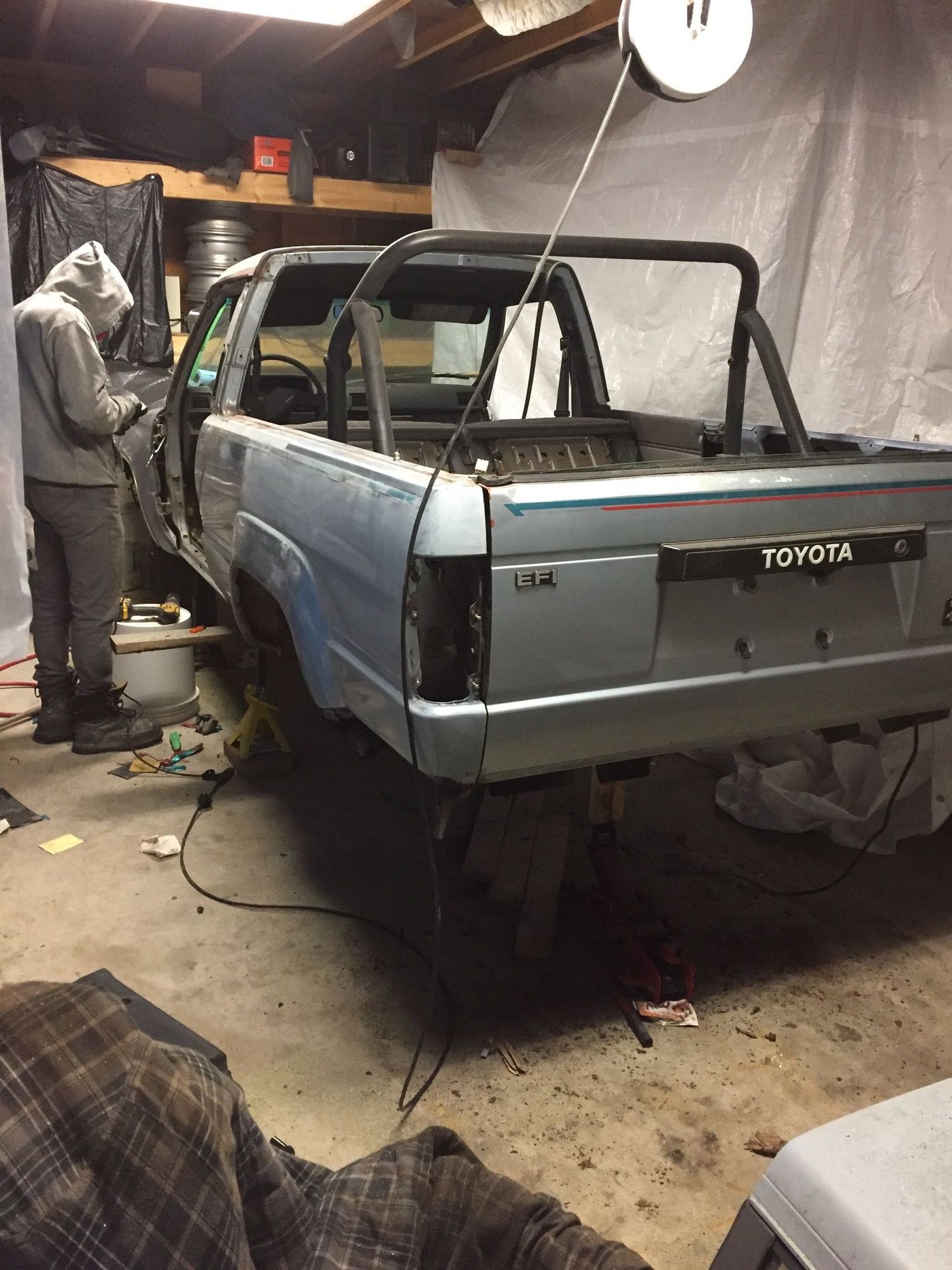

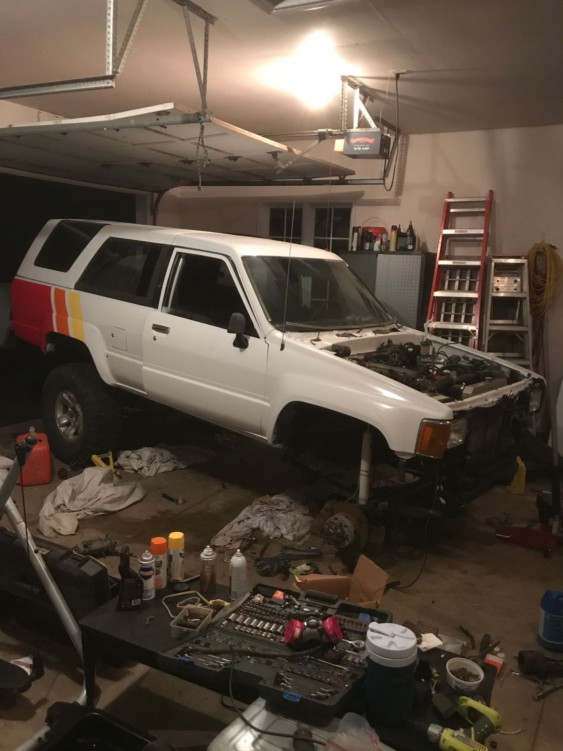

The day I got the 88 body on the 85 frame. I was worried about this part, because I don't have a hoist, and the body was at my friends shop where I don't have any of my heavy equipment. Ended up using an engine house and ratchet strapping from the roll bar up to the ceiling joists in his garage.
Once I got it to this point, progress went a little faster. It was a year working on it up to this point and it was driving me nuts that it wasn't near to be done.
I freshened up the 87' 22re over the winter, had an Sr5 gauge cluster to go in it. Then I stumbled upon a TG front bumper and dual skid plate, a used high steer and a set of solid axles. Parted out what I didn't need and kept the rest.

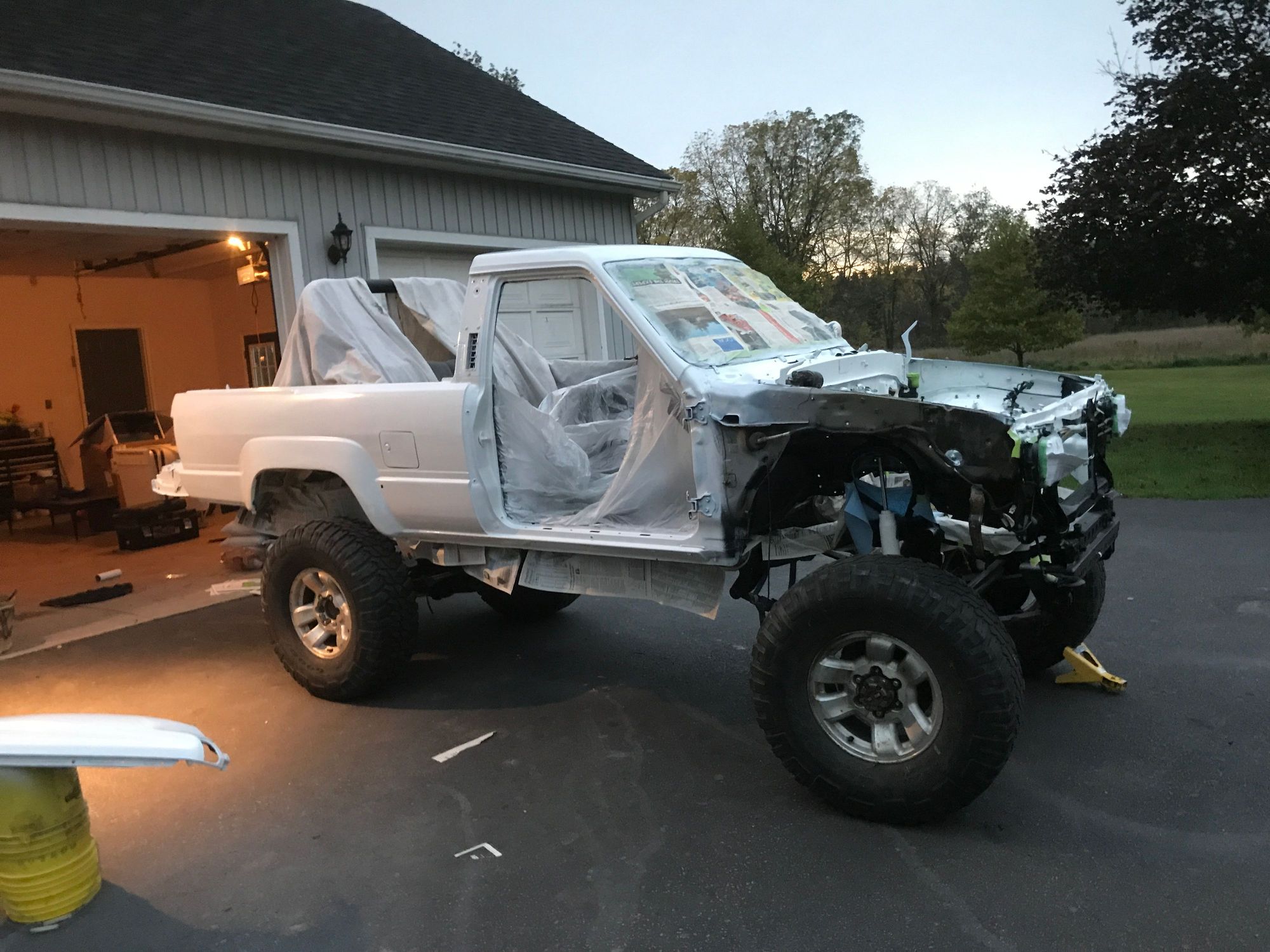

https://cimg1.ibsrv.net/gimg/www.yot...7b3aa05fc5.jpgGot these 35" old style MTRson Tacoma rims. And first coat of primer!

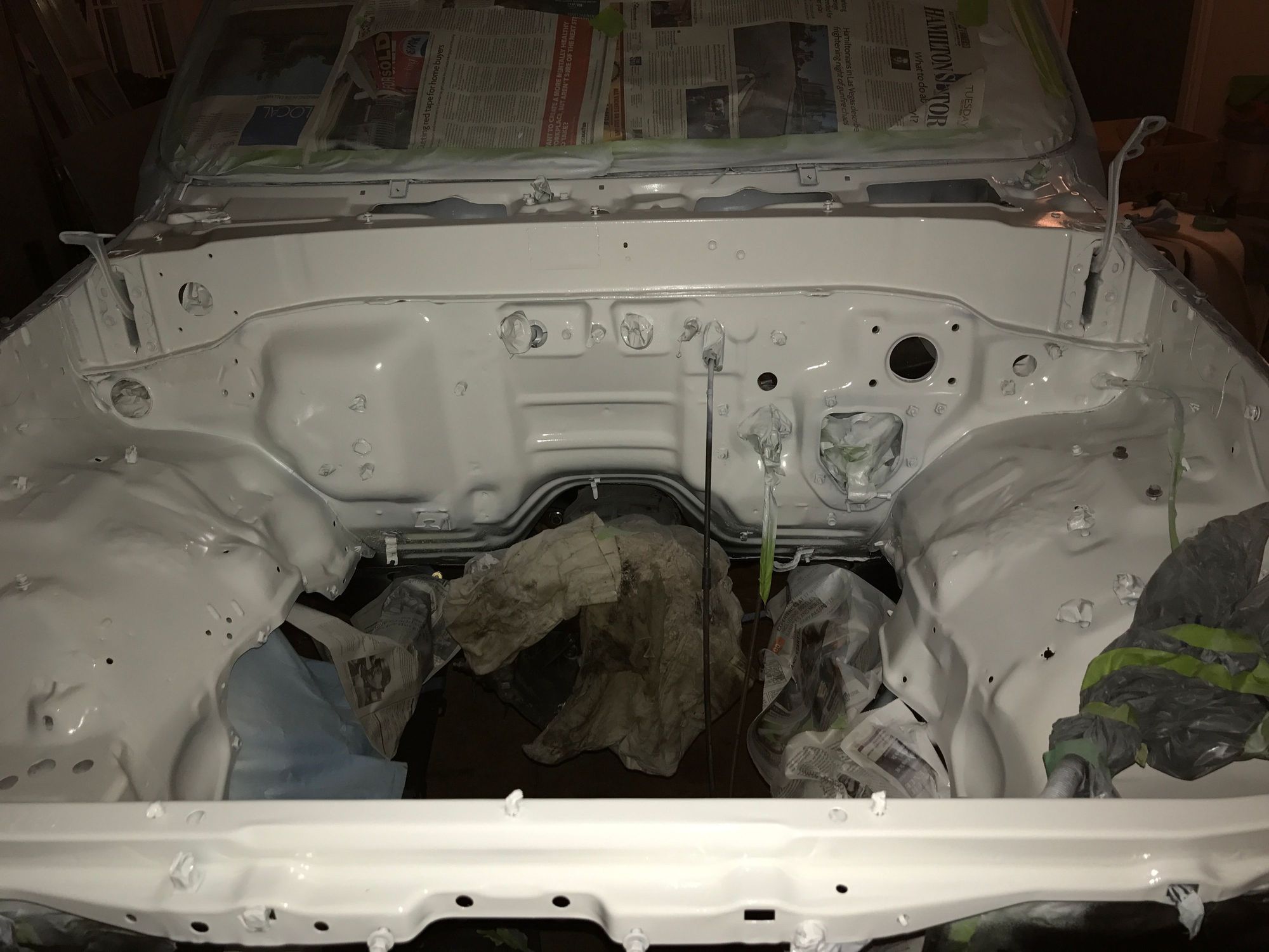

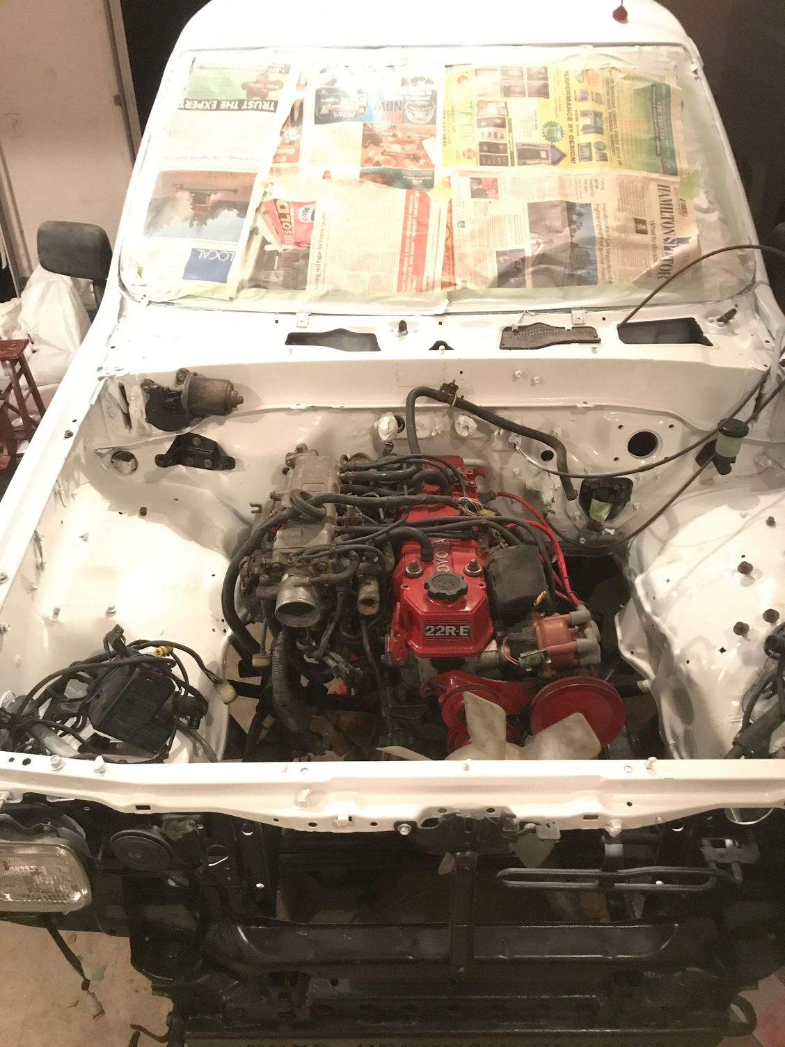

https://cimg2.ibsrv.net/gimg/www.yot...dfe9b36617.jpgEngine bay painted
https://cimg4.ibsrv.net/gimg/www.yot...2c0a8d8dff.jpgFirst base coat
https://cimg5.ibsrv.net/gimg/www.yot...93256c147d.jpgFinal basecoat and taped off for the SR5 stripes
https://cimg7.ibsrv.net/gimg/www.yot...11afde2843.jpg
https://cimg9.ibsrv.net/gimg/www.yot...2833447bb3.jpgFinal product after painting the top. Definitely not professional, but easy to touch up and should look good in the meantime

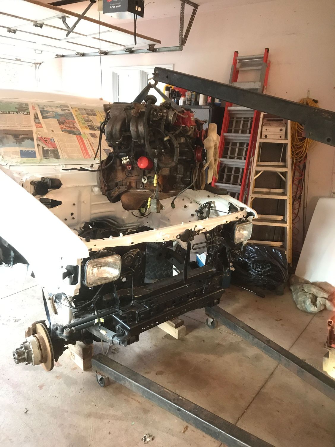

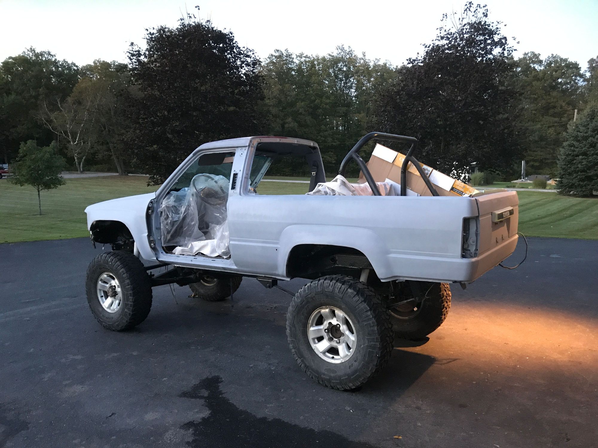

https://cimg7.ibsrv.net/gimg/www.yot...4479390a3b.jpgOnce it dried I stabbed the 22re back in
https://cimg0.ibsrv.net/gimg/www.yot...9c5f488aee.jpgHappy to be home
https://cimg1.ibsrv.net/gimg/www.yot...697abb232e.jpgTough to get a lifted vehicle low enough to get the motor over the core support
https://cimg5.ibsrv.net/gimg/www.yot...bc470c02ec.jpgThen the weather got cold

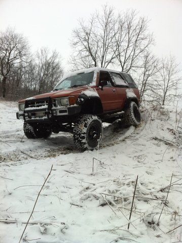

https://cimg0.ibsrv.net/gimg/www.yot...4345cd5e5c.jpgHow it sits today except it's buried in 2 feet of snow

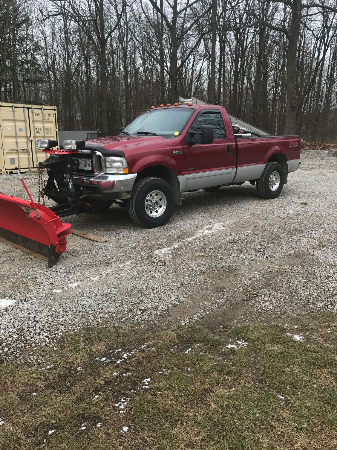

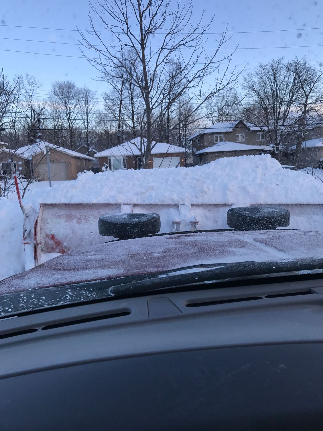

https://cimg3.ibsrv.net/gimg/www.yot...420f60467a.jpgWork truck ready for snow

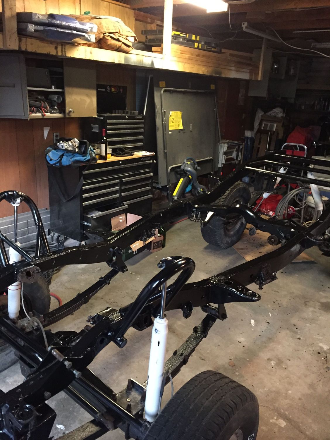

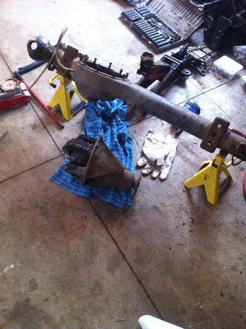

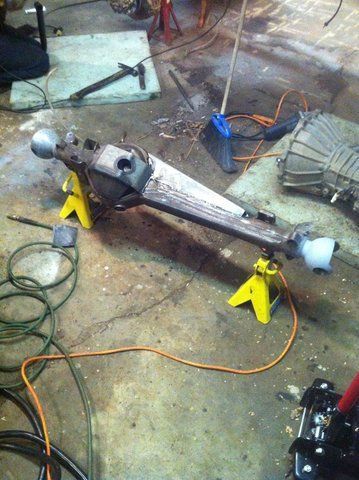

Sandblasted and POR15 on the backing plate and IFS width rear axle. Finally got the axle back under it. Now I can bring up into the shop and start going on the rest of it. To do list for anyone who cares:
1. Axle back in and tires on ✔️
2. Find leak in cooling system
3. Water pump and gasket
4. Clutch adjustment
5. Ebrake and all brake lines
6. Fan resistor
7. Gauge Cluster fix temp gauge (tighten small screws behind the circuit board
8. New front axle seals and backing plate Eliminator kit, repack birfields
9. Diff fluid F/R
10. Wildwood brake proportioning valve
11. Install Steering stabilizer and new pitman arm
12. Figure out rear window electrical
13. Install Cb
To weld:
1. Bump stops
2. Rock Sliders
3. Winch hook
4. Mounting Tabs for hi lift and spare driveshaft on rear rollcage
5. Build rear bumper and tire carrier
