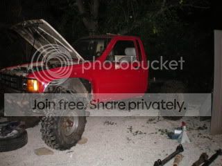

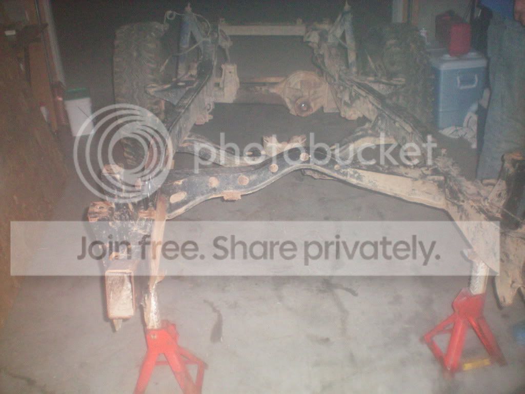

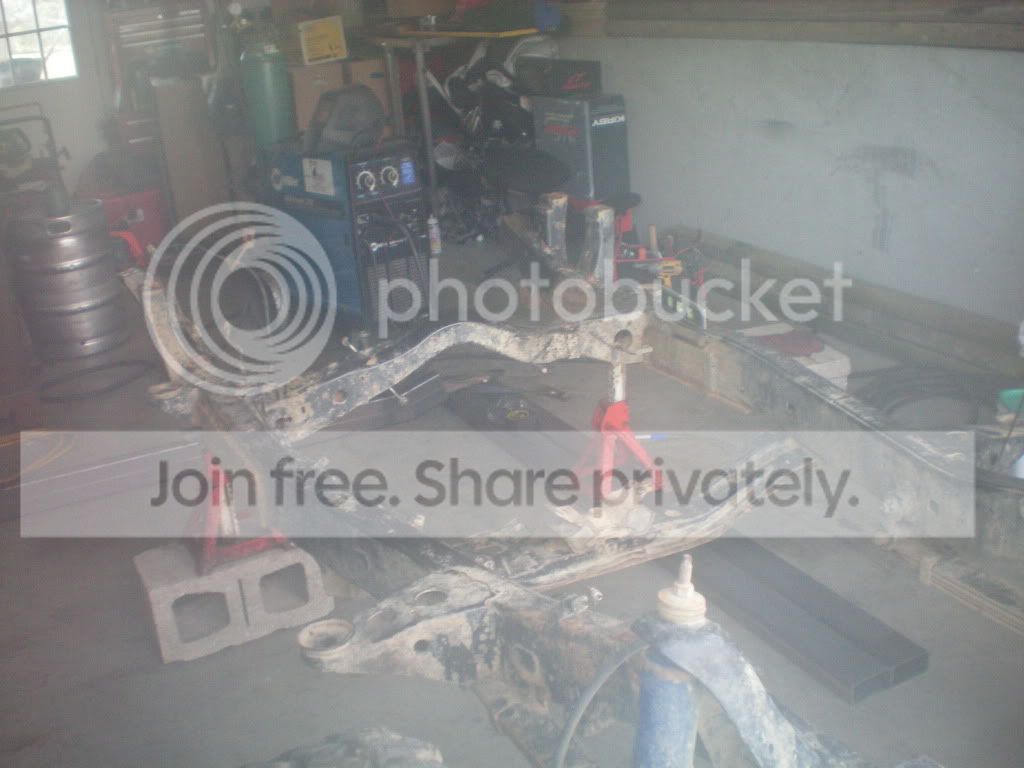

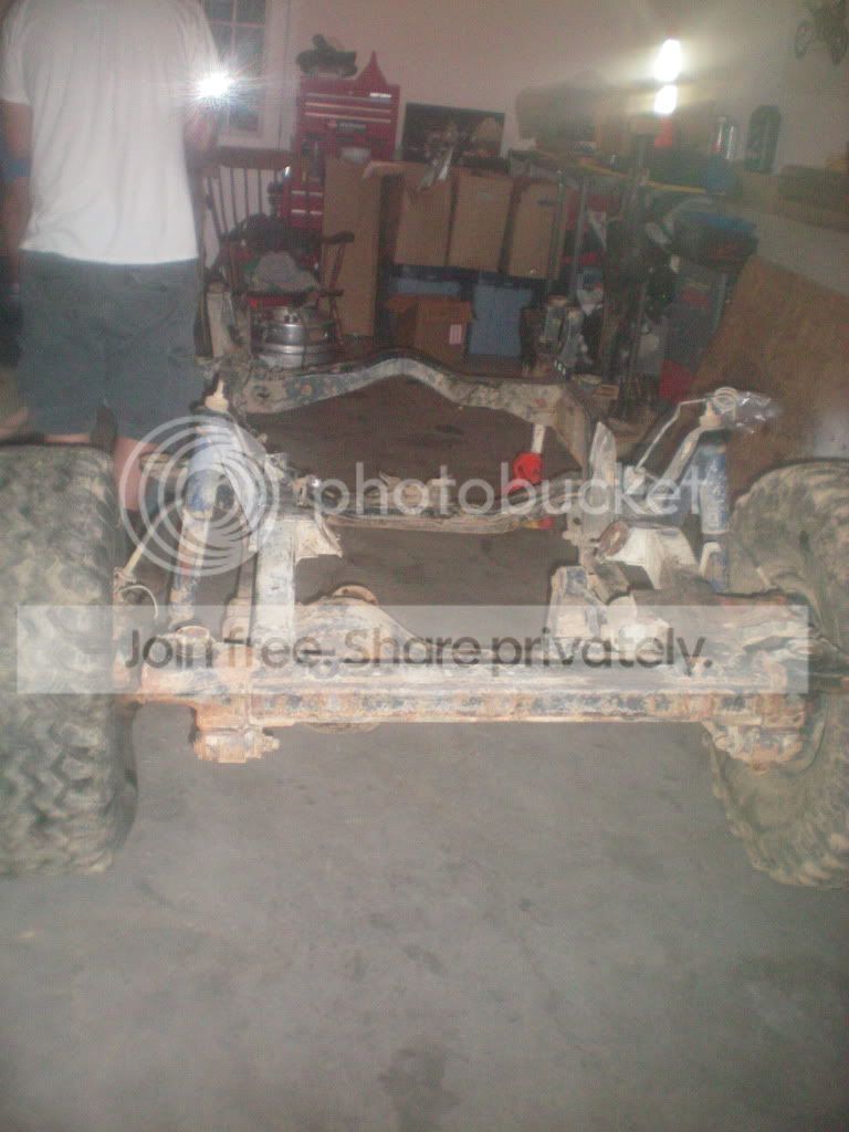

Started with this
And got to this

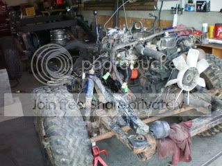

Motor and tranny in
Rear end is good you can see that in last pic

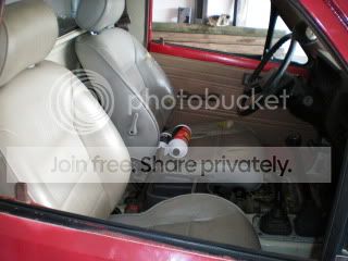

Cab on with doors fenders and grill the cab is off an 86 bought it all seperate pretty much
Anyone know where these seats came from? I do and they are way better then that bench seat

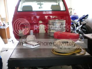

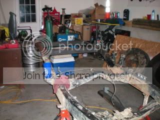

And my flat bed with my keg for fuel

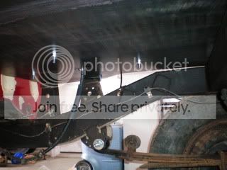

the feed for the fuel getting a inline fuel pump here soon

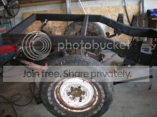

With the way I built the back 1/4 of the frame it gave me lift so the front sits too low, I am doing the RUF swap when I get my high steer kit and u bolt flip kit in the mail hopefully this week. After that I am planning on caging it but not sure if I should do it before or after tires. Plan on 35x14.50 rear and 35x12.50 front I live where there aren't many rocks to crawl so not really sure about tire size and all just yet and gears either. Stay tuned she isn't near done.

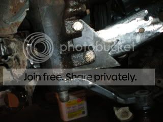

here is a good example of mounting the box...which I had seen this before I did mine, my angle looks like crap
Originally Posted by waskillywabbit
The IFS box mount is pretty simple. Cut the fender well so you can easily access the PS box area like shown in my pictures posted already and then push the box all the way forward until it is on the core. Angle it so the holes line up on the frame in the center and then test fit your mounting plates. Tack weld and test fit again to make sure the pitman arm clears and weld out.
what you don't want to have happen when you install your high steer:
Originally Posted by 98taco4x
oh and make sure that your drag link clears your tierod.
Cause you don't want this.

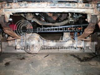

Okay so I have ruf done I have longer rears in back installed. High steer kit installed u-bolt flip kit installed. I have a question though. I need to know which plug on the pump and the box is the high pressure lines? It would be way easier to have someone let me know over installing and having them be wrong and taking it all back apart.

with the steering gear installed there are the two ports, one sitting a little closer to the input splines and inboard, and the second is a little farther down the steering gear and outboard. the outboard one is the high pressure port.

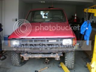

Hi steer installed
The way she sits not with some 36s on her

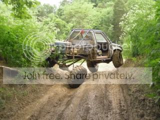

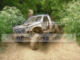

Wow so I haven't been on here in forever but the truck has definately changed a lot so here are a couple poser shots in the same spot I last took a flex picture.

By the way, guessing those r Explorer seats. Maybe. Also would like to c pics of your rear suspension. Thanks

Answer: No I did not move my spring hangers for front leaf springs. High steer I went with trail gear althought I am about to be selling that and ordering full hydro next week and linking the front starting in two weeks. RUF is rears up front take stock toyota springs and I added two more leafs(cut down) and through them in the front. Adds small lift and flexes decent. Yes the f150 springs were for more flex and so I could keep my deparcher angle.
