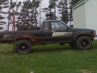

Attachment 158823

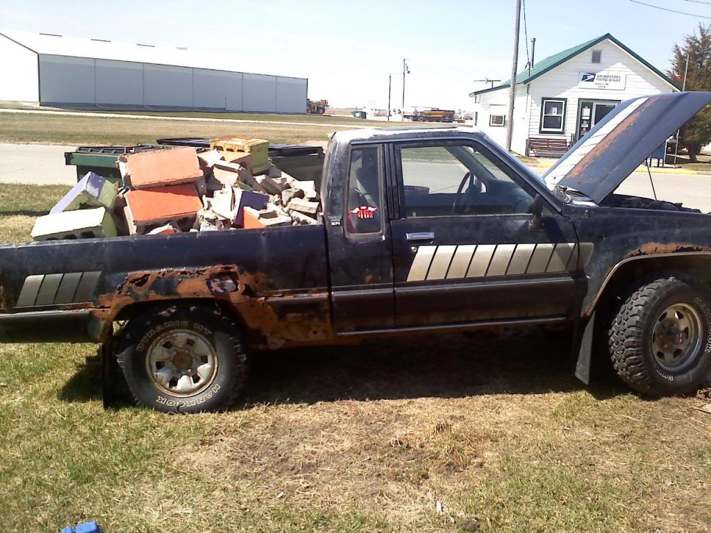

This is what I saw when I went to pick it up :( I had to unload all the junk in the back into another truck b4 I could drive it home. And let me tell ya it was an interesting drive. It would spit and sputter intermittently. Later I found out that the gas tank had a hole in it, the pass front brake line was leaking, and the e-brake was stuck on.

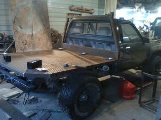

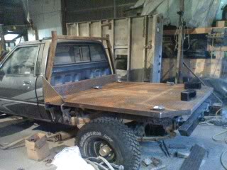

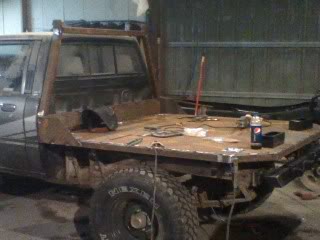

Here's a few pics of my parts truck. Also these are the only pics I have of the flatbed I built. Sorry bout the pics, all of them are from my cell phone.
Attachment 158822

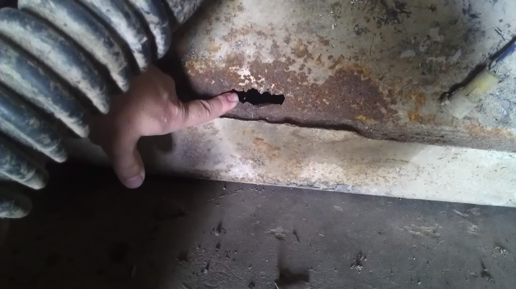

Here's a shot of the hole in the old gas tank.
Attachment 158816

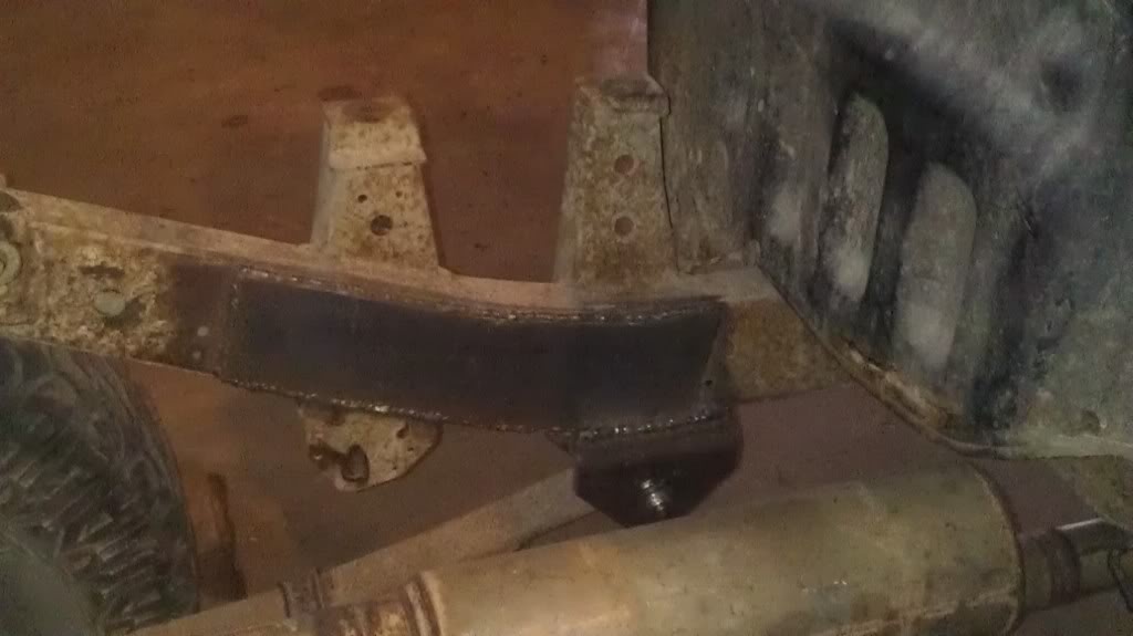

This is where I patched the frame on the driver's side, it didn't have any holes thru yet but the pass side did and I figured I would make them match.
Attachment 158815

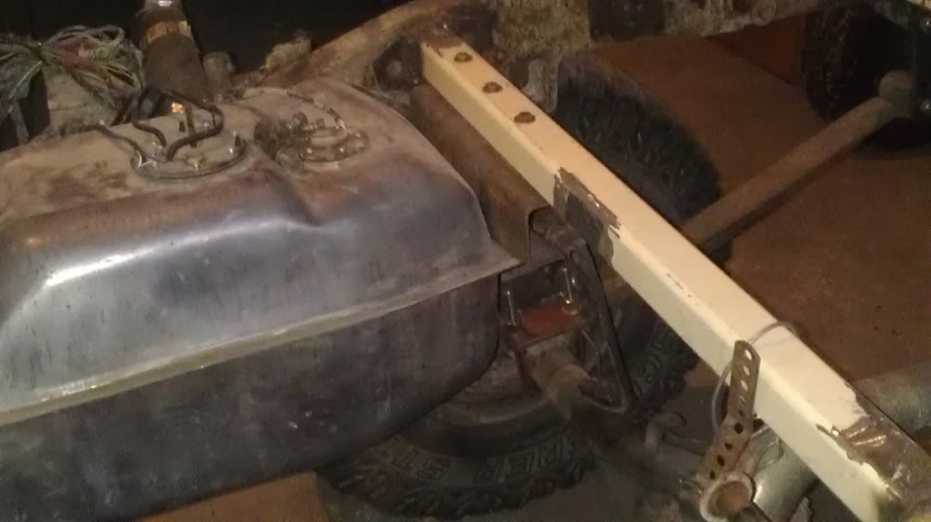

1 Attachment(s)

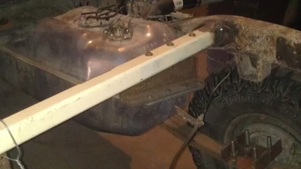

Here's the new tank installed and u can kinda see the bracket I fabbed up to mount it to the new crossmember I welded in.

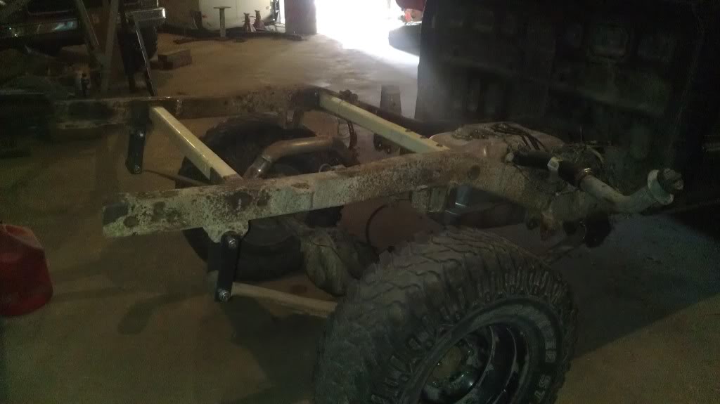

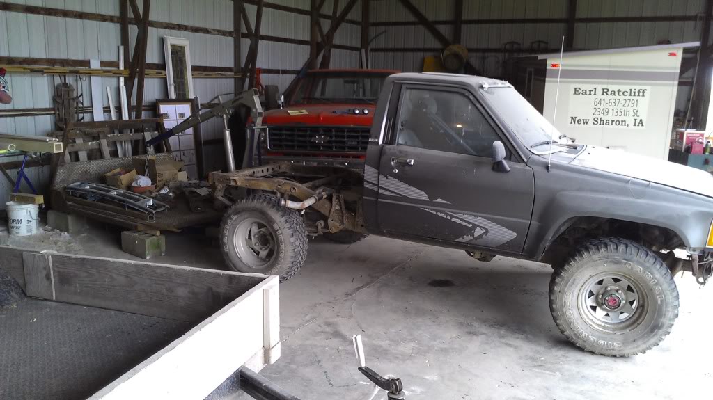

This is a pic of the rear frame. You can see I replaced both crossmembers and I have the ford springs installed here.
Attachment 158812

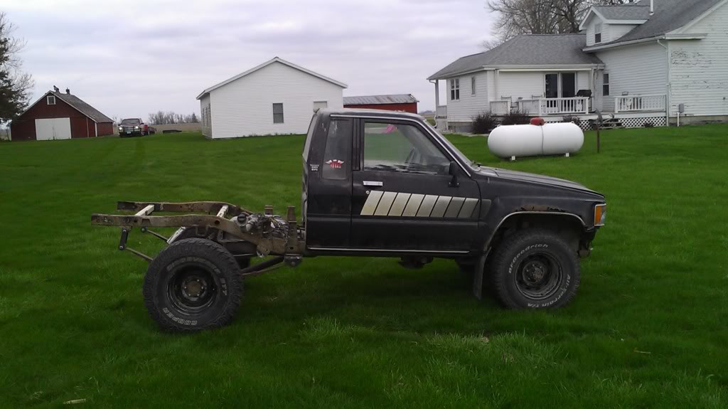

1 Attachment(s)
This is the truck a couple weeks after I got it home. The wheels are Chevy rally wheels painted black. The center hole wasn't big enuf to fit over the front hubs so I cut them out bigger with the plasma torch. Fit perfectly now and I like the look.

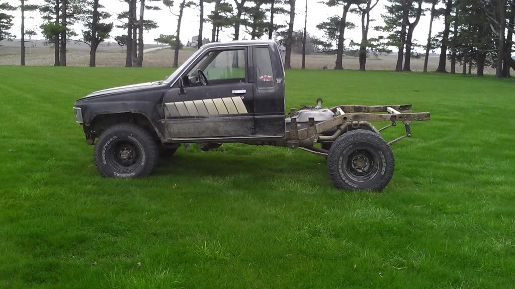

1 Attachment(s)

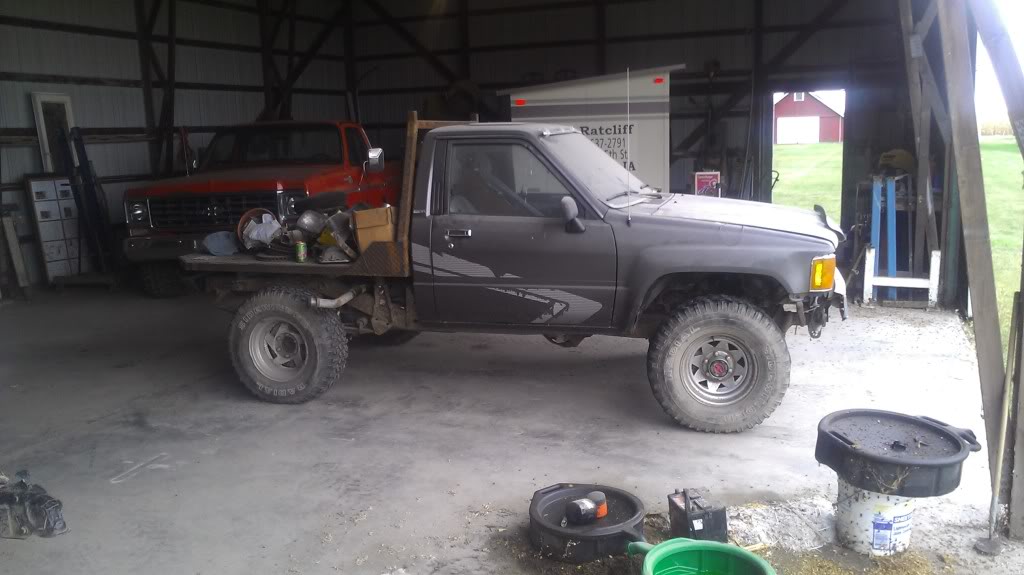

This is how the truck currently sits with the ford springs on the back.
Attachment 158809

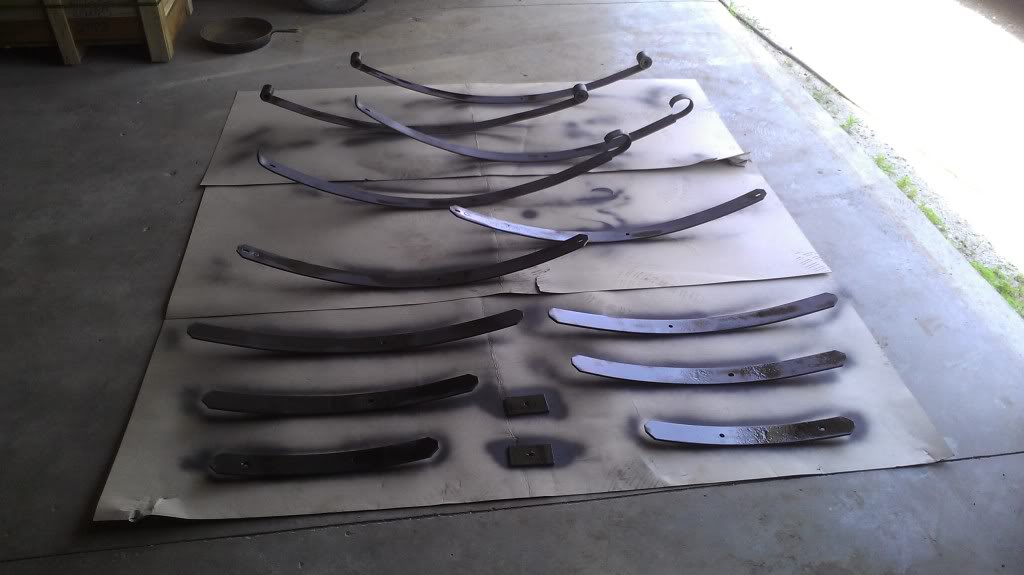

Here's my ruf packs. I cleaned them up with a wire brush on my grinder and gave them a coat of rust converting paint. Attachment 158807

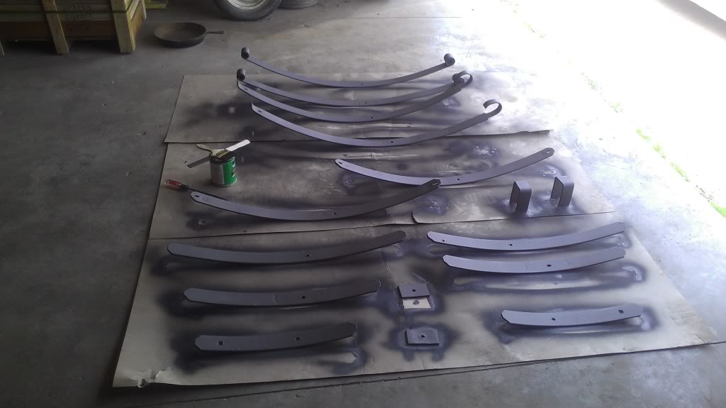

Here's where things get a lil interesting, I thought I would try painting the leaves with EZ-SLIDE. Its a graphite based paint that is used for painting the inside of gravity wagons and other agricultural equipment. My hope is that it will help the springs flex a lil easier and keep them from squeaking.
Attachment 158806
85sr5excab Jun 21, 2013 07:46 AM
1 Attachment(s)
Got em all painted
