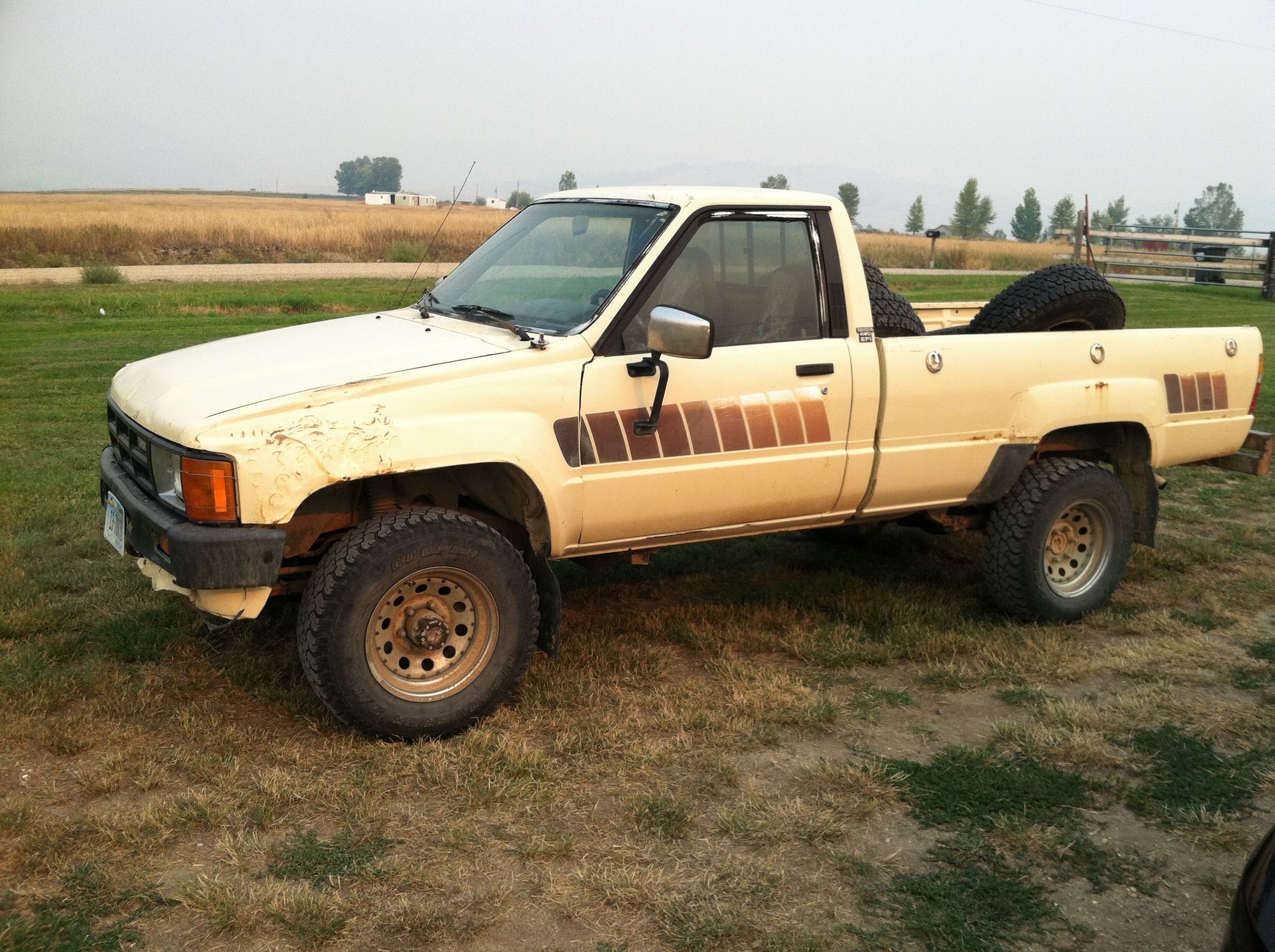

So my 4runner was in the shop. This 85 22re longbed came up on craigslist. I needed a beater and i love projects so... I now own this 1985 Toyota sr5 pickup. 22re, SFA, longbed. Not bad!
I like the solid axle and 22re combo and i don't even mind the long bed. I have some ideas for this thing and how i can use it. More of a trail rig with some crawling ability rather than crawl first kind of thing. No bed chopping or any of that...yet! Trying for a rig that's capable, solid, low/medium height suspension, 32s or 33s are fine around my neck of the woods, and some other fun ideas down the dusty road.
Mandatory pic when i first met 'er. Not bad for a girl this age. I'm sure it hadn't seen much pavement time and spent most days hauling on the ranch. Frame looks pretty decent, suspension is shot, engine is so so. Kind of the standard run down on a used vehicle. Gremlins.... Might call is Gizmo.

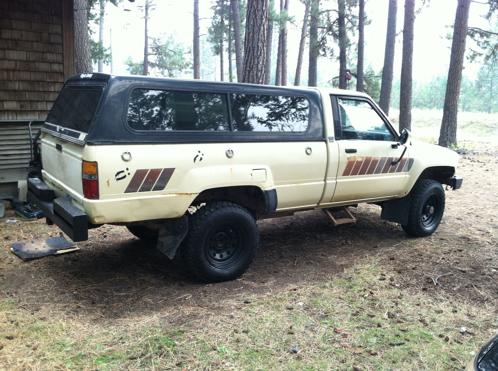

The beautiful deck railing red and white bumper. Welded up solid though with a hitch mount. I'll do it black and leave it for now. Deer hoof marks because... Badge of honor? Might explain the front end body damage and bent tie rod... Climb in step for a super short farmer's wife i assume. It'll go.
nasty shift boot cover, hack wired cd player, burned out dash bulbs, aftermarket steering wheel (horn wired wrong), standard cracked dash already installed!, and about 30 years of dirt road farm dust to be cleaned out of the nooks and crannies. Not a horrible starting point.

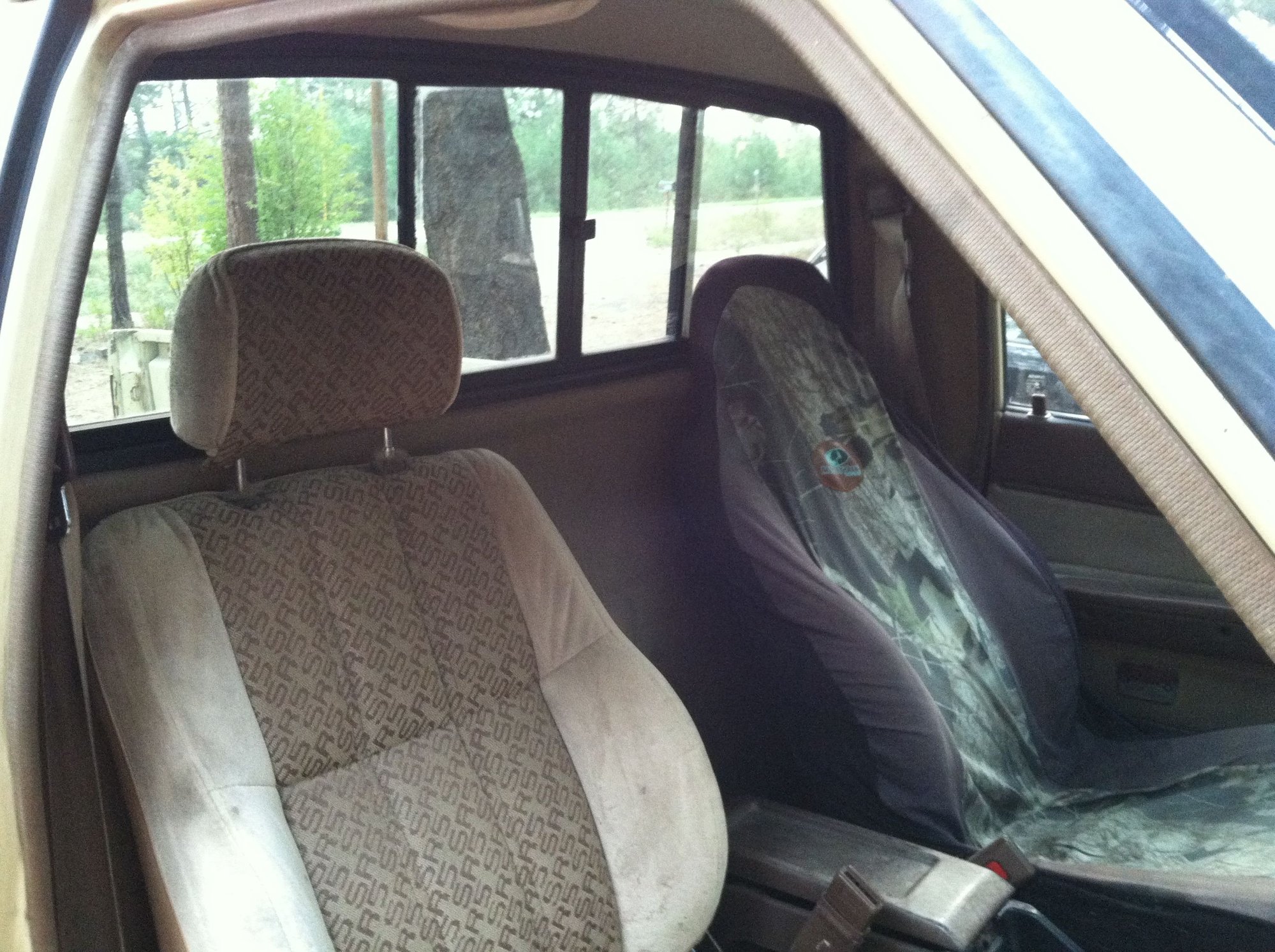

sr5 seats! But the driver's side has zero cushion left. I'm sitting on the rail. Maybe junkyard yota seats in the future. Center console hinge is busted and the top is pretty nasty. Read window works about as well as you'd expect for this age.
Blacked out wheels and bumper. Much better.
hit the window trim with a little touch up black. the truck is starting to clean up a little. I see potential.

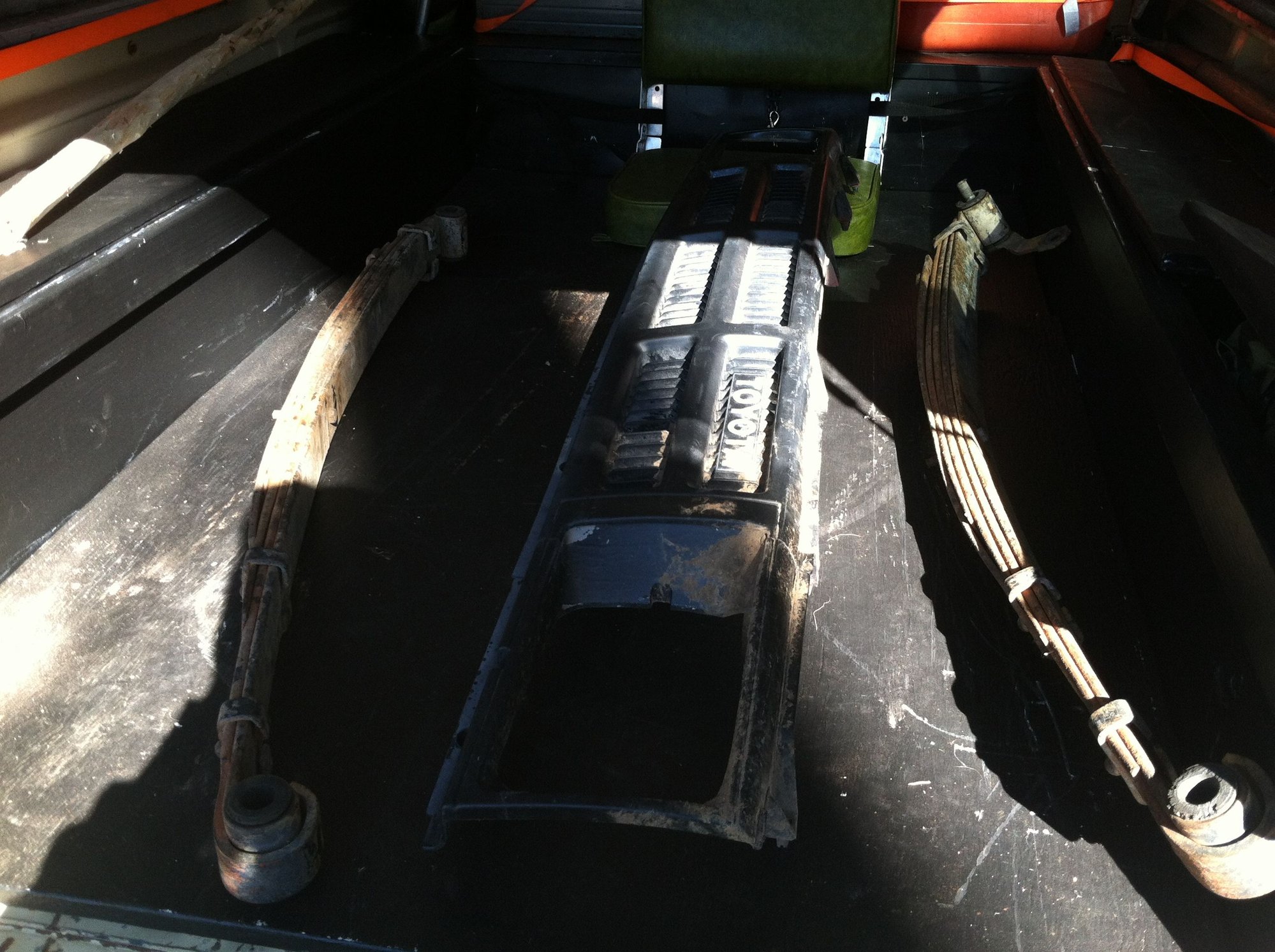

Found some 45" leaf packs with more life than the ones i'm running so hopefully i can work something out with a selection of leaves from both packs put together. Also grabbed a grill and headlight moldings in decent shape. Most grill clips are good and i need the headlight molding to complete my front end. Pretty happy about finding this item. Nice to have spare plastic on an older vehicle like this.
