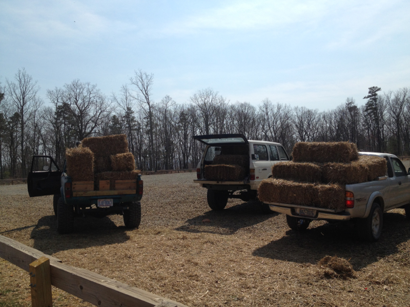

Here's a quick pic from the day I brought her home(along with the gf's 93 blazer):
Attachment 93798
My friends have dubbed it the teletubbie machine because after I bought it I installed my cb and put my antenna on top of the rollbar......they also call it dipsy....so I guess we'll stick with that lol

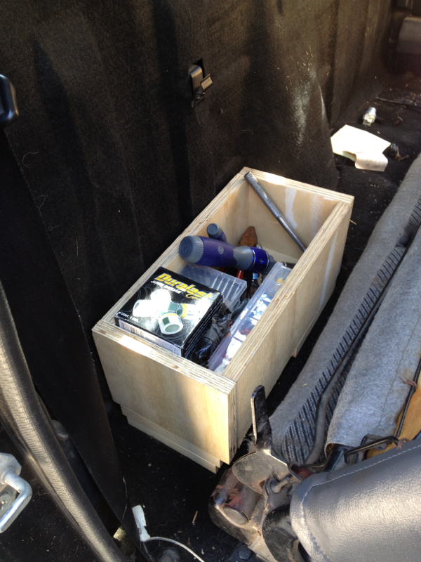

---Installed a radio, CB, floormats, and also made a small tool/parts box that sits behind the seat

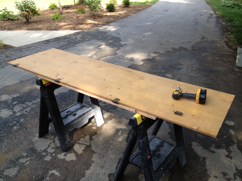

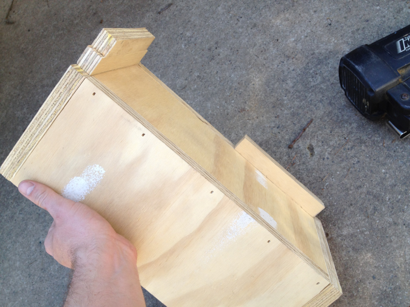

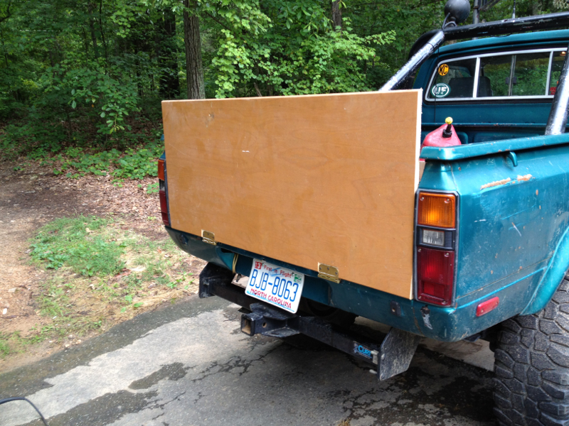

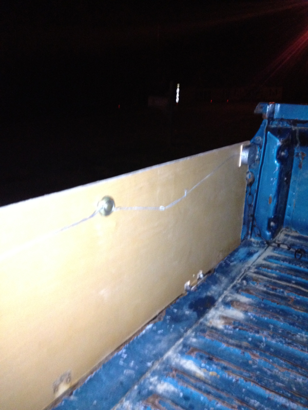

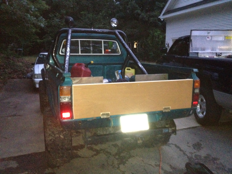

---Made my own locking tailgate out of wood since It didnt have one when I bought it
Some pics of that stuff:
Attachment 93799
Attachment 93800
Attachment 93801
Attachment 93802
Attachment 93803
Attachment 93804
Attachment 93805

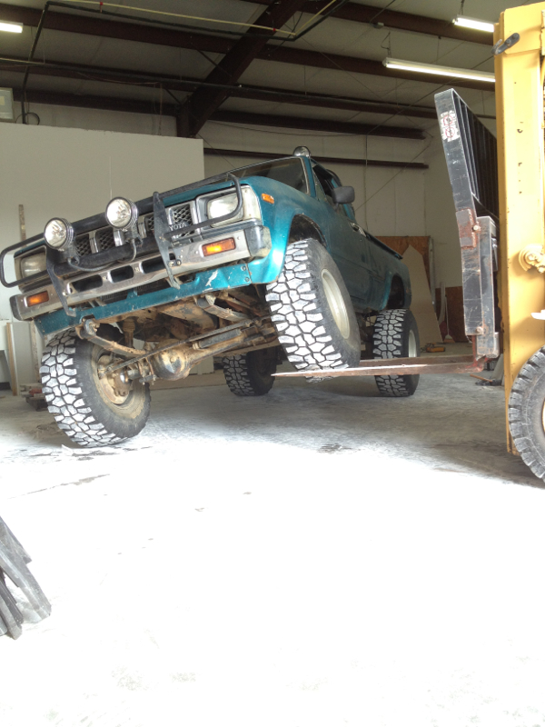

Some play pics:
Attachment 93806
Attachment 93807
Attachment 93808
Attachment 93809
Attachment 93810
Attachment 93811

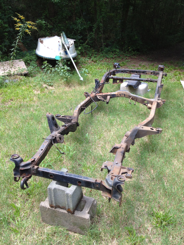

Don't have any pics of the cracks and rust but I will get some, but I do have a pic of my new frame in its temporary home. Enjoy!
Attachment 93813
gmack192 Aug 12, 2013 11:28 PM
You lucked out even finding a good frame.... It won't be difficult to swap everything over. I would strip and CLEAN the frame real good first and prep it. You should have a truck that will last another 30 some odd years...
-Yoda- Aug 13, 2013 06:30 AM
Yeah I know it man, they aren't a dime a dozen anymore. And I plan on sanding all the surface rust and everything off of it then probably turning the frame up in the air and make sure I get anything that's inside of it knocked out. After that it will get a few coats of paint or maybe some por15. I'm going to make sure this one is gunna last.

I did some work on the frame today. The guy I bought it from buys all kinds of toyotas and parts them out if they aren't worth saving. He told me he had bought mine in SC and had parted the whole thing and I was the last person to buy what was left of it.
At first i got pops and we stood it on end and took a hammer to it and knocked any loose trash out of it. While i was hammering i didnt find any suprises and its all really solid so that was a major plus. I also sifted through the dirt that i knocked out of the frame and found almost no rust flakes. <<<<Awesome!! I guess the PO didn't have a bed on the truck because they had welded some brackets and put trailer lights on the back. So I got the grinder with a cut off wheel and cut through the welds then knocked them off with a hammer then got a grinding wheel and got everything smooth. Did a bit of sanding on some of the questionable pieces of rust and it was nothing out of the normal small pits.
So now I know the frames all good (thank goodness) I'm ready to get this thing going!
