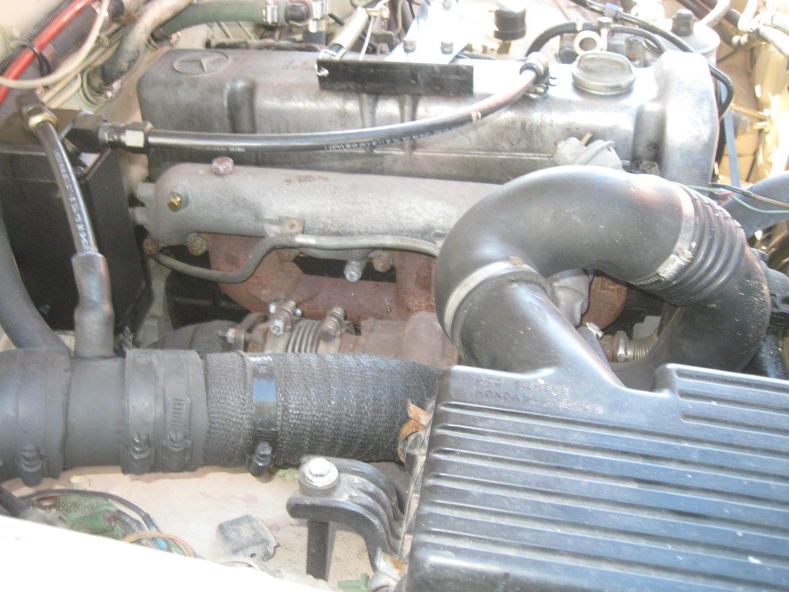

I pulled the radiator out of the back and the 6+' of copper pipe going from front to back for coolant. I was able to use the radiator setup I had on my 94 4runner to mock up a front radiator. Once I knew it would fit, I ordered a new radiator and made a bracket to mount the radiator. I also put a new m-pact 6 puck clutch in. It is rated for higher torque than the stock 4cyl clutch. I also added a long runner intake and replaced the turbo. The oil leak stopped and no more clutch issues. The new radiator and electric cooling fan solved my overheating issues. Now I can use the toolbox for needed storage.

Original set up under hood.

Current set up.

In the early 70s style I put fender mirrors on it. I had to adjust the tubing for the airbox and snorkel to make it functional. Got rid of a couple other things under the hood and cleaned it up a bit. Put a boost gauge in the cab and a mech temp gauge. I already know what my egts are from the 4runner. I will put a pyrometer in at some point and a Dakota dsl1 to get the tach working.
