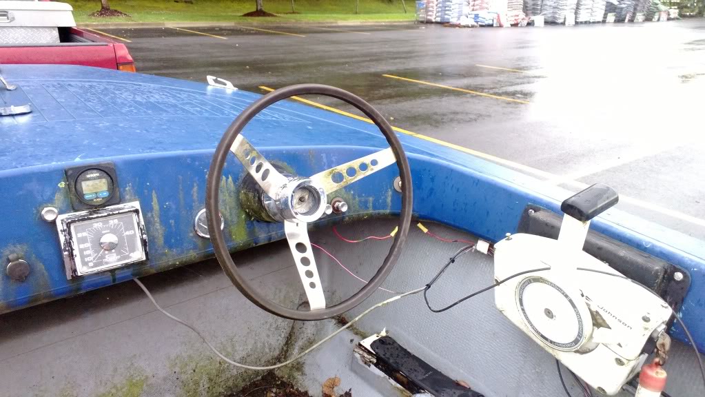

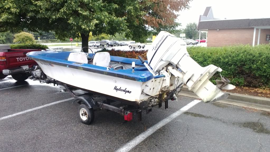

so i traded my 9ft sailboat for a 15ft motorboat
Attachment 158078
:D
more pics soon...

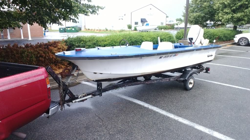

Wow. I just caught the picture on "post your pics" and had to look for the details. I really like the lines of the boat. Is it from the '60's? The trailer looks like it is vintage too. I bet it really strolls with the 40 HP. Back when I was working on mine I found the restoration forum at iBoats really helpful. There were a lot of build threads. They also have a Johnson motor forum.
http://forums.iboats.com/boat-restor...ull-repair-22/
irab88 Jul 3, 2013 12:13 PM

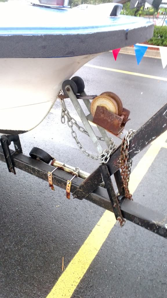

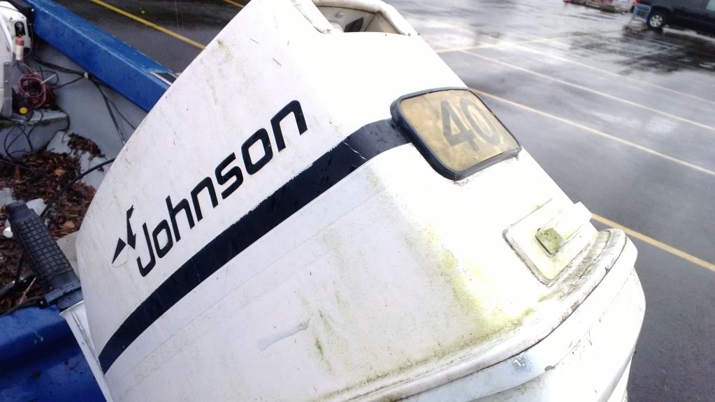

yeah, the hull is 1963, and the trailer is 1977. the trailer is in decent shape, just needs a new coupler, wheels, and lights. the boat needs a desperate cleaning, maybe some paint, and new/re-covered seats. the engine needs to have its pull-start re-wound and fixed (it's jammed right now) and probably a carb overhaul.
thanks for the link, i'll have to check it out. i want to learn as much as i can about all of this so i can get some use out of it (hopefully this year).
since you've been around boats for a while, maybe you can answer this: is that engine a 2-stroke? not too sure. i'll check the iboats forum (that's like the pirate4x4 of the boating world, right?)
Nervo19 Jul 3, 2013 12:22 PM
Yes it's two stroke. They are not sold in U.S. anymore due to EPA regulations. You probably know you have to mix your gas/oil 50:1. They are noisier than the new 4strokes but a whole lot lighter. I have a 2005 Johnson 25 hp. They stopped making the Johnson mark about that time but they are one with Evinrude. Bombardier Corporation which I think is Canadian. Most of the parts are interchangeable between Evinrude and Johnson of equal HP's.

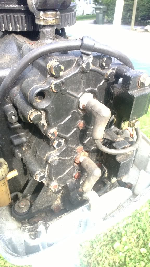

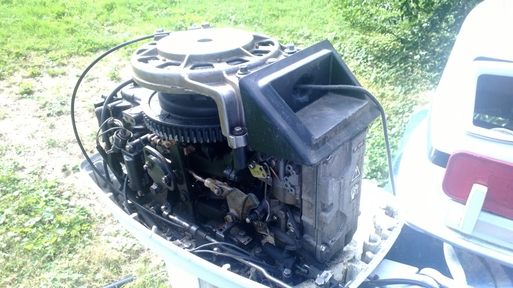

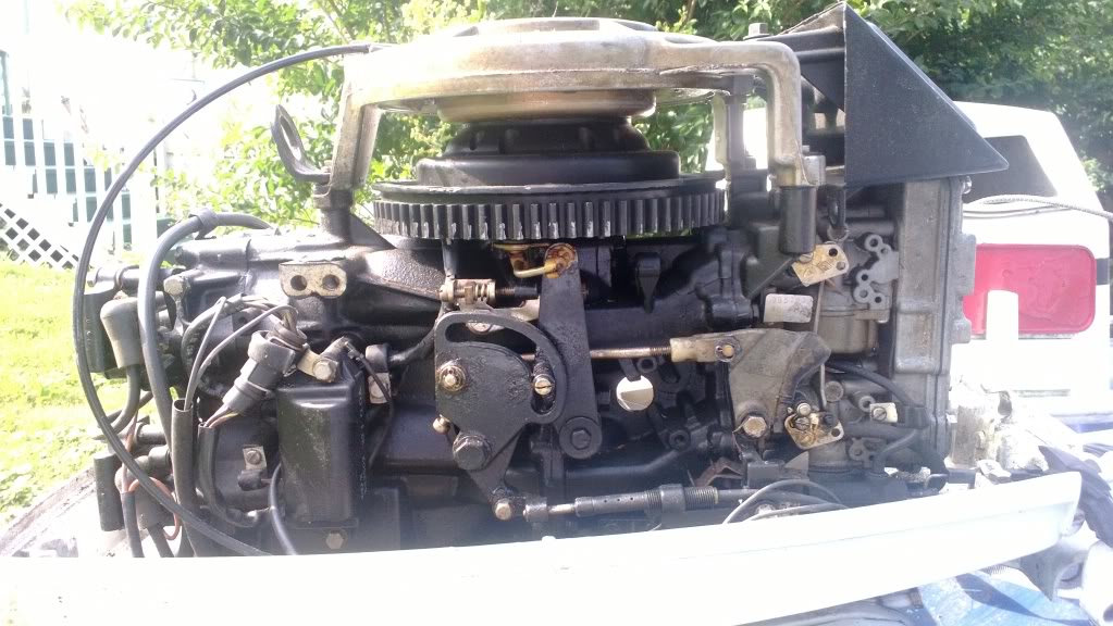

popped the top, doesn't look too awfully bad for a 28 year old motor
http://i1301.photobucket.com/albums/...ps8dca20ae.jpg
i'll check that bottom cylinder for water ingress
Attachment 157592
Attachment 157593
first on the list: fix that damned pull cord. also, the flywheel seems to have marks from a starter gear. maybe in the future i'll try installing one

Nice boat, those are good Johnson motors. The first thing I would do is get this http://www.westmarine.com/webapp/wcs...1#.Udtk9cu9KSM and change the lower unit oil.
Hopefully no water comes out...also, beg, borrow and steal to get electric start on that. It's the best thing I did to my 14 footer. Should be plenty of parts still kicking around for that motor.

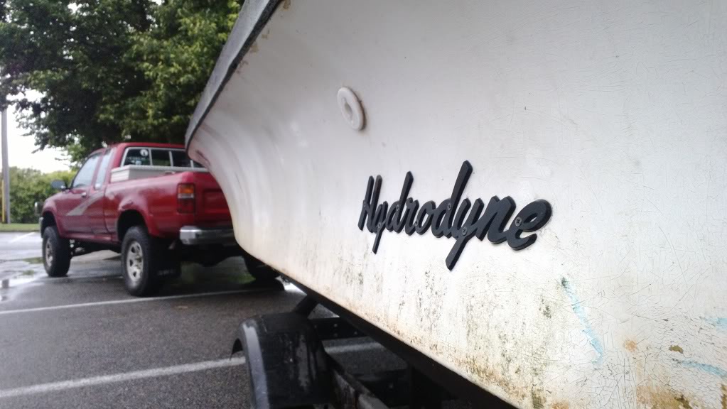

the only thing i'm not thrilled about is the dearth of information about hydrodyne boats. i mean, shouldn't there be records somewhere?
Nervo19 Jul 11, 2013 12:15 PM
Originally Posted by Resto-noob (Post 52094853)
Finally, Nervo, what's this about no 2 strokes being sold in the US? You can still get new 2 strokes, maybe I misunderstood.
Resto you are right! I misspoke meaning you can't get the lightweight 2 stroke like he and I have. When I was looking for a 25 to 30 hp motor about three years ago I really wanted a 2 stroke Yamaha. A couple of places had leftover motors and told me all outboards were going to be only 4 stroke motors. Yamaha does now sell a "direct injection" 2 stroke that is much heavier than my little antique boat needs. Also I think E-TEC motors are 2 stroke but they are very heavy and waaay more expensive than their predecessors. The old simple style light weight noisy affordable 2 strokes that last a zillion years are gone in the U.S. I bought a used 2005 Johnson 25 HP and I needed a short shaft which is a whole other complication.
Irab, if you go to "google images" and search for "Hydrodyne" there are a lot of pictures. I thought the J.F.K. connection was pretty funny. If you look for "JFK boat", you're going to get a lot of PT-109.
irab88 Jul 11, 2013 12:25 PM
yeah, but nothing about my year/model boat. so far, the only thing remotely close is this ad for a hydrodyne 1500 (probably what i have) :
http://www.hydrodyners.com/images/19...nebro3of12.jpg
