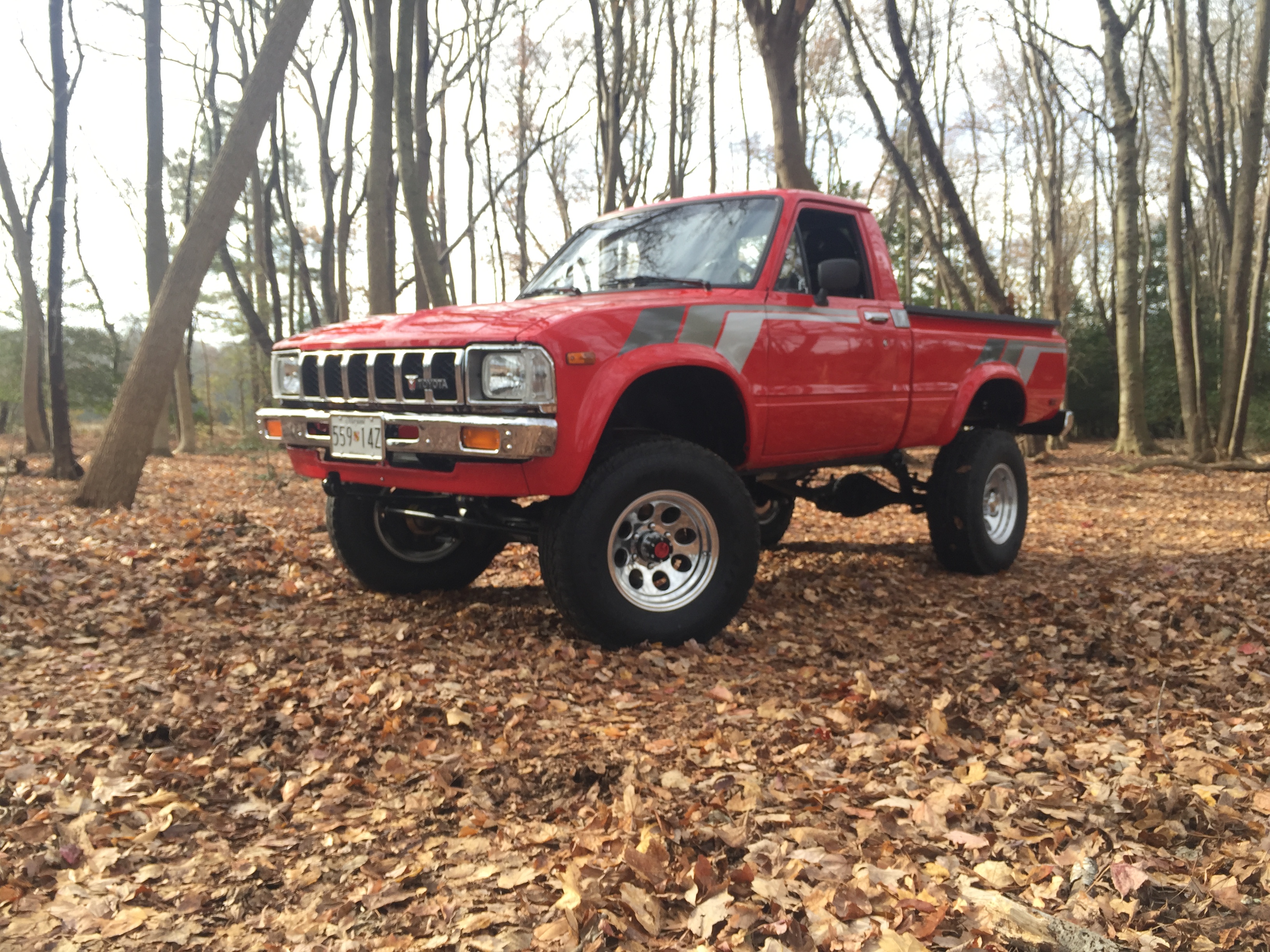

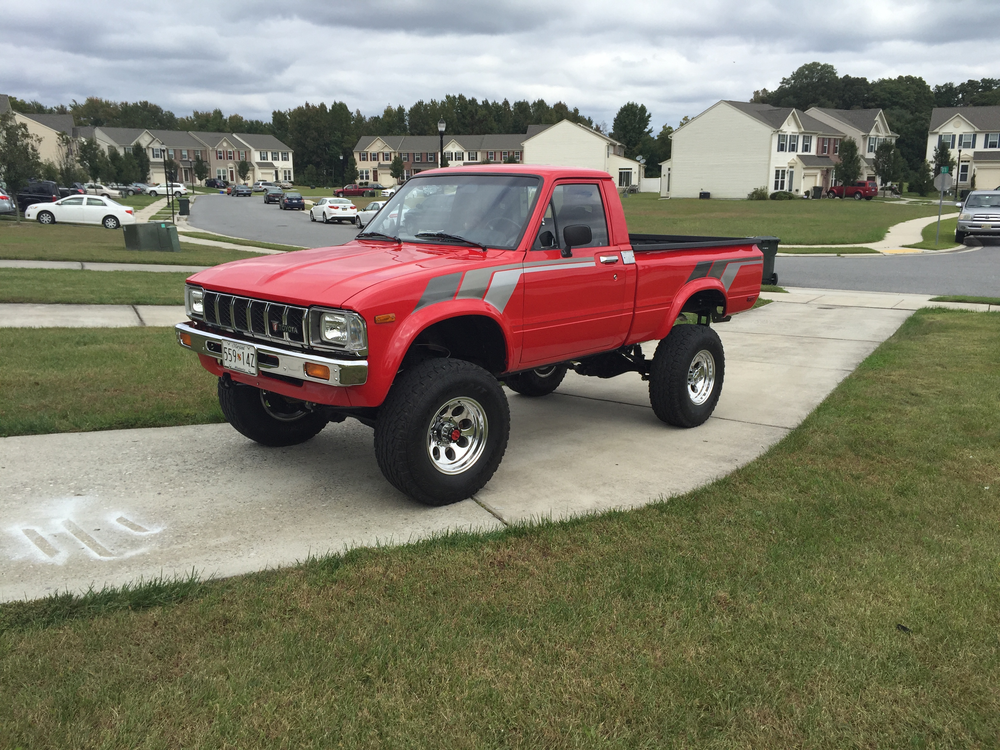

4 Attachment(s)
I have Ion Style 171 wheels (Polished Aluminum, 15"x8", -27mm offset, 3.43" backspacing, 108mm center bore) with Falken Wildpeak 31"x10.5" R15 tires. Great economical wheel and tire setup with no clearance or rubbing issues. Here are some pics for you:
Attachment 115651
Attachment 115652
Attachment 115653
Attachment 115654
