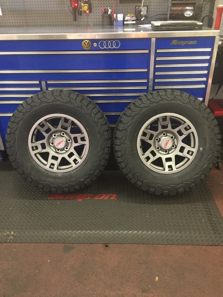

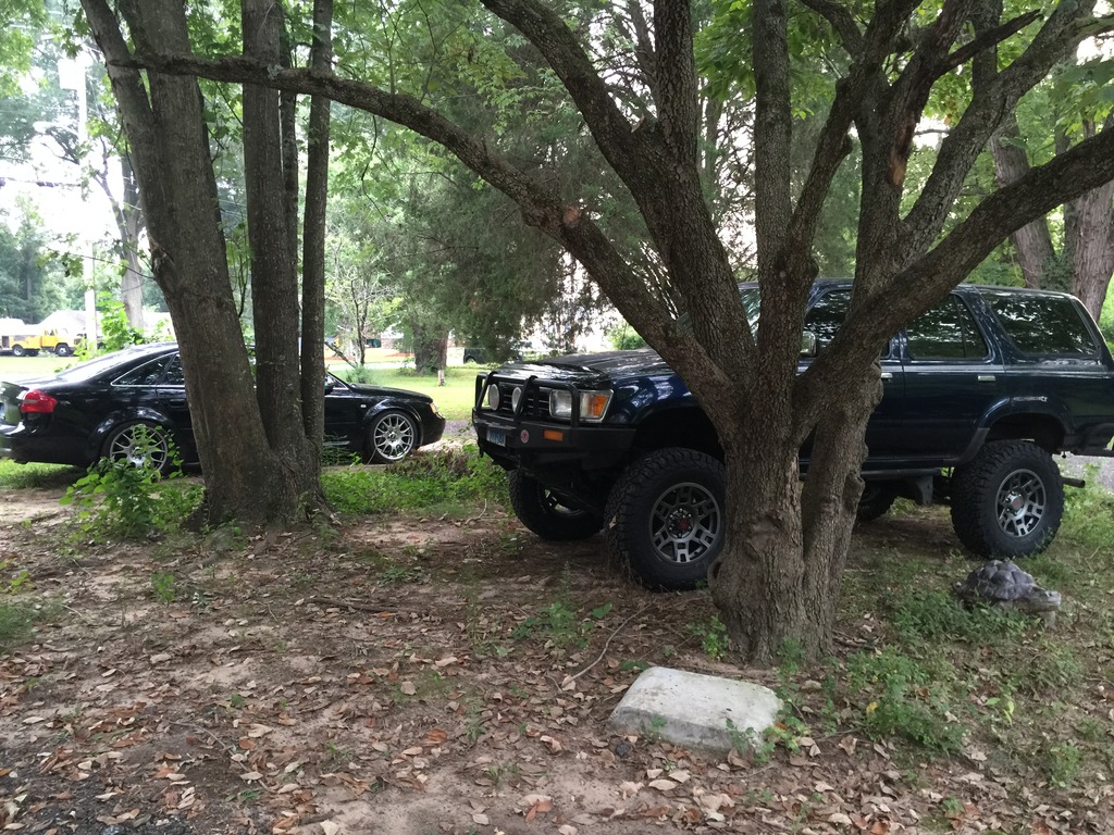

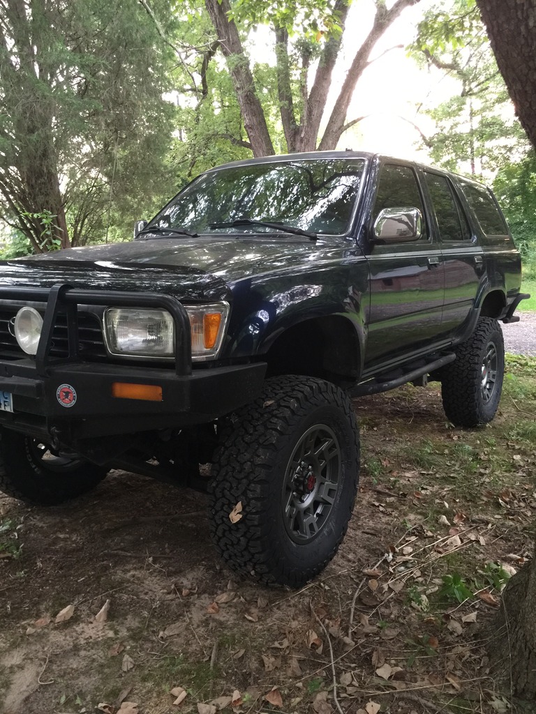

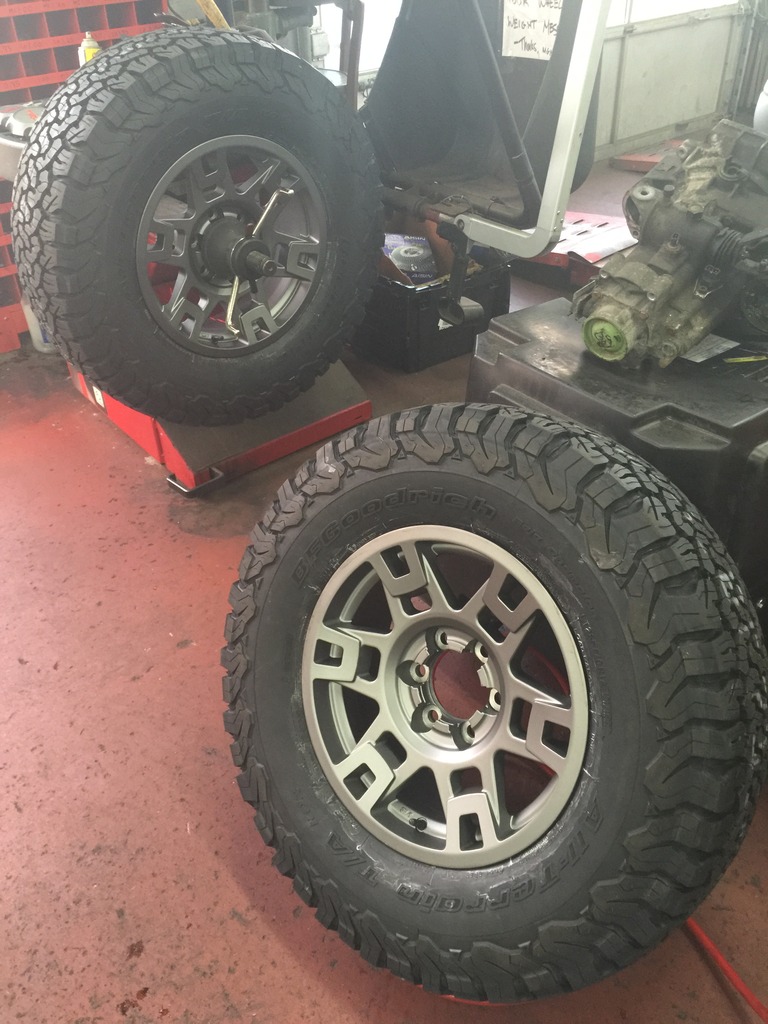

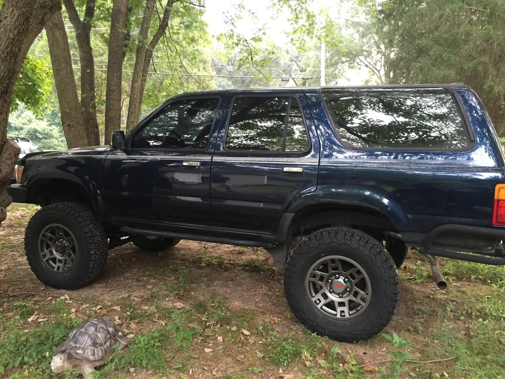

I wanted to try a more modern wheel, specially an OEM wheel for my second gen 4runner. Couldn't find any information about people using these wheels on a 2nd gen 4runner. Anyway, they fit an they fit very well.
The wheel specs are 17x7 with a 4mm offset. They stick out 4mm father than the factory offset 8 alloys. I think these were originally released when the FJ cruiser came out but have been recently "re-released" for the 2015 TRD Pro 4runners. Anyway, they look awesome. I put BFG Allterrain KM2 in 285/70/17 on them. The truck currently has a 4.5" Super lift on it (bought it that way) which is getting replaced with a 2" OME very soon.

Nice! That looks really good.

Looks great!

Wholly crap! I really didn't want to go to a 17" rim on my 94 but those look awesome...thanks, you may have just cost me a couple of grand down the road:hillbill:

Hi, thank you for posting the pictures!
Can you confirm this is the fitment without any wheel spacer?

Bump. Sorry for reviving such an old thread but i was wondering the same. Also, did you have to swap out the front center cap for any reason or did it not come with them?
