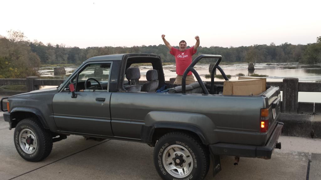

papawhellie Dec 24, 2014 09:20 PM
1 Attachment(s)
If your talking about these wheels these work.
Attachment 125108
http://www.ebay.com/itm/Toyota-Lug-Nuts-Toyota-and-Lexus-Factory-Lug-Nuts-Chrome-Set-of-24-/281193315904?pt=Motors_Car_Truck_Parts_Accessories&hash=item41786d7e40
papawhellie Dec 24, 2014 09:29 PM
I picked up one at the stealership for about 6 bucks to measure. I have it and the part number around here somewhere. I will post it if I find it. The link are the ones on my truck in the photo. Dollar each, quality seemed ok.
