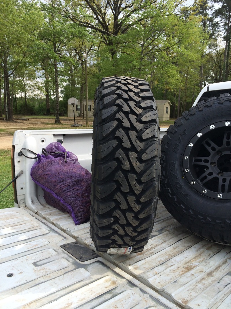

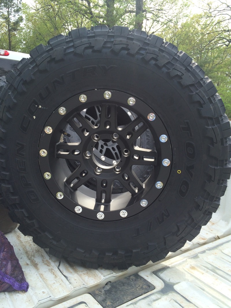

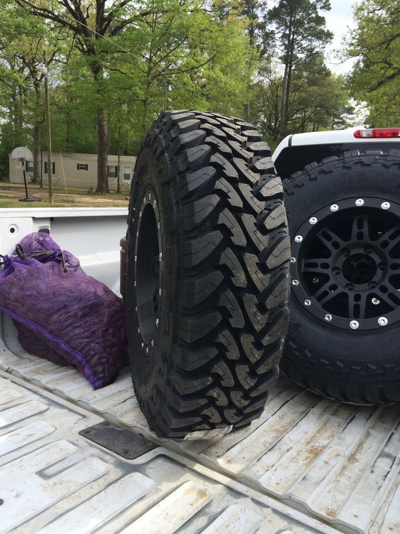

Regency Apr 1, 2015 04:00 PM
4 Attachment(s)
255/85R16 on 16x8 ProComp 7031
Attachment 121750
Attachment 121751
Attachment 121752

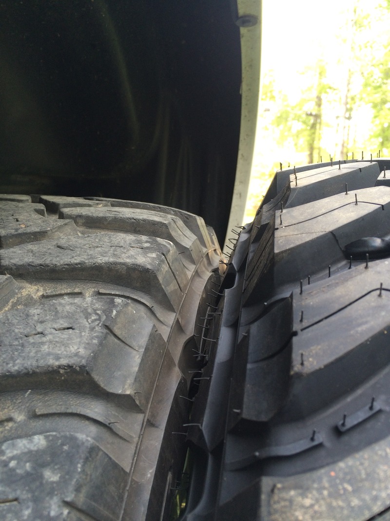

And just rolled up next to a 33x12.5 on a crew cab 3/4 ton dmax
Attachment 121753
highonpottery Apr 2, 2015 08:59 AM
nice! i like pizza cutters a lot. if i had the money at the time, i'd be running the same size vs my current 33x12.5/15 Toyo MTs - but I scored mine basically new on CL for a great price. i can already tell yours are visibly narrower and will have less rub issues and likely weigh a lot less too. also i think a 255 is slightly over 33" and a "33" is slightly under 33".
Regency Apr 2, 2015 09:58 AM
Yea itll be less weight and less resistance to wind so = better mpg. There are advertised as 33.5" and on a couple sites they say the are true to size and are the largest 255 on the market. Im ready to get home to fit them on the truck.
The 12.50 was too wide for my taste and they dont make a 10.50

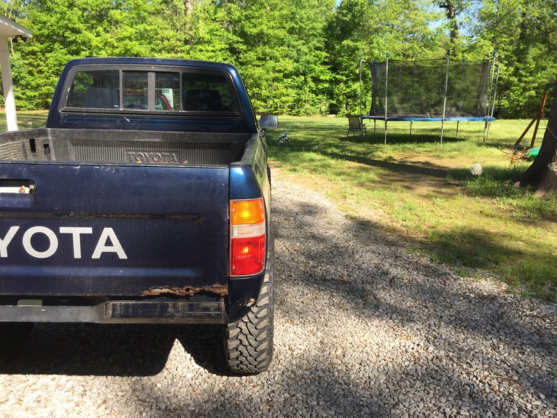

Regency Apr 4, 2015 02:35 PM
3 Attachment(s)
Attachment 121686
Attachment 121687Attachment 121688
Regency Apr 4, 2015 02:36 PM
Still have to install the ball joint spacers and do an alignment.

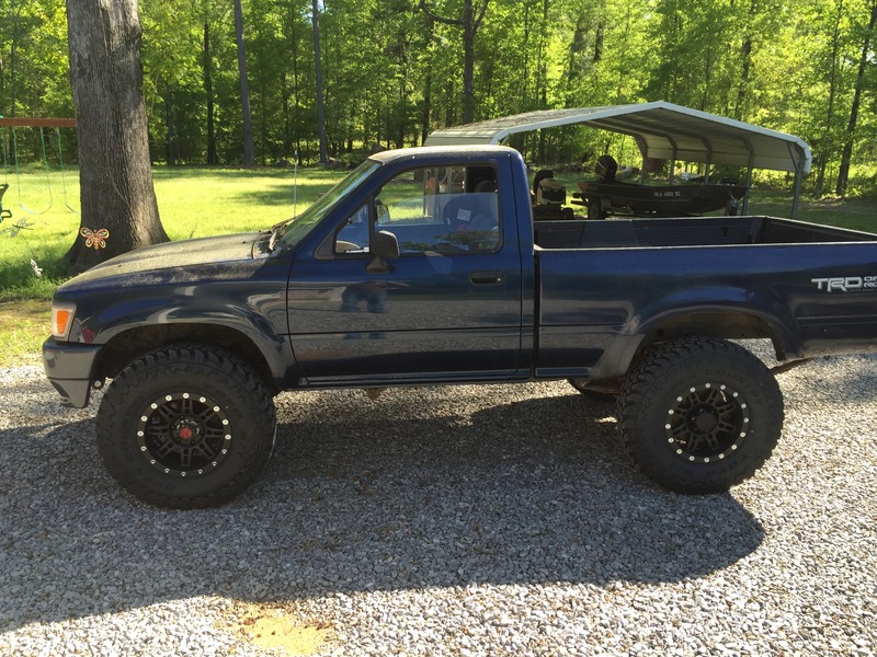

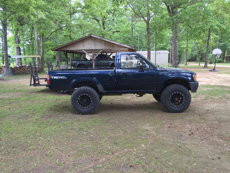

Regency Apr 12, 2015 03:40 PM
1 Attachment(s)
Spacers installed. Did not relax the torsion bars but cranked the passenger side to level up the truck. Needed 3/4" to level side to side up front. The rear is starting to settle in some so with adding a spare tire and some type of rear bumper i will need to add a shackle to level it back up.
