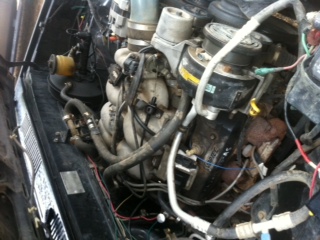

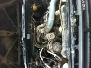

Here is what im working with... Thanks for the help
Attached Thumbnails I bought a 87 4runner with 4.3vortec TH350 swap already done...-4.3-vortec2.jpg   I bought a 87 4runner with 4.3vortec TH350 swap already done...-4.3-vortec3.jpg

You have "gm CPI motor " made from 1992 to 95 . Allmost 200 hp stock .
Good motor but " spider injector " the fuel injector is prone to leaking when they get old . Easy to replace if bad , cost about $175 .
Same motor I have in my 92 4runner.
I would do a basic tune up first then check for a vacum leak , then leaky injector.
