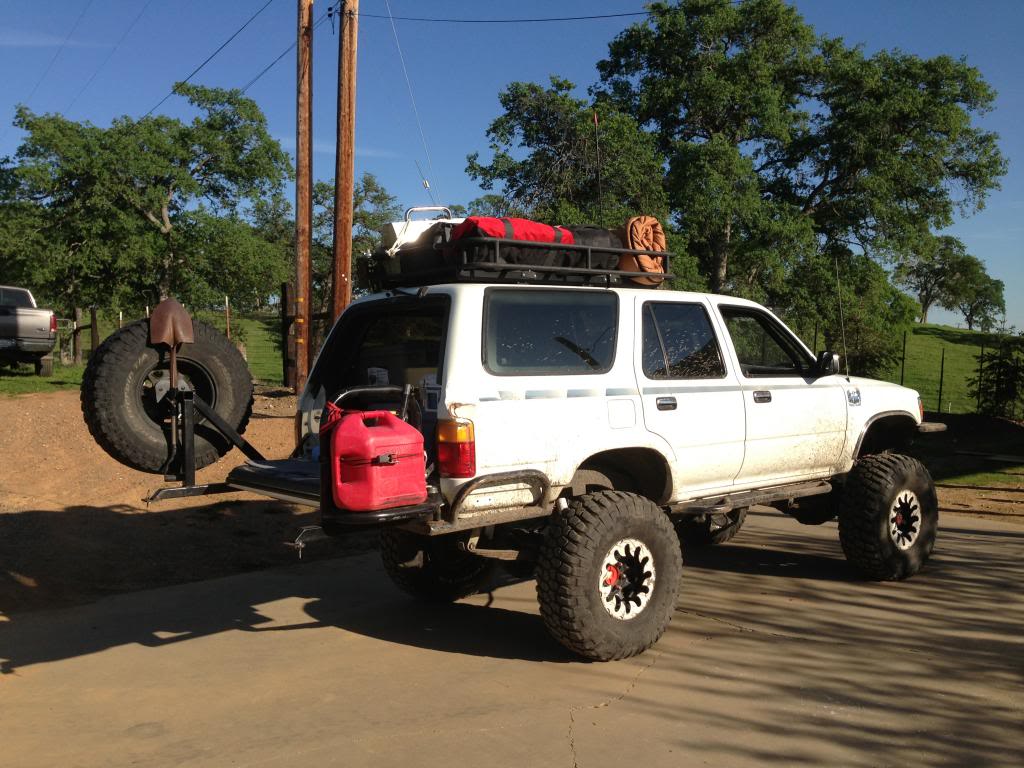

Ive never dealt with northwest off road , but a long time ago i read lots of post's they were over priced and not very good. Call advanced adaptors and look on their web site . You are going to have to fab up a lot of things like cross member , wiring harness , exhaust , fuel lines , motor mounts , new drive lines ..... so can you fab ? If not you will have to buy all that stuff. Not sure if you need a lift to clear the ifs. ask advanced adaptors.
Also if your wanting to strait axle now would be a good time with the motor pulled out . Which 4.3 ? throttle body or cpi ? Tbi has 160 hp , cpi has 190 hp. Are you making a crawler? then you would want the toy 4cyl t case . If not then use the chevy t case with the chevy trans if the t case front out put is on the same side as the toyota and that would save you some $ cause you wouldn't need an adaptor. Everyone i know with 4.3 swaps used the auto trans that came with the motor . Im running a 92 4runner with a 94 4.3 cpi auto transmission with a toy 4cyl t case . I love it but if i were to do it again i would think about the 3.4 a little more. 3.4 is a little more bolt in friendly. Hope this helps a little .
