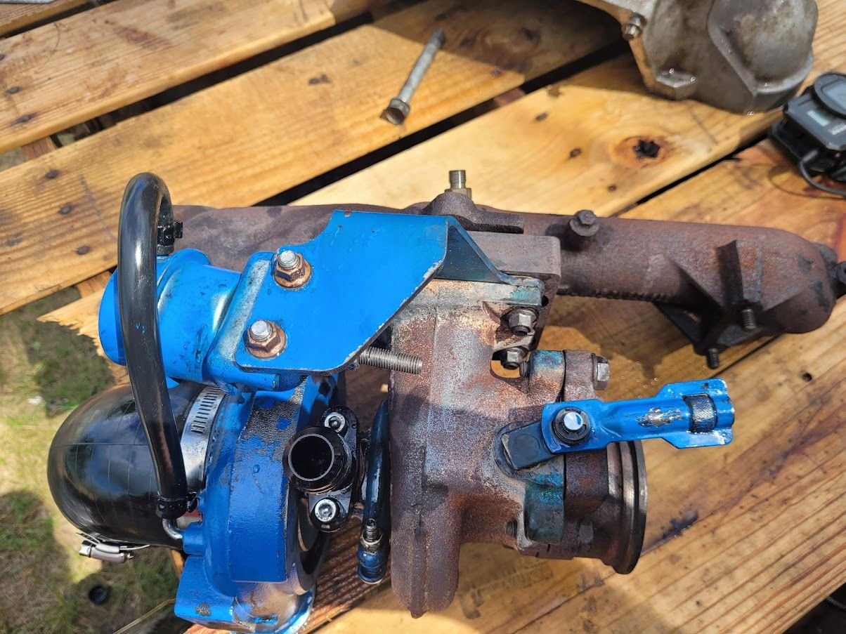

Drove it 120 miles round trip to and from work the other day, throttle linkage fell off, popped it back on and continued... Wastegate actuator came loose from wastegate door, wired it shut to get home and then put it back together with red loctite.

I bought a VNT turbo on ebay to try to rectifiy that.
