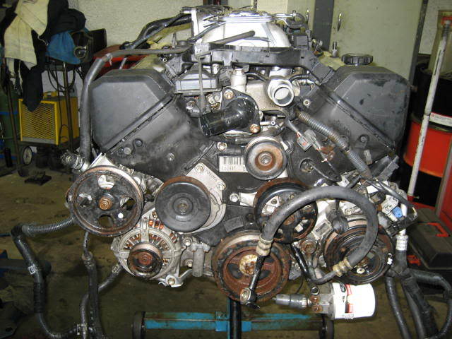

This is what I stared with, out of a 92 SC400.

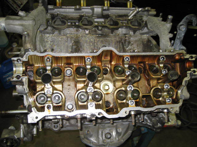

Installed new valve seals and resealed the entire engine.

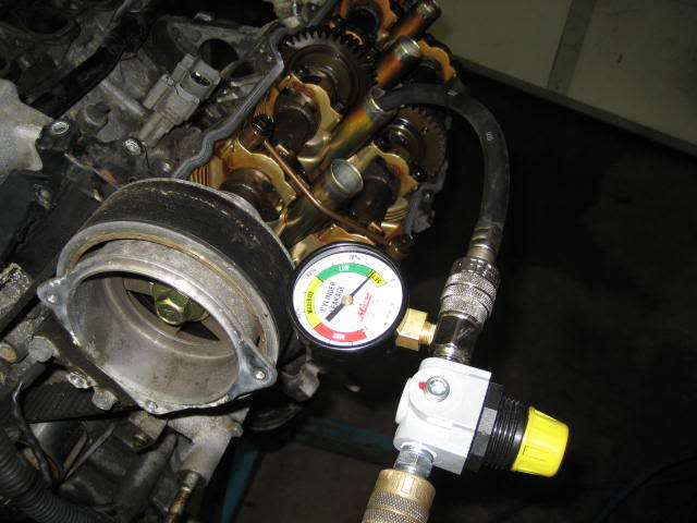

Leak down test passed with ease.

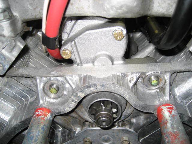

I Heli-coiled the block so the starter bolts could be installed on the starter side. Will save alot of work if the starter ever needs replacing.

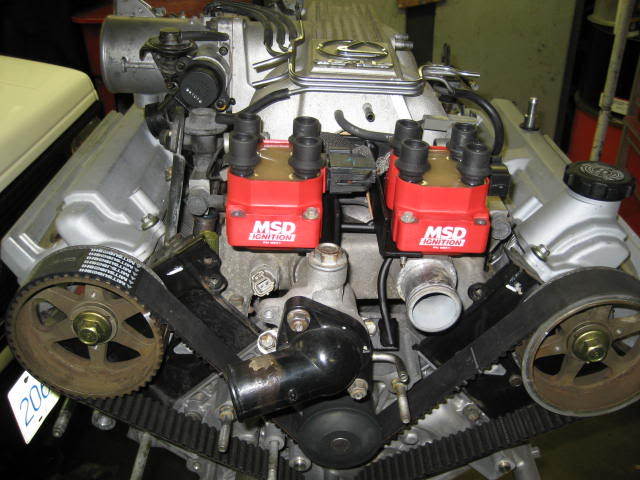

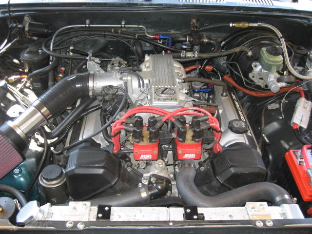

With the engine completed I started the mods. 1st was mounting the DIS coils in place of the stock IAC motor. The IAC was missing, and since I'm using a manual trans, it's not really needed.

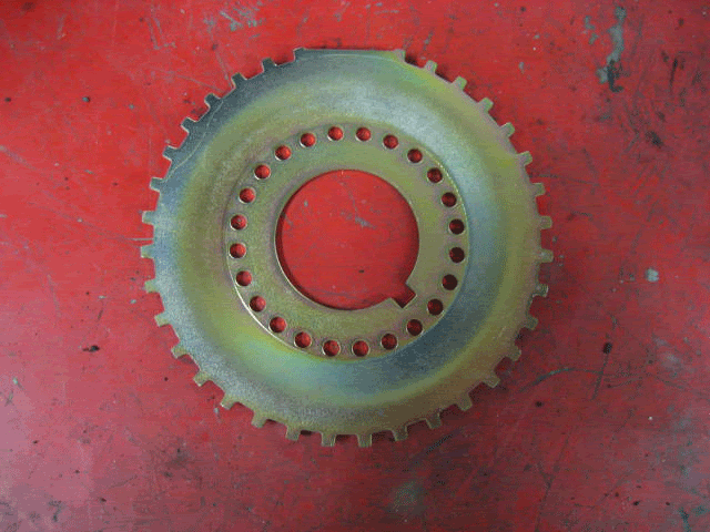

For the Ford EDIS ignition I needed a 36-1 crank trigger. The stock crank trigger is 12 teeth so I purchased a trigger wheel for a 98+ 1UZFE (picture) It's a 36-2 wheel (36 teeth with 2 missing) I had a friend TIG weld up the 2 missing teeth and then removed 1 tooth near the 10o'clock position so the ignition would be in proper time. Sorry no pic of the completed trigger wheel.
The stock Lexus crank sensor works fine with the ford module.

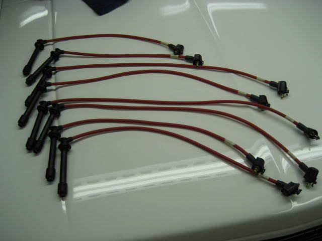

I had Aurora Ignition make me up a hybrid set of ignition cables. Was cheaper then buying the stock replacements.
Engine ready for a test run. Note the deleted cam sensors, not needed to run MSquirt.

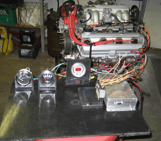

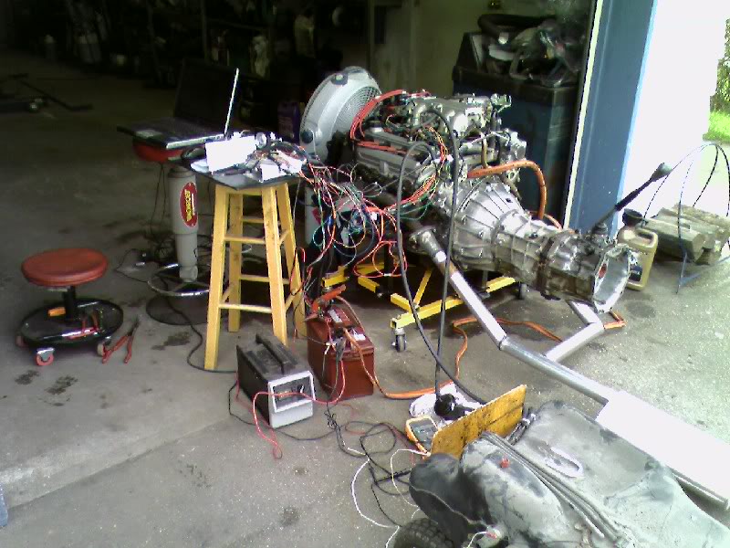

I then decided to build a simple test stand to test run the engine. Also to check the operation of the Msquirt ECM and the Ford EDIS.
Engine ran well once a basic tune was programmed. Mechanically the engine sounded great with good oil pressure.

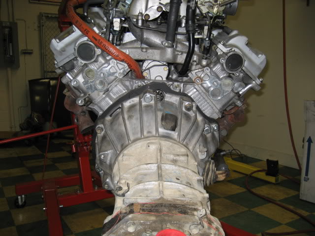

Adapter is visible in black. Note cutout in R151 bellhousing for starter gear clearance. Bellhousing was milled 3/8" to compensate for adapter. Should have been 5/8" to get perfect input shaft engagement, due to flywheel differences.

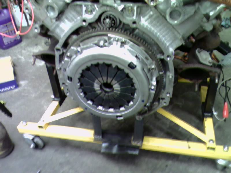

Modified 91 MR2 Turbo flywheel with 3.0l clutch. Flywheel crank holes were filled and the redrilled by a machinist. I then chamfered the gear teeth since the starter engages on the engine side.

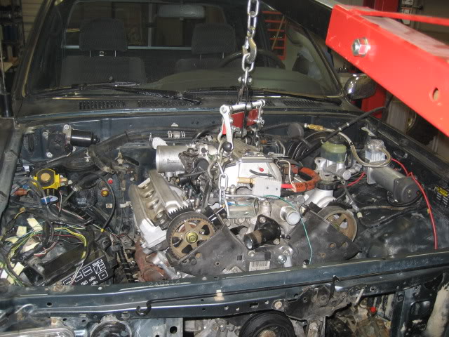

In Jan '09 after prepping everything I could think of, I decided to pull the trigger and start the actual swap. It took approx 7 weeks to complete, chipping away at it whenever I could.
Original, but good running 3.0l. Instead of selling the 3.0l, I bought a 89 Xtra cab 4x4 with a blown engine. I installed the good 3.0l in the 89 and then used it as a driver while my swap was in progress. After the swap was complete I sold the 89 and the profit pretty much paid for 50% of the swap cost.

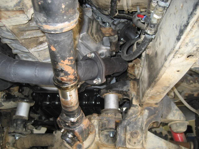

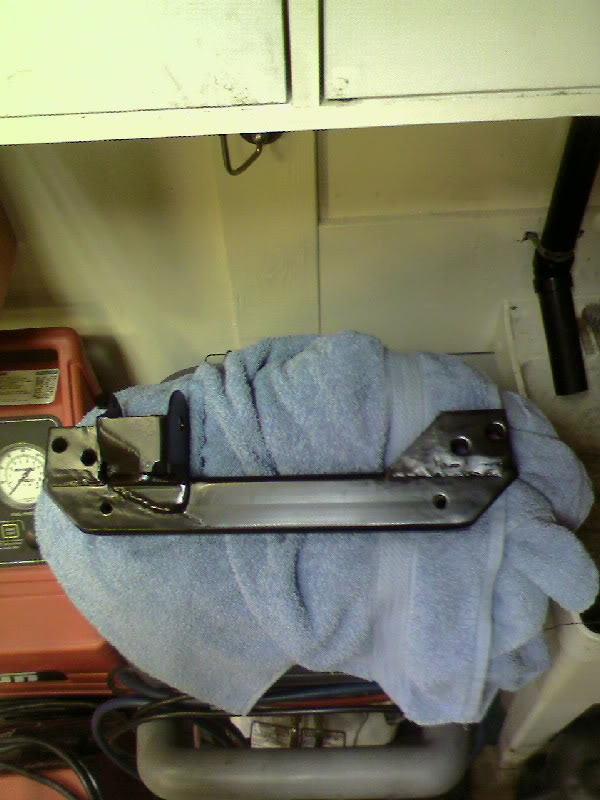

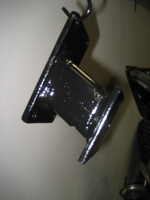

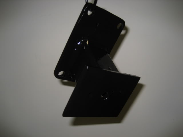

Engine mounts made up. The engine and frame mount points almost line up perfect, so mounts were easy to fab. I reused the original 3.0l rubber mounts.
The transmission mount needed a 2" spacer and offset 2.5" ( sorry, no pic)

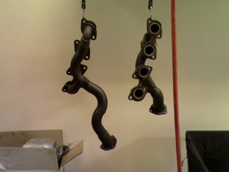

I used the SC400 manifolds, but heavily modified to fit around the upper A-arm mounts. I used mandrel bends and small 3 bolt flanges. The right side is very tight around the slave cylinder.
I installed a Wide band O2 in the Y pipe. The rest of the system is single 3" with a large Magnaflow muffler. Idle and cruise are fairly quiet, but it sounds fantastic under load.

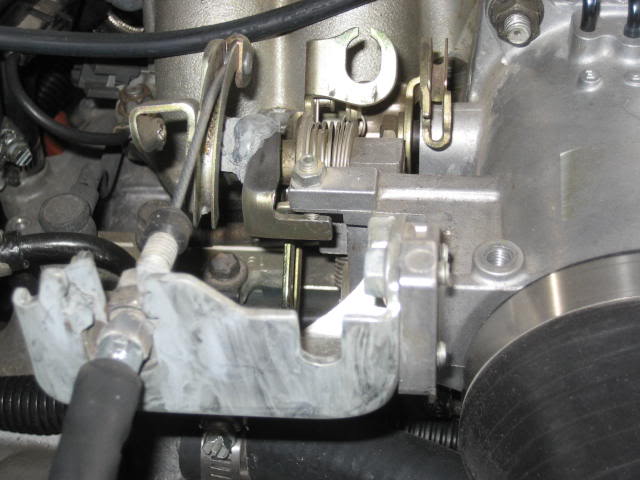

To make the throttle cable work without some wierd angles I cut the quadrant off at it's original 6 o'clock position and rewelded it at the 12 o'clock position. A couple modified fender washers tacked on the bracket positioned the cable in the right position.

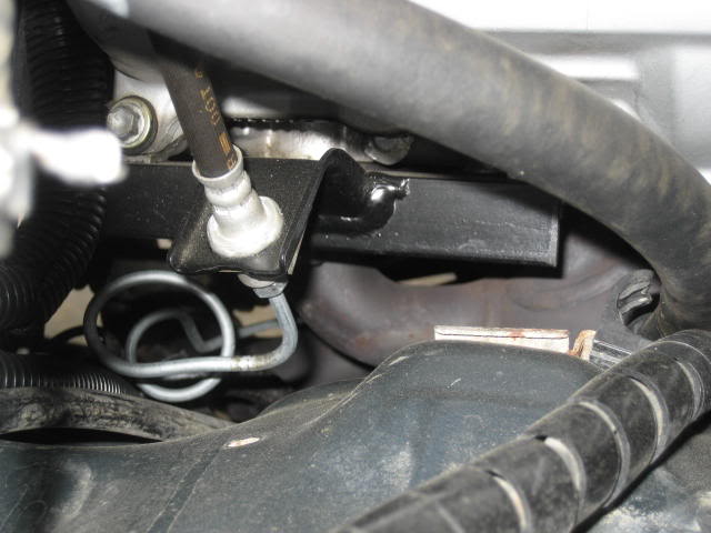

Clutch hose bracket

Back on the road!
