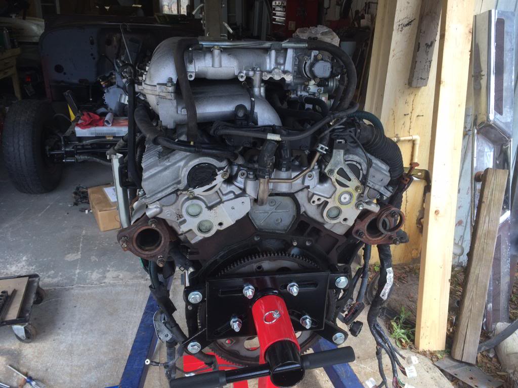

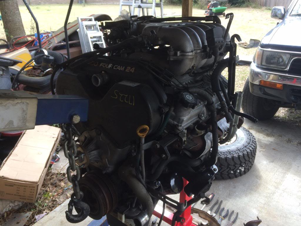

Here's a few pics of the going ons.
Here's the 1998 3.4 out of the 4runner 115k miles on it, nice and clean.

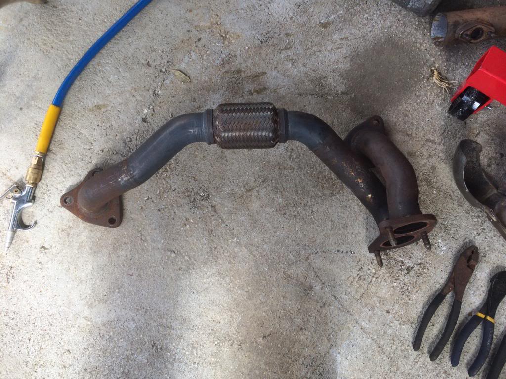

Started on the crossover.

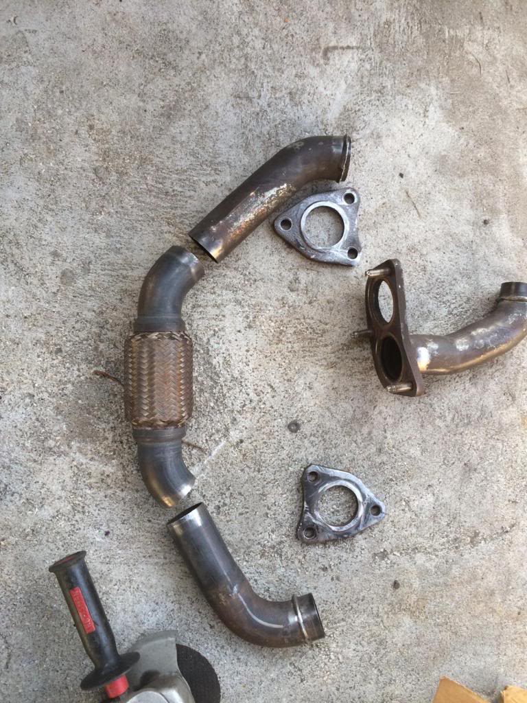

Making thee cuts to late to stop now.
