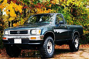

I bought my first Yota on Craigslist about two years ago, with 227k miles on it. I bought it because I have read all the stories about how reliable these engines are, and I believe it. The 22re is small and dependable, but it just lacks the power that I'm looking for. Over time I realized that it burns oil pretty badly and it has a random missfire when at warm idle. I know that stock, these engines are supposed to crank out roughly 100hp, but rolling at 240k miles now I expect the power output to be around 75hp, more or less. Combine that with 32" mud tires and it just performs poorly on the road, especially on the Interstate:
It needs a rebuild badly, and I thought that I would just get a rebuilt 22re, and maybe install a few bolt-ons to increase power, but still, if I'm going to replace the engine I might as well go with something better from the start.
This leads me to my question - What is the most cost-effective, efficient, and easiest to swap in place of the 22re? I'm looking for a swap to where I can achieve at least 200-250hp. It MUST retain these functions:

from my research (also have a tired old 22re that will need love sooner than later) i would go with 3rz or 5vz-fe. They seem more abundant, thus could be found cheaper. They're fairly popular swaps and there are wiring kits available, requiring less custom fab work. Most of the 1uz swaps ive come across end up with an automatic trans. The 7m-gte i believe is one of the more rare engines of the lot, thus would be most expensive and hardest to find parts for, if you found one at all.
Thanks for the input guys, I will probably be going with a 3rz/5vz if I can find one. I'd love to have a v8 under the hood but I don't want to deal with all the adapting and hassle that deals with converting it to 5spd. Maybe throw a turbo on a 3rz in time? I'm trying to get at least 200hp.

3Rz if you want a little more economy, 2Rz would go even further, because it's still nearly 30 more ponies under the hood than the 22R-E, but still about the same displacement so it sucks down the fuel less rapidly.
A 5Vz-E swap is the way to go if you want power more than anything, they're ballsy motors that produce power and torque that blow Big Three V6s away all the while still pretty much sipping gas by comparison.
It all depends on what you want to do with your rig. Personally, I'd sacrifice the brawn of a 5Vz for a 2Rz swap and up the gearing where it counted. It'd be the best of both worlds: more power for getting around, but moderate fuel consumption and a simpler overall internal arrangement than the 3Rz. Guts, simplicity, economy.

just stay with the 22re and install the proper gear sets to turn the larger tires, you would be surprised at what gearing can accomplish. horse power doesnt correct incorrect gearing
My vote is 22re with proper gearing. They don't don't put out tons of power but they are a sure bet for reliability. There is a reason these little ngines last so long. Just my 2 cents.
