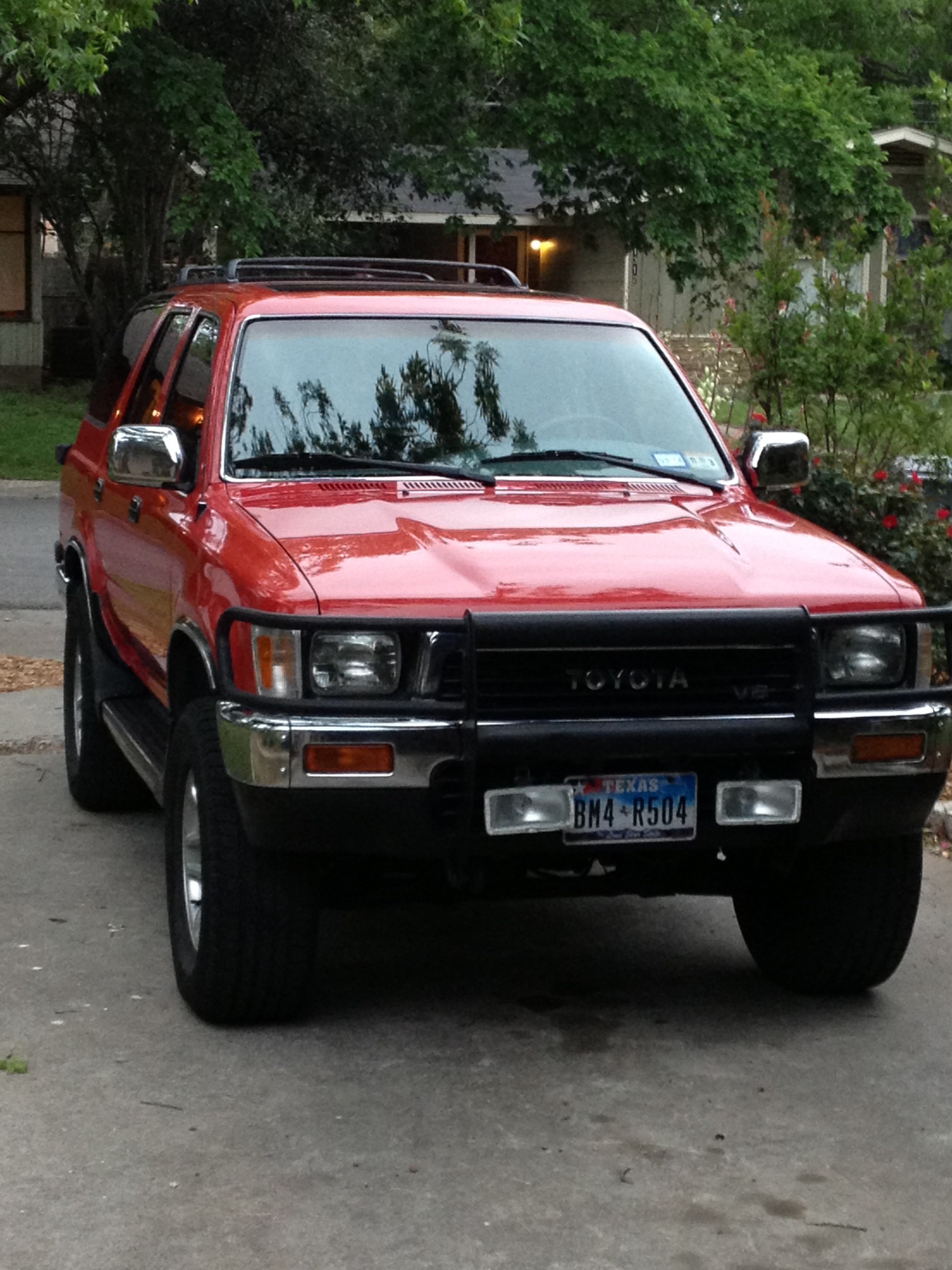

Howdy pardners! So I've been reading a lot of threads here and on jeep sites about the aussie locker or other auto lockers being dangerous on icy trails, mainly because if both tires get power and spin, the truck will start to slide toward the lower side of the trail, or understeer at best, which could be dangerous. A lot of people only run 2wd in the snow/ice if they have the auto locker up front.
Their argument is that in icy conditions an open diff would be better up front because the tire that isn't getting the power is able to keep traction/position by not spinning, and keep the truck moving in the right direction. Like a rudder I suppose. That all makes total sense to me!
Wait the question is yet to come...
My plan for my 1990 4runner dd is to install manual hubs and an aussie up front. That way I can unlock the hubs and city/hwy drive with no ride quality change whatsoever. Then, lock the front hubs and engage when i need it. <<<There are some really great reasons on the lokka website for running front over rear if you're doing one locker. Agree/disagree?
http://www.lokka.com/site/faq >>>
HERE'S THE QUESTION:
If i run the setup described, and find myself on that slippery hillside trail, could i simply lock one front hub only, to get drive up front, and yet leave one wheel free to track? I don't think it would be bad for the locker because its designed to allow one wheel to go faster, which basically is the same as loading one side only. The real question then is which side to lock? The side lower or higher? Closer to the outside or the inside of a turn?
What do you think?
