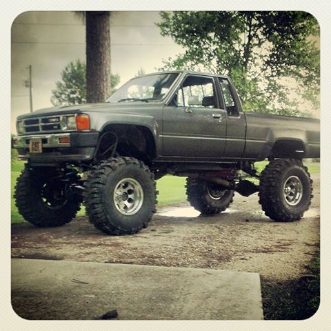

I just SAS my truck and put some 3 in blocks and added a leaf to the rear, Im trying to fiqure what yall are doing for the rear shock mounts, obviously the stock shocks aint gonna work I measured the shock mount to shock mount and its 24.5 in, I know you can buy the mounts for the axle but what are yall doing for the top mount. Im trying to keep the stock mounting locations if at all possiable( trying to save a buck) I know they sell the tube that goes over the axle to relocate the shocks, just trying to fiqure some things out before buyin more stuff.

I run the stock upper mounts while using a piece of channel with a bolt welded through for the lower shock mounts. My previous setup was a tube across with a few mounting options but prefer the stock upper setup myself...Cheers!!

i stayed with the stock mounts top and bottom and went with a 31" long shock
