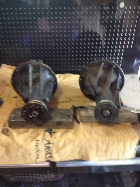

I got the front hanger tacked on today and got my frame tubes put in. Most of my day was spent going to pick up a pair of thirds set up with 4.88's

This is my first time dealing with a solid axle and leaf springs. I'm just kinda learning as I go. So far I have about 12 hours into it and I suspect another 8 to finish it up. Shock hoops should be here tomorrow, and my new calipers and pads arrived Friday so I don't think there is much left before I can drive it minus the front drive shaft.
