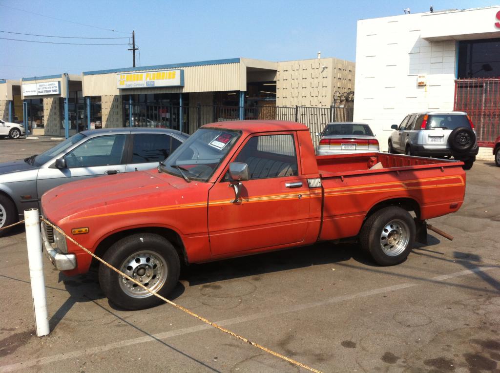

Hi guys, new here, don't actually have a truck yet and that's why I'm here. I saw one with a for sale sign on the side of the road and took a quick look.
He wants $500 obo. I didn't have a whole lot of time so I didn't get a whole lot of info but here's what I know.
Thanks for any help. Here's a few pics I took?
IMG_1506.jpg?t=1378897361
fb57c521-007c-4fd4-87e4-2ec2fab82090.jpg?t=1378899480
Hard to see much of the interior, the pics were taken after he'd already locked up the truck and gone back inside.
- The guy I talked to says it's a '79...is that what it looks like, the grill looks different that what I'm seeing as a '79?
- I tried starting it but it would start, it cranked real strong, just didn't start. He said it's been sitting for about a week without being started but it does run. I have a bike at home that's just as old and it takes a while to start after sitting for a while so I'm don't find that hard to believe. I'll look more into that when/if I go look at it again.
- Not sure of the mileage, I forgot to look.

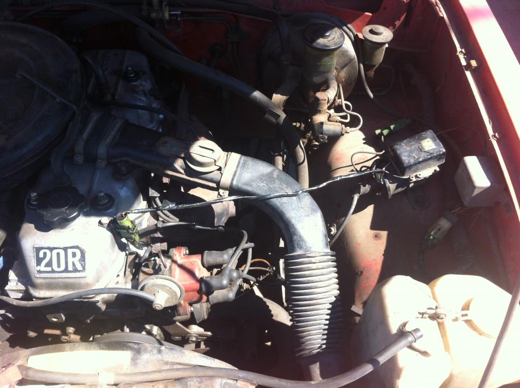

- Engine bay looks pretty clean and straight (except for the bungee cord holding the battery down) with the 20R engine.
- The body looks pretty straight from what I saw except for a missing passenger side mirror, a dent on the bed behind the right rear tire and the body colored part under the front bumper has a dent in it. Tailgate and latches even look in good shape from what I remember.

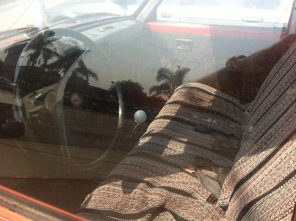

- As for the interior, don't know what the seat looks like, it's covered with one of those poncho-type seat covers. The dash looks pretty bad and the door panels look like they're upholstered pieces of plywood.
- One thing that concerns me is that three of the wheels match, the forth doesn't. The forth is on the right rear...where the dent is at on the bed and I'm wondering if it might have gotten hit bad enough to mess up that wheel and maybe some suspension or driveline stuff. How do I check for damage there that might not be so obvious?

Has great potential and is in great shape for its age. It would be hard to find one in that rust free condition compared to what is in the midwest area. Definitely would want to do alot of work before driving it to Mississippi which I know you said is a fair amount of time off from now.

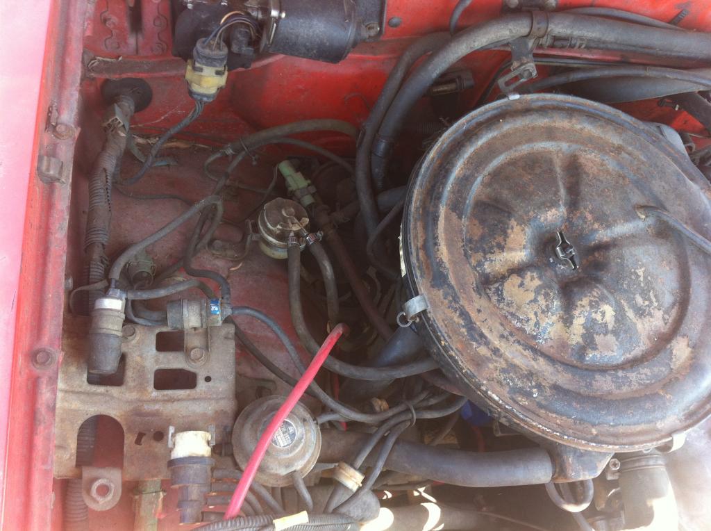

So here's the deal y'all. I went for a better look today and here's what I found. It took a LOOONG time to get it started, but once it finally started it ran pretty good, nice and smooth but once it's shut down it's like the fuel is draining back to the tank, crank it right back up and it'll start with no problem but let it sit for more than a few minutes and it's crank...crank...crank...crank all over again. So, does this sound like a problem with the fuel pump? Is there some sort of check valve in there (this one has the electric fuel pump) that is supposed to keep pressure on the line? I checked the voltage going to the pump and it read about 10.5ish volts like the internets said it should. I tried to check the resistance on the pump itself but just couldn't manage to get both leads on the pump and I'm not really sure if that would have told me anything anyway.
As far as the drive itself, the truck rides and handles good, and the brakes work good too. And the pick up in this thing (or at least the seat-of-the-pants pick up) really surprised me, a lot better than I thought it would be. The odo says 51,*** so I'm gonna go ahead and guess it's actually 151,*** miles. The "Charge" light stays on on the dash when it's running, what could cause that? I checked the voltage on the battery and alternator and they checked out at 12.5V on the battery and about 13.7V out of the alternator.
And the body on this thing is great, very little rust and what's there is just surface rust. I checked all the vulnerable spots, the floor pans and door jambs and stuff like that, and it all looks really good..except for where the battery is, that part is rusting away so bad that there's a hole, check out the pic, to the left of the battery.

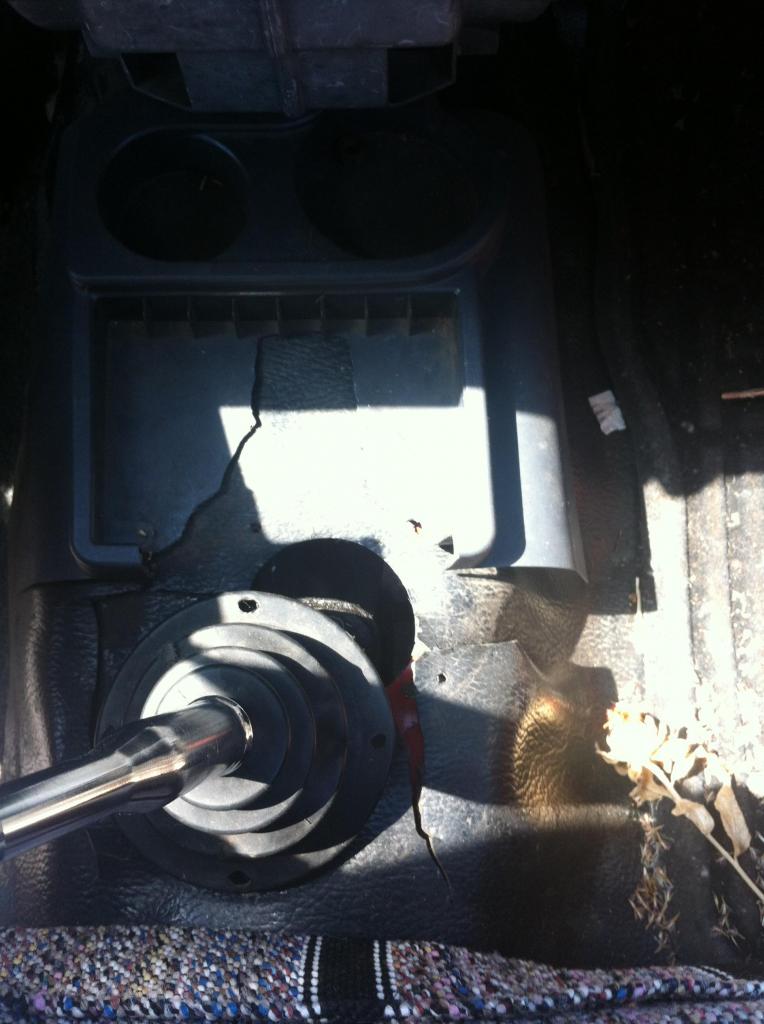

The interior is pretty good for a $500 truck I suppose but there's one thing I noticed that I'm curious about, the shifter. It looks like it's not in the right place. What I mean is there's a perfectly cut circle in the floor board where I'm guessing the shifter is supposed to be but instead a cut was made and now the shifter sits a few inches behind that hole. My only guess is that the truck came with a 4sp and the 5sp that's in it now is a little longer. Sound about right? Here's a pic of that. (sorry, I probably should have pulled the boot back first)

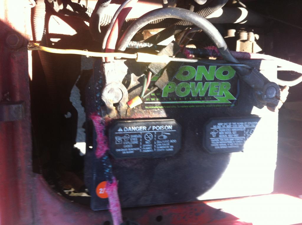

So my only concerns with this truck is the battery area and the fuel delivery problem. And it's also the reason I didn't buy it yet. I'm not sure exactly how to deal with the battery problem and as for the fuel issue, I don't live here so the truck will be parked in the parking lot where I work and I don't think that they would like it much if I dropped my gas tank in their parking lot to change the pump, it is California after all. Oh, and where would I find the fuel pump relay, someone told me I should check that?
So, do you guys think that changing the pump might fix the problem? If so, I think the deciding factor would be if the seller would let me change it in his shop. Also, where's a good place to get a fuel pump if that's what I need?

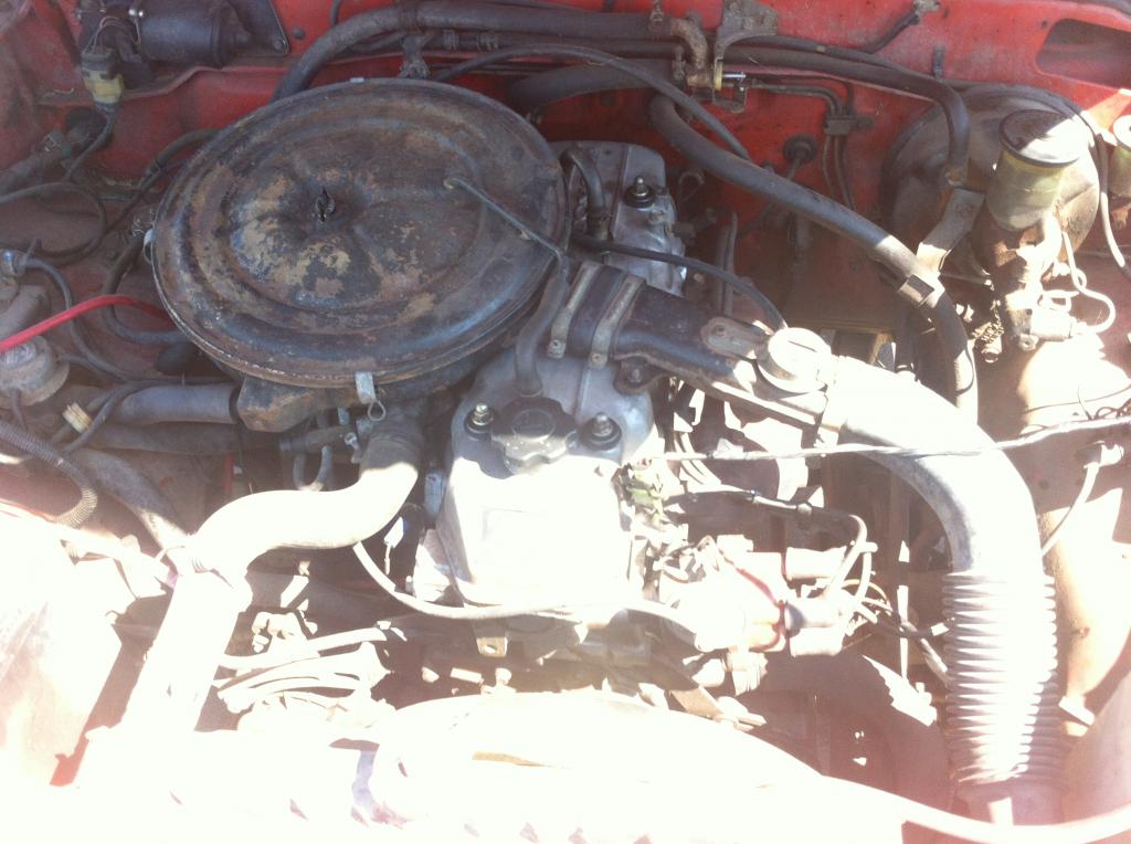

Thanks for looking and for the help/advice so far. Here's a couple more pics of the engine bay, some of the wiring looks a little shady but it works.

I would say the charge light is either going to be your alternator not putting out enough juice to charge the battery. Could be as simple as a bad ground though.
I agree with the others. Shes got potential but theres going to be some time, effort, and a good bit of money that will make her rock solid again. The rust would be #1 with my concerns. Find the rust and stop it for good. Upol or rubberized undercoating for the frame...and make sure you have a good paint job. That will at least keep the thing together while you wrench on the rest of it.
