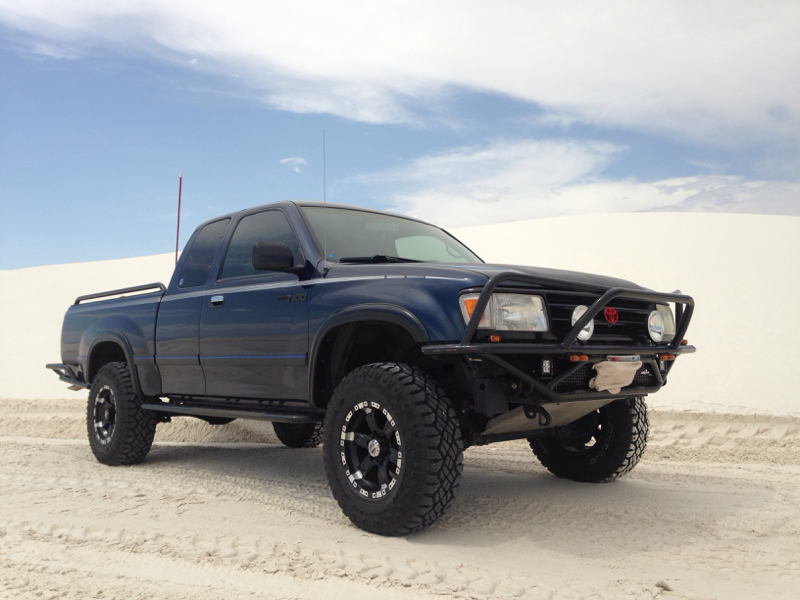

Toytec Ball joint spacers is about the only option unless you do a long travel from Total Chaos. I have the BJS from Toytec and I wish they were half as thick as they are so the suspension travel is not almost maxed out just sitting. Not much droop when the spacers already have it pushed down almost to bump stops. Here is how mine sits. 265/75/16 Duratracs on 16x8.5 wheels with -12 offset to push them out a bit so I don't have to use wheel spacers.

Your supposed to crank the torsion bar down when you installt he spacers, just an FYI if you havent done it yet.

Yes the torsion bars were cranked down after install of spacers. However, it does spread out the factory distance/spacing between upper a-arms and lower a-arms and pushes lowers closer to bump stops or it would not provide any lift. Thus reducing overall travel especially droop. I have considered taking spacers and machining them down and reinstalling to lessen the lift and returning the ifs closer to its original geometry while still providing a small amount of lift.
