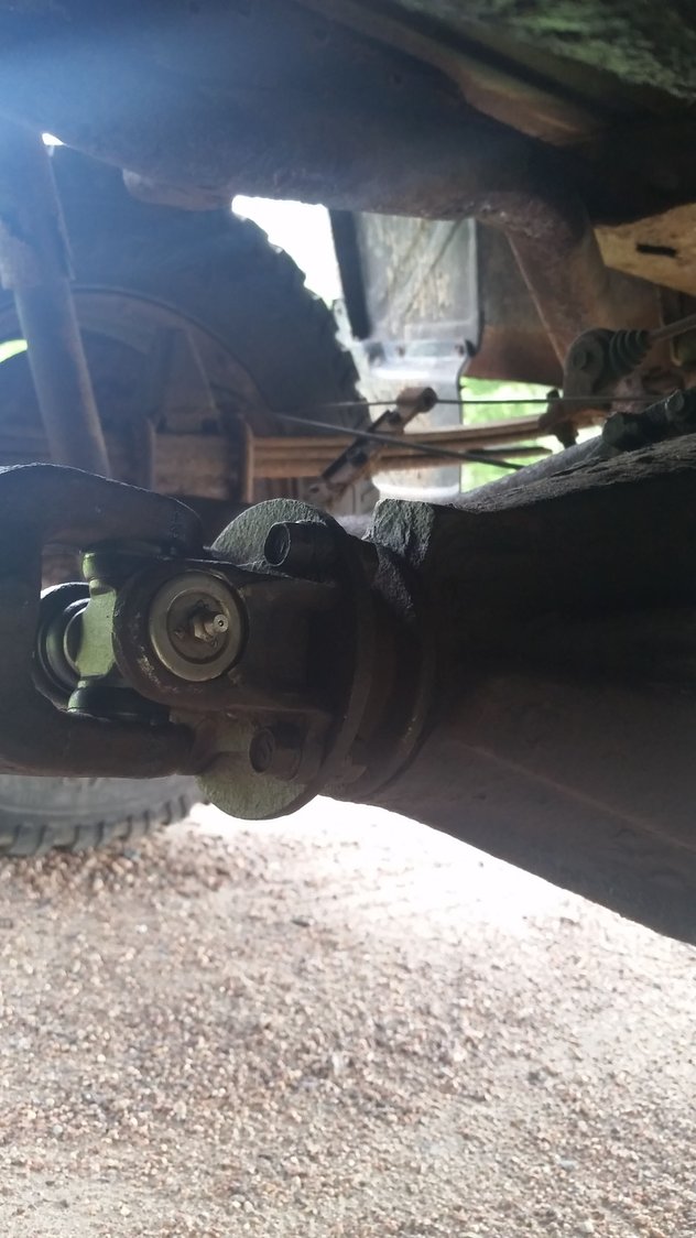

Been getting a strange shudder out of the truck. Feel it more in the seat or under the truck.
Only happens when accelerating after coming out of a curve. Does it for a bit then goes away. Almost feels like a misfire but I don't think it's engine related.
Put 2 u joints in. One at transfer case and one at rear end. Didn't touch the other 2 because of cardan joint. So they are still old. Also replaced carrier bearing and rear seal (was a bit leaky).
The vibration isn't as bad, but it's still there. Only while coming out of a curve with acceleration though.
Had it hooked up to computer got a lean code back.
4x4 works fine.
Tires are only a few years old.
I don't know what else to do. Replace cardan joint? Bad MAF sensor? Bad O2 sensor? Alignment and balance? Rear diff bad?
Anyone have some opinions?

New Carrier Bearing <br ><br >
Originally Posted by GolfVader715
Got a 98 T100
3.4 L
Auto Trans
4x4
4x4 works fine.
New u joint at transfer case<br ><br > New u joint at rear end<br ><br > Old double cardan joint (with old u joints) <br/><br/>How do I know if it's bad?<br ><br >
