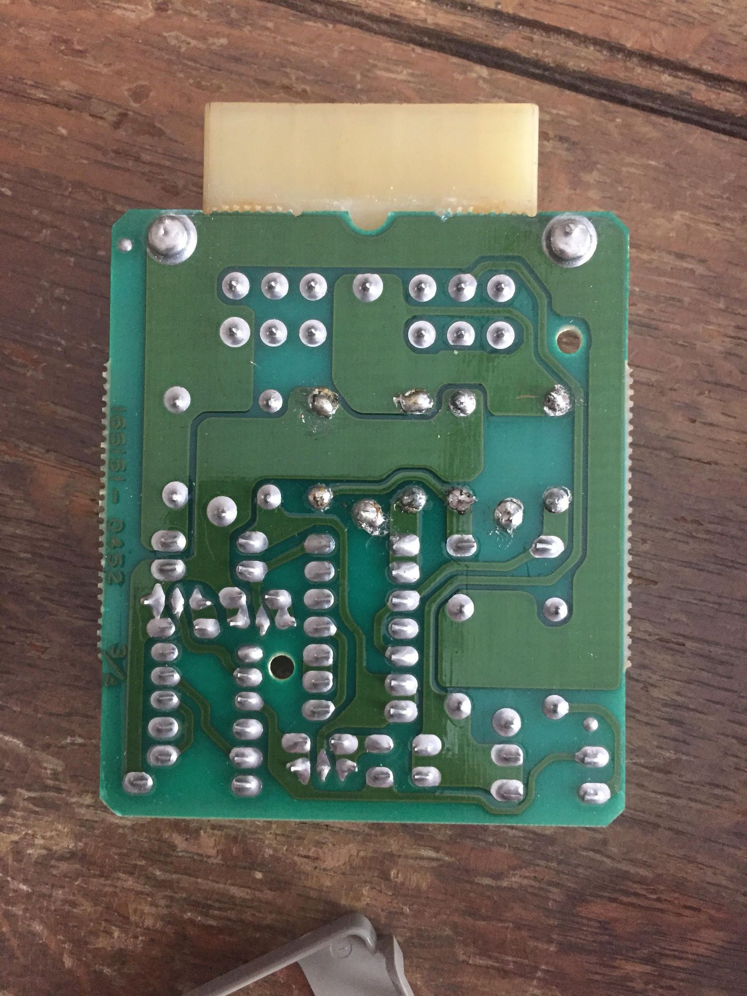

RoBatt 08-15-2015 11:00 AM
Can someone post a picture or edit a picture of what a soldered relay circuit board should look like? Here in mine in hand. What do i need to solder to what?
https://cimg6.ibsrv.net/gimg/www.yot...24e99a950a.jpg
https://cimg0.ibsrv.net/gimg/www.yot...e1b2913252.jpg
4Crawler 08-15-2015 11:07 AM
Didn't have a digital camera when I did mine, but just locate the up and down pins on the connector. On mine, it was pin 5-12 and 4-11 that were connected together and they are right across from each other:
- http://www.4crawler.com/4x4/CheapTri...ow.shtml#Relay
So on your upper photo, two of those pairs of solder pads where the connector attaches get connected together:
So this:
O O
O O
becomes this:
O O
O O
RoBatt 08-15-2015 12:18 PM
Thanks for the response 4crawler. So I figured out what pins are supposed to be soldered together. Instead of going ahead and soldering them i cut a small wire and placed it on the appropriate pins. I pressed the down button and the relay clicked (the key was out of the ignition), but the window did not go down... I know for a fact the motor works. The window will roll up like its supposed to.
What other safety features does bypassing the relay rule out?
4Crawler 08-15-2015 12:28 PM
Should bypass all the interlocks that the rear key switch bypasses:
And if the relay clicks but the motor doesn't run, then dirty/pitted contacts in said relay:
- http://www.4crawler.com/4x4/CheapTri...leshootingTips
- http://www.4crawler.com/4x4/CheapTri...ml#RelayRepair
RoBatt 08-15-2015 12:36 PM
Ok ok. Yeah, but whenever the relay clicked just now, the key wasnt in the ignition. I was holding the wire on the pins with my finger when the relay box was in the 4runner. I pushed the down button simultaneously (in my mind, bypassing the relay temporarily without soldering). When i pressed down the relay clicked (in my mind indicating that both pins were touching with the wire), but the window did not roll down. So im a little puzzled...
RoBatt 08-15-2015 01:03 PM
I figured it out!!!! So whenever I put the relay box back into the 4runner (with the relays exposed) I found out when i move one of the top left relay on my first picture the window rolls down!! The relay moves a little bit so maybe the solder is broken??
What do you think??
4Crawler 08-15-2015 01:03 PM
Relays are electro-mechanical devices. The coil is the electrical part, magnetizes when current it applied and that pulls in the iron or steel contact bar (that is the click). Then the mechanical bit is that bar has one half of the contact on it and that hit the stationary half of the contact. Now if those contacts are not clean or perhaps pitted from electrical arcing, they may touch but not make sufficient electrical contact to operate the motor. So clicking means the relay coil is not burned out and is getting current flowing through it. But motor not running may mean the relay contacts are shot in the pair of down relays. Since the up relays work, that says wiring to the motor is OK as there is just one pair of wires to the motor and the relays reverse polarity on those two wires.
Might also check the obvious things:
- http://www.4crawler.com/4x4/CheapTri...CommonProblems
4Crawler 08-15-2015 01:05 PM
If the current can't flow from the relay to the motor, then the motor won't work. Try re-soldering all the relay connections and see if that helps.
RoBatt 08-15-2015 01:05 PM
4crawler see my last post!
