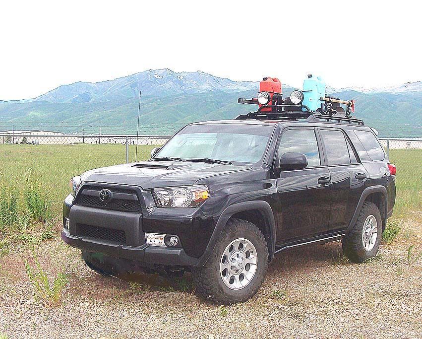

Co_94_PU Feb 25, 2018 10:19 PM
Originally Posted by rs87a (Post 52391853)
I was planning on splicing the two power wires for the lights together into a Y and then run just one wire to the relay. That one wire will have to be about 8 feet long from where the lights will connect. I checked this site, https://www.wirebarn.com/Wire-Calculator-_ep_41.html, and it says I'll need 8 gauge wire! Yikes... I'm still trying to figure a clever way to route the power and ground from the lights.
My lights are set up in this same way, just behind the sunroof.
https://cimg9.ibsrv.net/gimg/www.yot...fae741d38a.jpg
