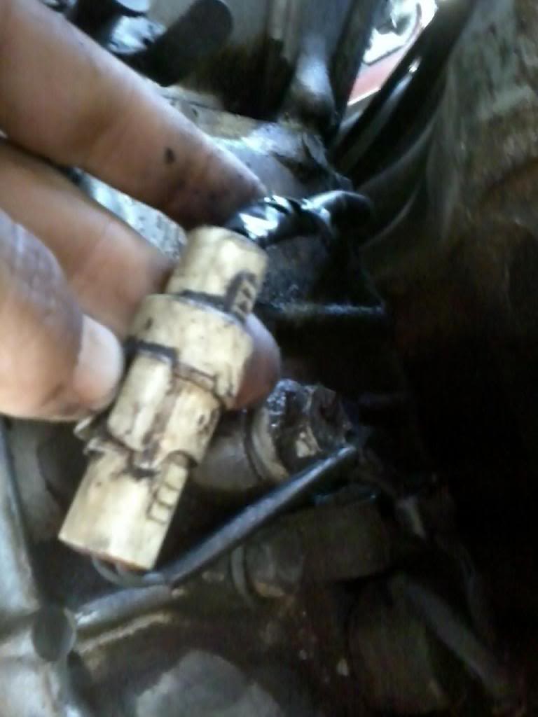

You have other issues as well? Her is how I fixed mine. Several things on that circuit. Look at the plug below and see if it is knicked and shorting on the tranny. Haynes Manual page 12-11 shows what all is on this circuit.

FIXED!!! Mine was the Reverse Lights on the Tranny. It has a protective sleeve and depending on how the sleeve slides, it can cover the wires where they rub against the tranny leaving them exposed. Below is other fixes for this problem.
