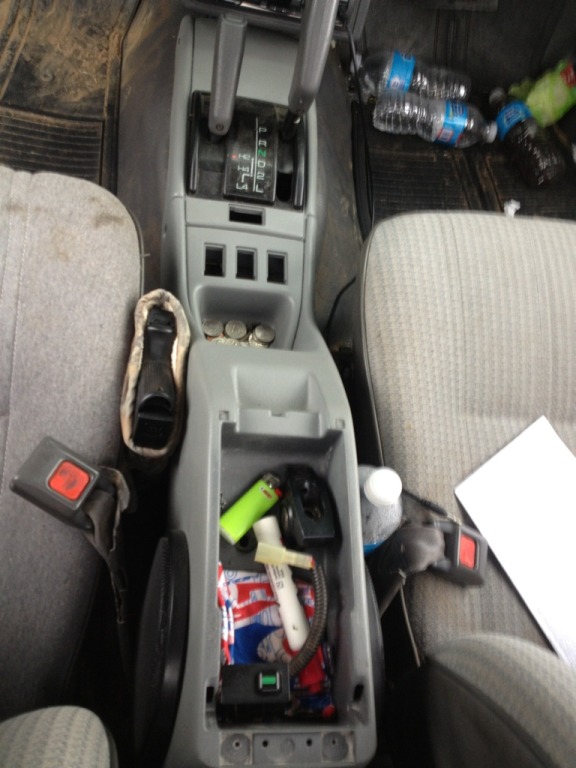

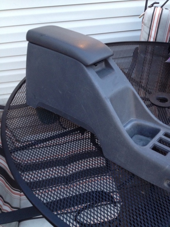

So, I bought a console from fellow YT member Dakotawho for my 88 Xtra cab to replace the horrible autozone junk that came when I bought it. Here is what I started with.
Attachment 163962

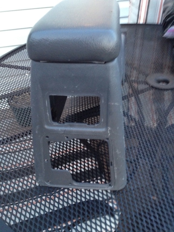

I decided I wanted to something more than just install it so, I figured first I would remove the ashtray and heat switch I wouldn't need in the Xtra cab. Then I found some 6.5 Kenwoods a buddy had and started cutting.
Attachment 163963
I had to cut out what seemed to be plastic rivets holding the heat control...pretty simple. The ashtray pulled right out.

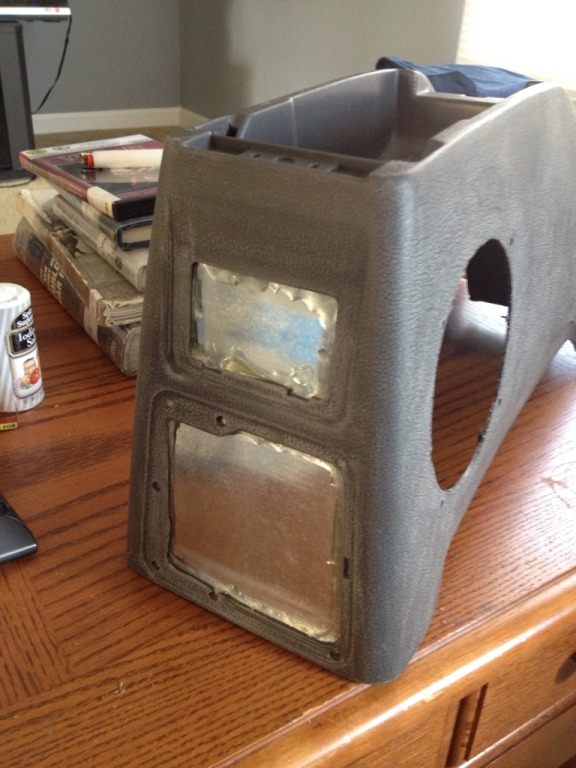

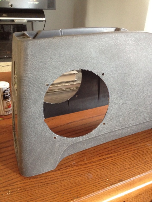

Next, I cut some sheet metal and used 2 part epoxy to attach it from the backside. This will be covered with fiber glassed and bondo.
Attachment 163964
Attachment 163965
I started the fiber glass last night and will post more pics as I get this project finished up if there is any interest. This is just a simple thing I figured I would share with you guys. Thanks.

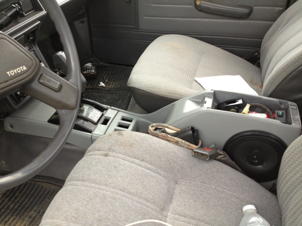

So I wanted to finish up this thread. I installed the console and a new radio over the weekend. Still gotta anchor in the back but, I gotta take it back out to put in the new shifter bushings in.
This is the back after fiberglass and bondo. And paint.
Attachment 162444
This is the install
Attachment 162445

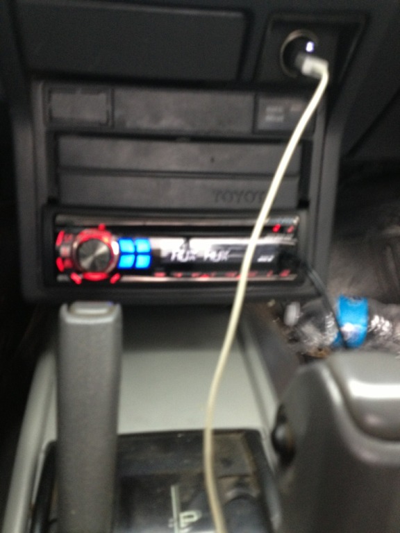

It sounds pretty good.
Here is the radio.
Attachment 162442
And one more.
Attachment 162443
