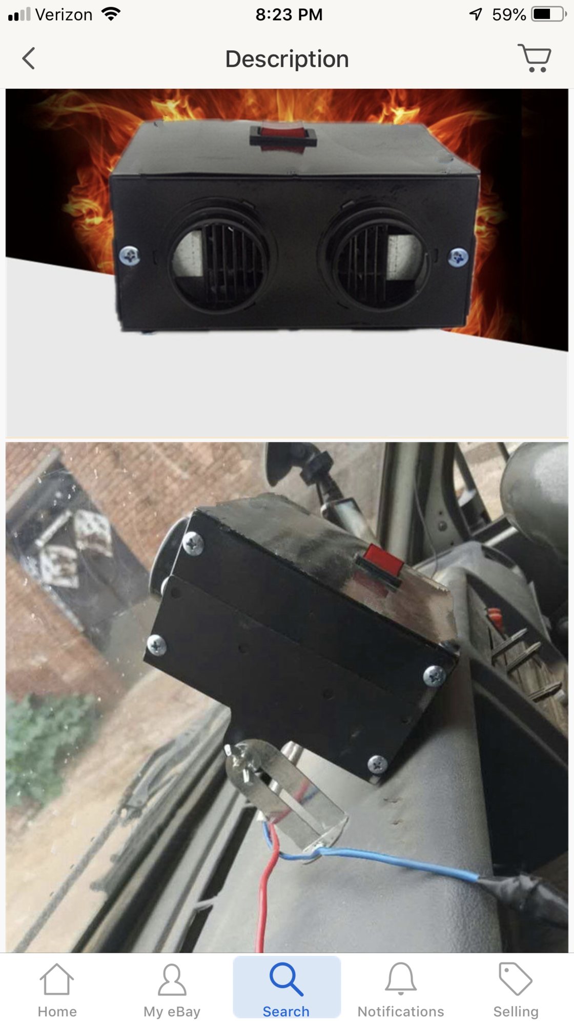

Truck doesnt have AC, dont have time to fix the oe in the dash at this time, and I need the truck. Hence, why im looking at the cheap ones on ebay. I am interested in figuring it out and fixing it right eventually, the lever that swithces defrost/floor/vents is broken and the entire faceplate needs replaced. As I recalled, I tried to find an entire replacement a couple of years ago when I got the truck and they either weren’t available or were very expensive.
I tried to add a screenshot of the eBay defrosters but couldn’t. They are cheaper 12 to 15 bucks .

Received 0 Likes on 0 Posts

I had one similar to the $15.59 one above. It wasn’t good for much. When you figure a typical hair dryer is 1875 Watts and this is 150 watts you can see why.
