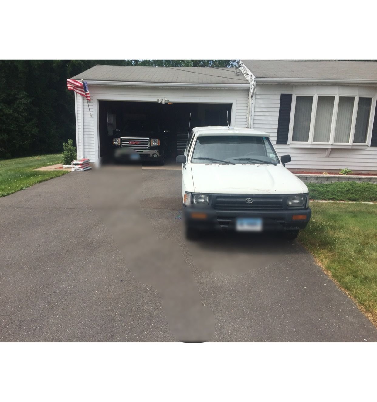

94 pickup getting delivered
Hey guys not sure how to use this platform all that well yet, but I picked up a 94 pickup r22e from my company, long story short they didn't know in Ct they don't need a title to sell a vechile if it's over 20 yrs old etc. so it's got 52k clean as all can be frame wise but all I have gotten done is drained the gas (sitting for 7 yrs) and put a battery in it, cranks has spark...where should I start. And I'm like most ppl two jobs etc. not much time would really appreciate some advice from folks who have been in my shoes. And it's a fleet pickup, just to give a visual. White super plain Jane.

Yea with 52k what?? We need more pics of this please!!!!
Oh, what did the gas look like?

Oh btw gas looked pretty bad yellow the usual crap. Had more then I thought also, spilled a little haha. I just don't know where to start, I. I can't hear the fuel pump cause of the darn buzzing and should I start with the fuel filter? I'll take any advice and the mileage is a little higher then I previously said but u get the point lol still really low.
Emissions slip is from 08. they stopped driving it in 09 ish time. Guys said they barely drove it, even before they let it sit. Seems legit from what I see, it's just as clean inside and the frame as I said before.

Pic

Awwww man that’s incredible!!!!
Fuel filter is a good start, this thread has a good post on testing the fuel pump, https://www.yotatech.com/forums/f116...l-pump-248683/

many thanks man, really appreciate it! Awesome link btw. Can't wait to get it on the road. It's an awesome little truck. Really wanna get some use out of it. Maybe a nicer pair of wheels and a better cleaning. Had the power wash it when I get it lol pretty bad! But thanks again!

Nice score!
You may find several small repairs need to be done, just from sitting for so long.
I am actually a fan of those steel wheels. It makes the truck look utilitarian.
Good luck! I am glad you saved this Truck!

You have 54k on that gem, leave the wheels it makes it that much better, if I saw you at a gas station I would need to look at it, old guys will love it, chicks will love you helping them move things (or your lady) , that right there is class, unique and original

Great looking little truck you found. I too like the steel wheels. There is a chrome ring and a black center cap that goes on the rims that I think make the wheels look even better.
