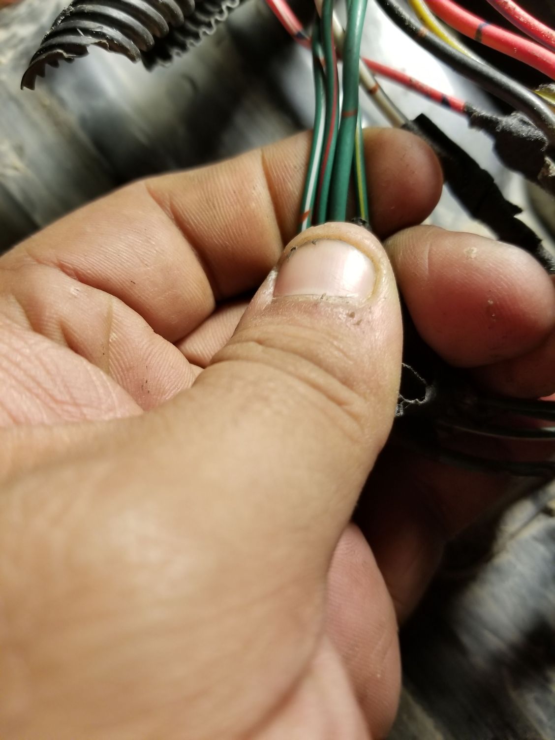

https://cimg4.ibsrv.net/gimg/www.yot...3927f17e5f.jpgThis is what the green wires on 1995 harness look. Left to right. green-red, green with red marking, green-yellow, green With red marking, and green-white
https://cimg0.ibsrv.net/gimg/www.yot...d763ff16b1.jpgRest of cables all had matching wires. (1995)
https://cimg2.ibsrv.net/gimg/www.yot...76dcbc7618.jpgI removed the extra green woth re markings amd lights dont come on when i go up on the tailgate.
https://cimg2.ibsrv.net/gimg/www.yot...c211219e89.jpgWhat the 1991 green wires look
Left to right. Green-white, green-red, green with red markings, and green-yellow.

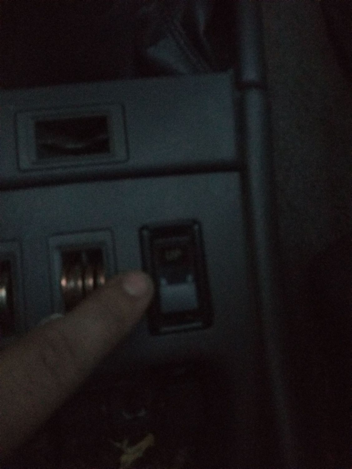

https://cimg6.ibsrv.net/gimg/www.yot...c267f260fc.jpgThe switch that turns them on🤣😂
