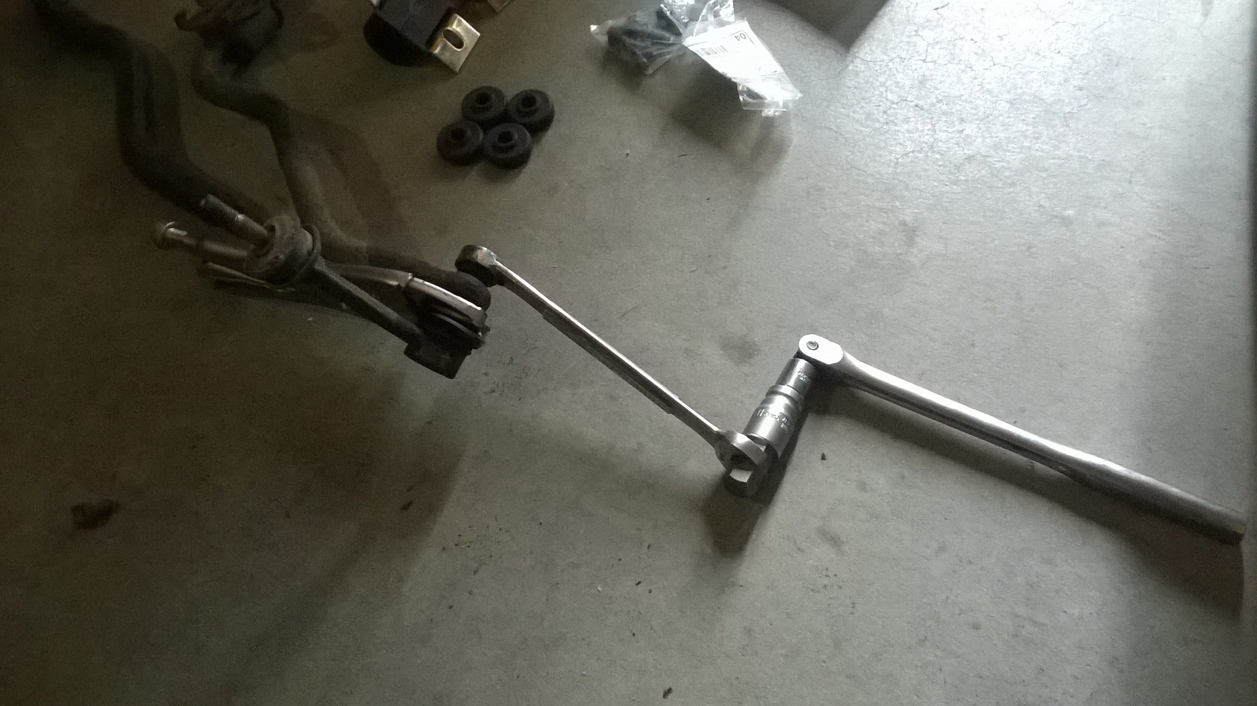

This is the combination I came up with to torque a variety of fasteners in tight spaces. I used this successfully on the fan clutch pulley nuts. Ignore the sway bar in the photo.
