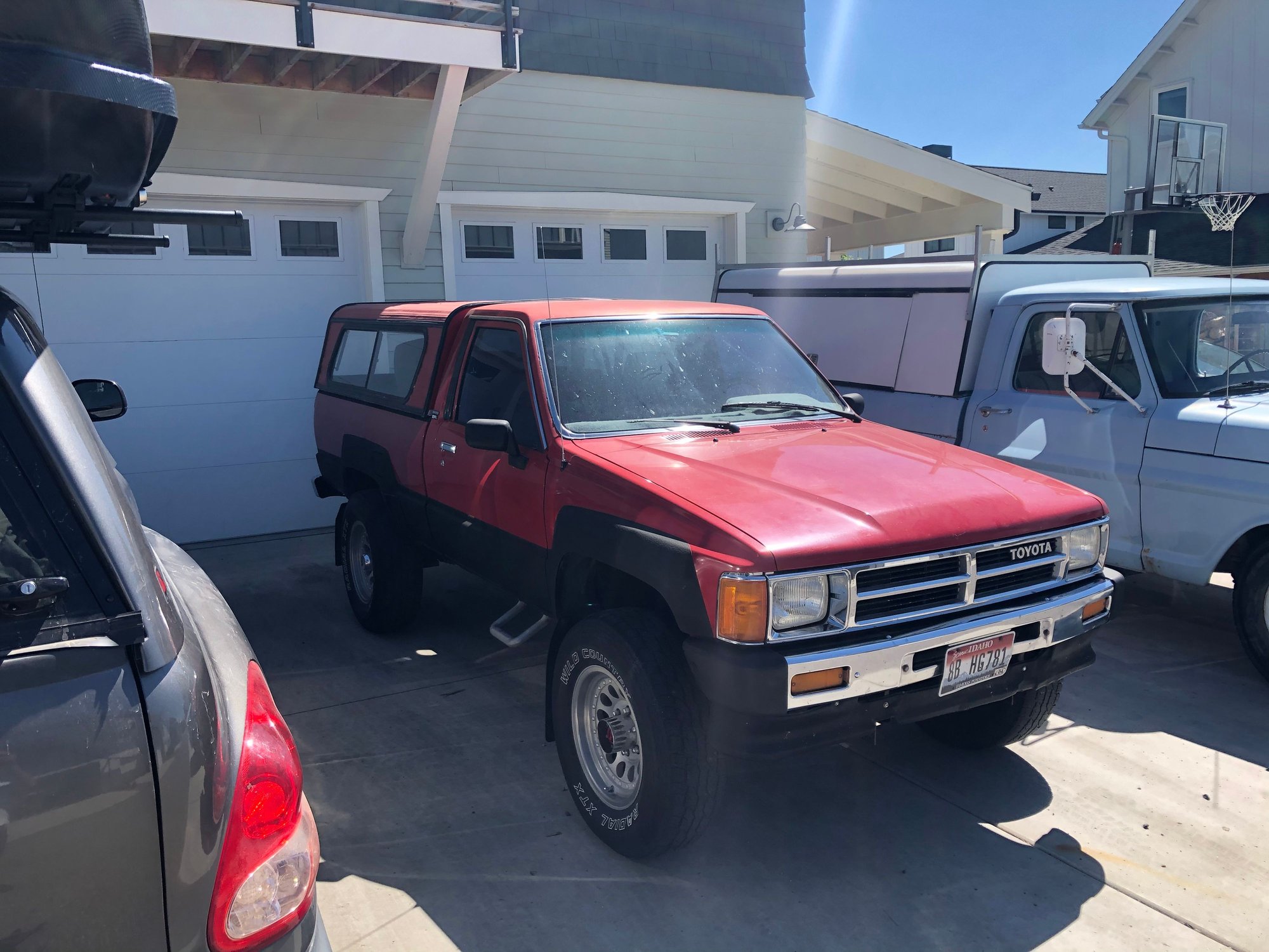

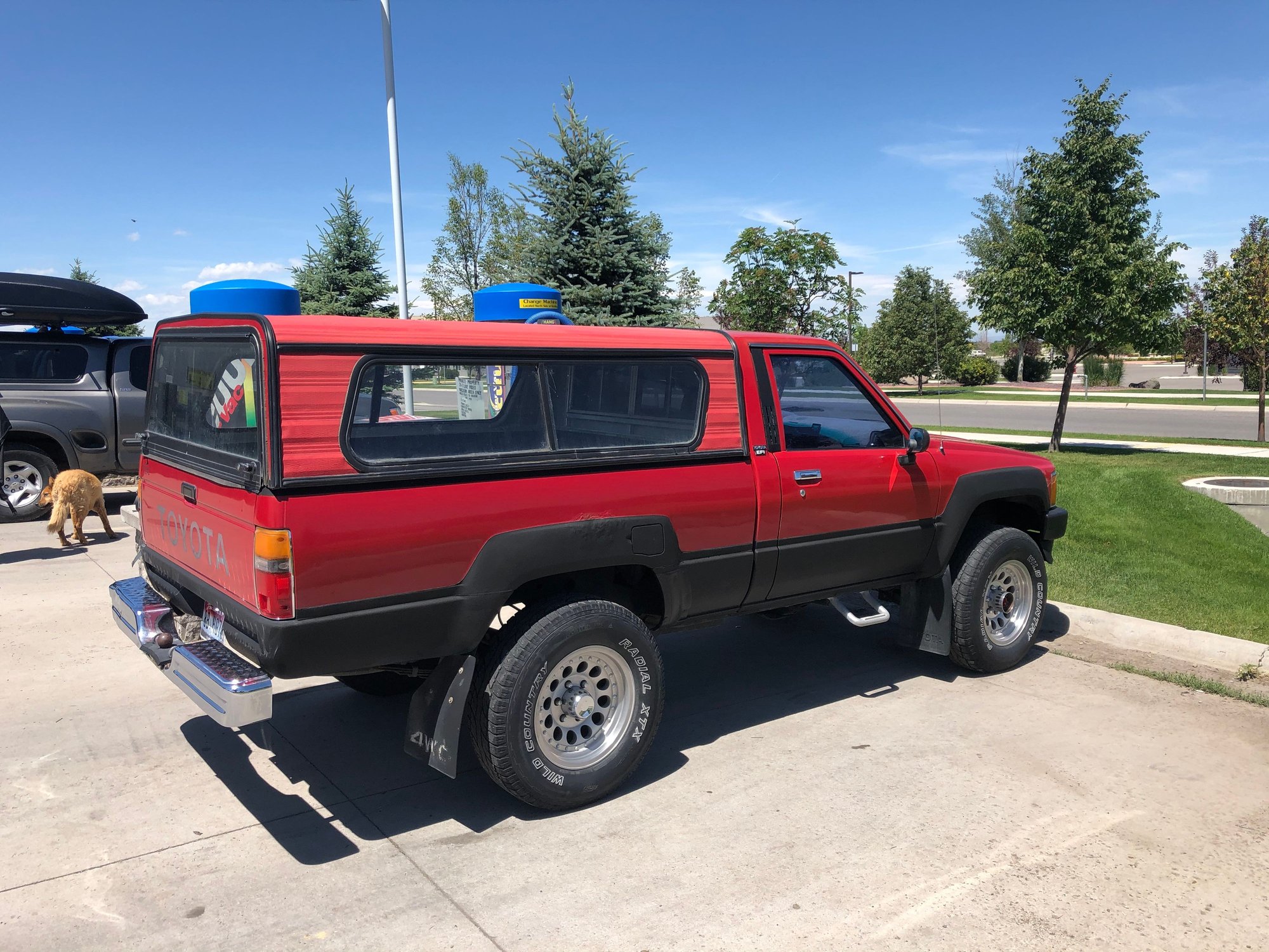

I am new to YotaTech and the older Toyota trucks as well. I just picked up a clean 88 4x4 Pickup 22re with 148k on it. Everything seems to have been pretty well taken care of. It does seem to have a small oil leak. When I first got it this past weekend 7/11, after being parked over night there was a little drip of oil coming off of the skid plate. The timing cover was super gunked up and caked with grease and oil so I pressure washed and scrubbed it all off to see if I can find the leak. Today I did an oil change, I used Castrol GTX 10w-30, and when I opened the drain plug on the oil pan there was just a slight trickle of oil coming out. Before I did the oil change the oil level was fine. So after about 20 minutes of slow trickle I pushed a screw driver into where it was draining and the oil poured out fast like it should. So this leads me to believe there’s something down in the oil pan. Now I have read about the plastic timing chain guides breaking and falling down there but I don’t here any sign of chain slap?? My engine seems to be running pretty well, the only thing I can here as far as “ticking” is from the intake and I feel like that’s just the injectors, maybe it needs a small valve adjustment? If anyone has any ideas on this that would help a lot. I’m not much of a mechanic but really want to learn as I start working in this truck and getting it to be a solid runner. I forgot to mention I drove it home 200 miles after I bought it, no issues and it has a brand new radiator.

Nice truck! Looks mostly original. More than likely it is a piece of timing chain guide in the oil pan. Sometimes broken guide symptoms are subtle, especially if the guide is not completely broken yet. It is easy to check the guides while the valve cover is off, and a you can adjust the valves at the same time. If you get one of those flexible grabber tools, you might be able to fish it out from up top if you are doing the timing chain with the cover removed. An inspection camera might also help if you do not want to drop the pan, but I do think dropping the pan and cleaning it is best.
