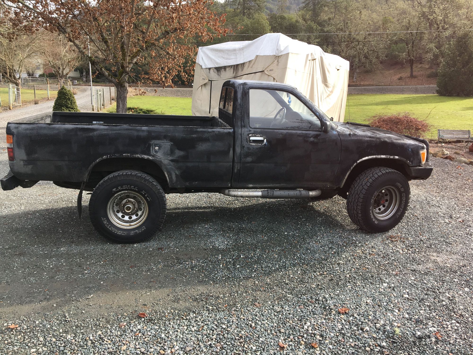

Jaredyfz450 Feb 1, 2017 01:25 PM
No 4x4 3rd gen long bed
https://cimg5.ibsrv.net/gimg/www.yot...5119a332ba.jpg
Originally Posted by thefallman (Post 51414623)
no such thing as 4x4 long bed 3rd gen pickup as far as i know. I've never seen one.
I just bought my first Toyota a few days ago and it's a single cab long bed 4wd with a 3.4 swap it. I would have to measure but the title says LWD whatever that means. I was wanting to get rid of the single long and do extended short. Also to get rid of the crappy rhino lining they did
wyoming9 Feb 1, 2017 02:40 PM
10 year old thread I have not seen any of those people around for quite some time
You have your work cut out
