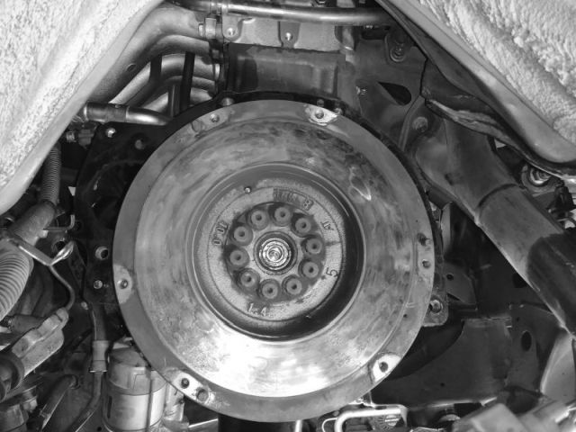

I never did a clutch before and I just removed the transmission but I don't know if the flywheel needs to be machined or replaced.
What do I look for?

Take the FW to a machine shop first to see what they measure it at and if it can be surfaced. They will want to know what vehicle it is too.

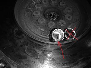

As the others have said, a good machine shop will tell you if it can be resurfaced (it needs it judging by the pictures) as long as you don't keep your year/make/model a secret.

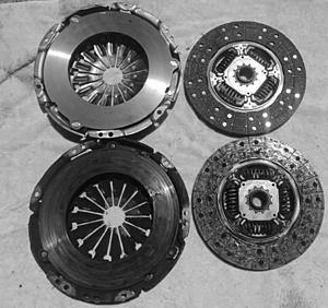

A flywheel should always be machined or replaced when installing a new clutch set. Most clutch warranties won't even be honored if a new flywheel wasn't bought on the same receipt or if there isn't proof of it getting machined. As long as it doesn't have any obvious damage like large cracks or chips in it and the ring gear is in good shape, then it can usually be machined. Typical machining cost usually go around $50 depending on shop. It looks like you have either a 2rz or 3rz truck. Rock auto has new flywheels ranging $45-$81. All of which will be fine for a stock clutch set. Of course shopping locally will likely cost significantly more. The cheapest one on Rock Auto is a brute power for $45. My local Autozone sells the exact same one for $75. If local is where your shopping then that could be your deciding factor.
As for the pilot bearing. Replace it. Don't bother trying to reuse the old one. Its a sure fire way to find yourself doing the job again and possibly ruining the transmission in the process. Your clutch set should have one. I find they usually come using grease sparingly. I like to clean them out real good and repack with a good grease. Also, grease the nose cone where the throw out bearing rides and also grease the splines on the shaft. Many people don't causing the clutch disk to wear into the splines which eventually makes clatter and ruins the transmission input shaft. Use a new throw out bearing too. Again, your clutch set should come with one. Many of the cheaper sets I have had terrible luck with the throw out bearings failing only a few miles in. Almost every one of them. I usually buy a new one separate from National or LUK. They can usually be found online for a good price. It might cost a little extra but its good assurance. I've redone about 8 clutch jobs from using the bearings that come with the cheaper clutch sets. Usually from the cheaper part store sets. Napa branded clutch sets are good. They're just re branded LUK sets. If that's what you have then send it.
