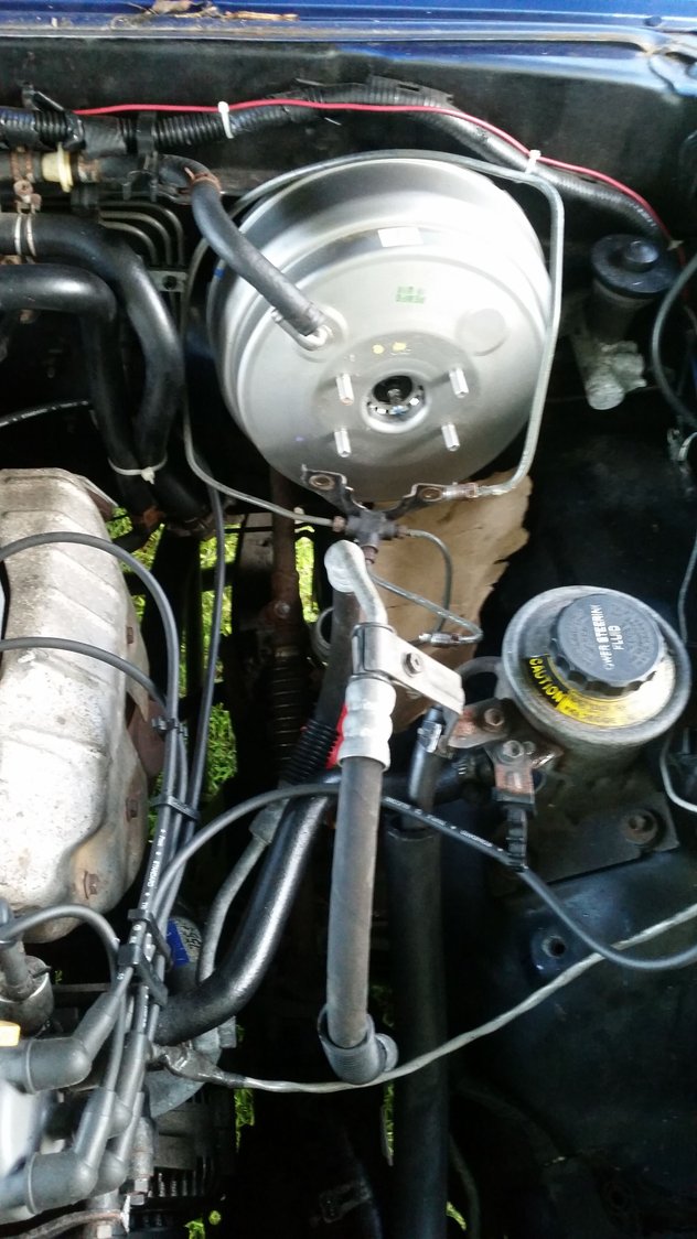

These pics don't tell much but hell, it's progress.
Old booster
Replacement
Old booster
Replacement
