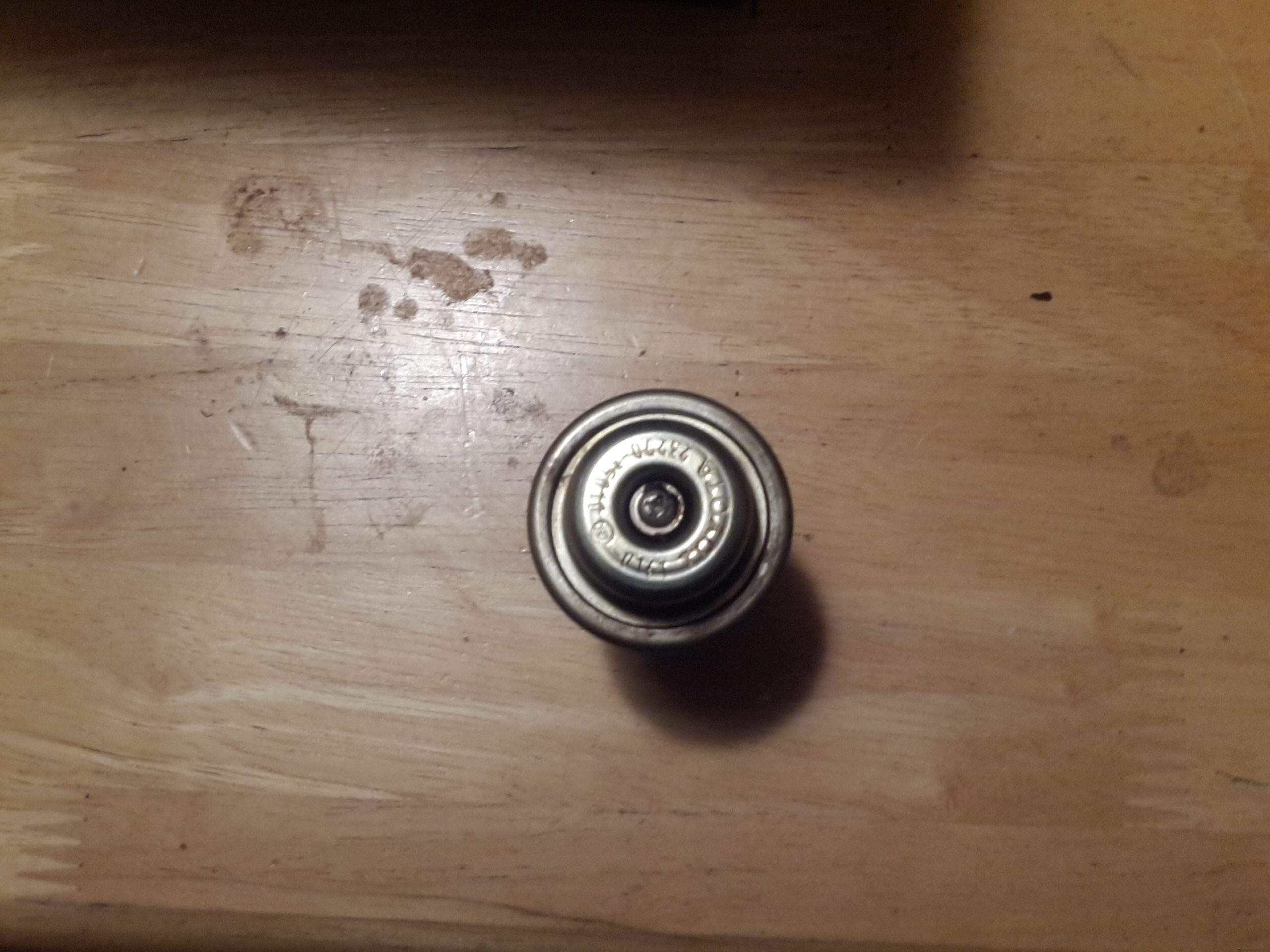

So I finally got everything within .1 volt of the bat on the injectors. I went ahead and took off the plenum, fuel rail and injectors, all look great, screens inside of injectors are good, fuel rail clean and flowing fine. Then when i took off the fuel pressure regulator on the rail, I found that that behind the plastic cap, there was a loose screw. The screw that screws inside the center of ur regulator. it was completely out. Would this be my problem seeing as I have narrowed it down and worked out each issue one at a time? This isnt a vacuum operated regulator so I'm unsure of what that screw does. I will try to attach a pic but my tablet is my only camera right now. The pic is below, but i found out its the pulsation damper, that screw in the pic was all the way out.
Last edited by randu2020; 12-09-2013 at 08:12 PM. Reason: error in item description
This is the regulator on the end of ur fuel rail under the plenum, that screw as gone and just floating around in the plastic cap
would it cause issues if that screw was completely out? That is how i found out when i took the cap off. ,
Just did some more searching and mudhippy answered this for another guy.
(It's not uncommon for the screw to fall out, and be left sitting in the plastic cover. This has ABSOLUTELY no effect on the functionality of the damper. If that's the case, all you need to do is screw it back in untill it bottoms out. Or don't. Like I said, it's only purpose is so that it's easier to check for fuel pressure when it's there. Mudhippy)
